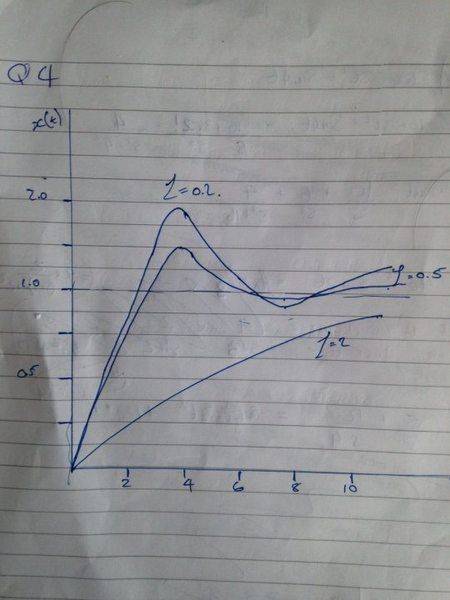

Hi Gneill. please can you take a look at my sketch and let me know if i am anywhere near?
Thanks
  • #36
Thanks
Take a look at the set of normalized curves presented on the wikipedia page: RLC Circuit
