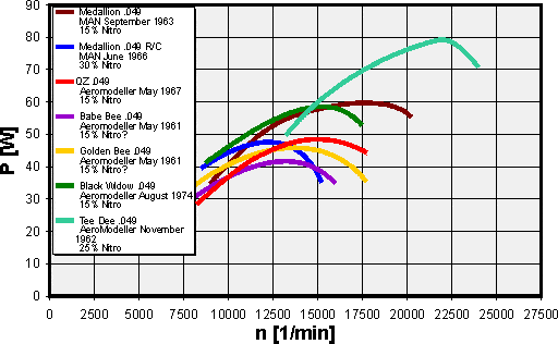

I don't know how small you mean for a "small" RC engine, but I'd be surprised if there were any out there that would put out less than what you get from a 1500mAh NiCd pack in 10 minutes or so (typical for an rc car).
The numbers you gave equate to 10.8 w-h or 64.8 watts for 10 min.
Gas (nitromethane) rc engines don't get much smaller than 1/4 horsepower, which is 186 watts. And that's output, whereas the battery is input power.
http://www.mountaintrains.com/rc_engines.php
I don't know what the HP rating for one would be, but Cox's old .049 has to be less than a 1/4 HP. I'll have to do some looking around.
EDIT: I actually found a set of power curves for the .049s. They maxed out at about 60 W:
