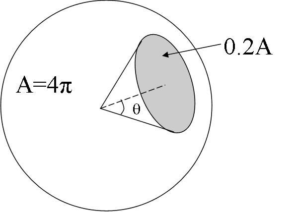

This should be a simple question, but I haven't found a clear explanation anywhere yet.
Suppose that there are a bunch of particles in a gas, with their velocities "uniformly distributed over solid angles", and I want to find out what fraction of particles are traveling with velocities in a certain angular range.
Conceptually, I know what this means. I'm just not sure how to do it - I drew a diagram.
Suppose the shaded area represents 20% of the sphere's total surface area. How do find the angle theta?

hi quarky2001! :smile:
(have a theta: θ :wink:)
that's called a cap of a sphere of radius θ …
i can't remember the formula for its area :redface:, but it's fairly easy to find by integration :wink:
