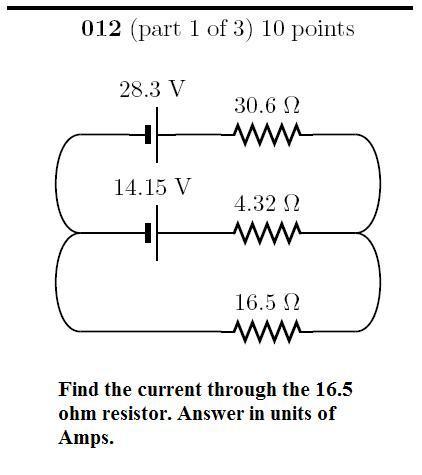

pantera1441
anyone help me out with this probelem?
What you want to do is to attack this problem by using nodal equations, as you can see from the drawing this circuit has only one node placed in the junction between the three resistors, you can start by assuming the following:
1. By KCL the current at the node is equal to 0
Since we don't know anything about the direction of the currents, we can safely let the node voltage determine the direction.
2. Let the [tex]V_{x}[/tex] denote the node voltage
Let [tex]I_{1}[/tex] denote the current from 28.3 V source
Let [tex]I_{2}[/tex] denote the current from 14.15 V source
Let [tex]I_{3}[/tex] denote the current in the 16.5Ohm resistance
3. Applying the nodal equations we get the following:
[tex]I_{1}+I_{2}+I_{3}=0[/tex]
Note that the current can take any direction. Now we replace currents with voltage drops divided by resistor values:
[tex]\frac{V_{x}-28.3}{30.6}+\frac{V_{x}-14.15}{4.32}+\frac{V_{x}}{16.5}=0[/tex]
Solving for [tex]V_{x}[/tex] we get 12.9
Now we can solve for the current in the leftmost resistor:
[tex]I_{3}=\frac{V_{x}}{16.5}=0.784A[/tex]
DONE!

pantera1441 said:
thanks a lot for the help...
much obliged!
No problem, I hope you understood the steps towards the solution.
Yeah, you use KCL bc all the current is conserved, and you find the actual current that enters the bottom resistor, after that you can find the current across any of the resistors, using the way you set it up
In the future, it is better to not just do the problem for the OP but to give little hints to push him/her in the right direction...
Correct and remember if the batteries were switched the other way around, then you would use [tex]V_{x}+V_{battery}[/tex] instead
I won't argue about that, but i thought that making the complete description of the steps including the description of what rules i applied would help him better, so he/she will know what to do next time he/she is faced with the problem.
