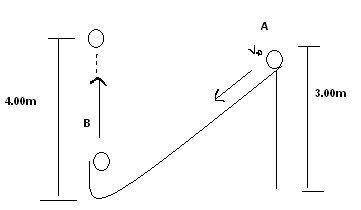

Here's the other one...
Q:A particle, starting from point A in the darwing, is projected down the curved runway. upon leaving the runway at point B, the partticle is traveling straight upward reaches a height of 4.00m above the floor before falling back down. ignoring firction and air resistance, find the speed of the particle at point A.
I've attached a crude paint drawing.
Ok my work:
Wnc (non conservative work) = 0
Ef=Eo
1/2mv^2 + mgh= 1/2mVo^2+mgh
Since kinetic and potential must be constant then I can cancel some terms
so mgh=1/2mVo^2
Vo=square root(2*9.81*(4m-3m))
Vo= 4.43m/s
Sounds too simple if you ask me.
Somethings in err, comments?
Thanks all.

Both problems look like they have been solved correctly. Good job.
