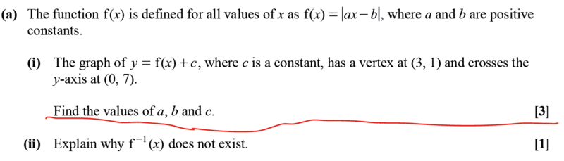

Kindly see attached.
Understanding of functions
A bit confusing here; what i did,
Using gradient, we have,
##m=\dfrac{7-1}{0-3}=-2##
##y=-2x+7##
Since there is a Vertex, we have the other ##m_2=2##
thus,
##y=mx+c##
##1=2×3 +c##
##... y=2x-5##
##a=2, b=-5, c=12## or##a=-2, b=5, c=2##
It says ##a## and ##b## are positive, which excludes both your solutions. I don't understand your working, in any case.
What can you say about the vertex of this graph?
Likes MatinSAR and chwala
Perhaps you could draw a graph of the function for some arbitrary positive values of a and b. Then see what 'vertex' and 'crosses y-axis at ... ' mean.
I will check this later...

I did that; looks like i am missing something here;
I have
If ##-ax+b+c=-2x+7##
then i know that ##a=2##
Now since the vertex is at ##(3,1)## then ##\dfrac{b}{a}=3##
##\dfrac{b}{2}=3##
##b=6, c=1## using ##f(x)=2x-5## as my line of reference..

chwala said:
This is my latest result on the post...sorry for the confusion @Mark44 .... such questions can be a bit crazy! :biggrin:
I see now that you had the correct values of b = 6, c = 1 in an earlier post that I missed. Since the original question asked for the parameters a, b, and c in the equation y = |ax - b| + c, you should not have used b and c with different values in a different equation.
I have
##\dfrac{b}{2}=3##
This is almost correct.
Yes, the correct values are what you have ; ##a=2,\,b=6,\, \text{and } c=1##.
However, nowhere is ##f(x)=2x-5## a reference line.
##f(x)=|\,2x-6\,|##, so that for ##x<=3## we have ##f(x)=-2x+6## and for ##x>=3## we have ##f(x)=2x-6##
Perhaps you are thinking of ##y=f(x)+c##.
It is true that for ##x>=3## we have that ##y=f(x)+c=2x-6+1=2x-5## .
More briefly, it's ##y=2x-5##

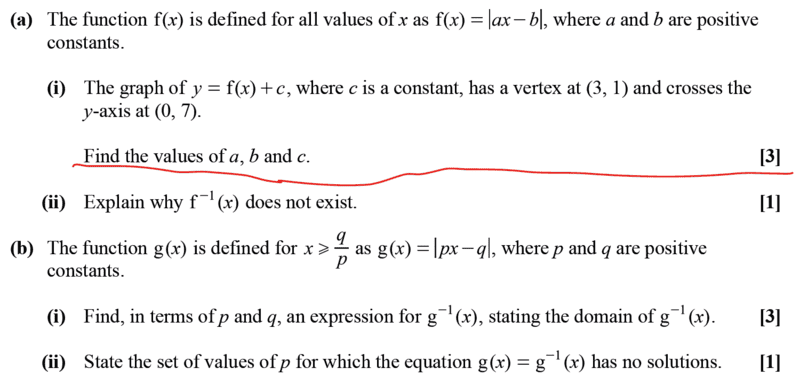

Allow me to post the continuation of the question here; part (b)
Part (b) (i)
Let
##y=g(x)##
##y=px-q##
##px=y+q##
##x=\dfrac {y+q}{p}##
##g^{-1}( x)= \left[\dfrac {x+q}{p}\right]##
The domain of ##g^{-1}( x)## is ##x≥0##
I need help on part b.ii
I have,
##px-q=\left[\dfrac {x+q}{p}\right]##
##p^2x-pq=x+q##
##x=\dfrac{q(p+1)}{(p+1)(p-1)}##
##x=\dfrac{q}{p-1}##
##p≠1##
just making a correction here:The domain of ##g^{-1}( x)## is ##x≥1##
No. Not correct. You are ignoring an essential relationship between the domain and range for each of a function and its inverse
in addition to that:
To help anyone reading this thread, you likely should have pointed out that you are now addressing part (b) of the exercise. Also, part (b) was not included in the OP, but was given in an attachment in post #7, the post you quote regarding your "correction". Here I re-post that attachment:
In part (b) we have a function, ##g(x)##, which is closely related to ##f(x)## found in part (a).
##g(x)## is defined as ##\displaystyle g(x)=\left| px-q\right|##, where constants ##p## and ##q## are positive. Also, ##g(x)## is defined only for ##x\ge\dfrac q p##.
What significance does ##x\ge\dfrac q p## have besides defining the domain of ##g(x)## ?

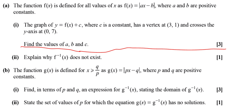

Let me analyze this again, the Modulus is/was a bit confusing,
Now if we have,
##g(x)=|px-q|## then the domain of ##g(x)## will be ##x∈\mathbb{R}## and the range will be ##g(x)≥0##
Now it follows that the domain of ##g^{-1}(x)## will be ##x≥0## and the range will be ##g^{-1}(x)∈\mathbb{R}##
Now if we have,
It is explicitly stated that the function, ##g##, is defined for ##x\ge\dfrac q p## . This implies that the domain of function ##g## is the interval ##\displaystyle \left[\dfrac q p,\, \infty \right) ## .
##p## is positive so ##x\in \left[\dfrac q p,\, \infty \right) ## implies that ##px-q\ge0##.
However, if ##px-q\ge0##, then we can drop the absolute value notation from the definition of function, ##g##.
