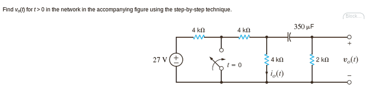

How Does K1 Being Zero Affect the First Order Circuit Solution?
The discussion centers on analyzing a first-order circuit with K1 set to zero, leading to the voltage equation V(x) = K2e^(-t/z). The voltage across the capacitor at t=0- is calculated as 9V, while at t=0+, it is determined to be -3V, establishing K2 as -3. The Thevenin resistance is found to be 4k ohms, resulting in a time constant z of 1.4. Participants clarify that no current flows through the 2kΩ resistor once the capacitor is charged, simplifying the circuit analysis.

We are given K1 = 0. So the answer should be in the form of V(x) = K2e^(-t/z)
V=IR
V(x) = K1 + K2e^(-t/z)
V(infinity) = K1
V(0+) = K1 + K2
z = RC
I draw the circuit for t = 0- and find the voltage across the capacitor. Vc(0-) = 27/12*4 = 9V
Now I draw the circuit for t = 0+ with the capacitor as a voltage source. I apply KVL to get the following:
4i1 = 27
i2 = 0
-9 + 2i3 + 4i3 = 0
Vo(0+) = -3V
We know K1 = 0, so I don't draw the circuit for Vo(infinity)
V(0+) = -3 = K2
z = RC.
Now I get the thevenin resistance across the capacitor; ignoring the short circuit I have: ( 1/(1/4+1/4)+2)=4k ohm
So z = 4000 * 350 * 10^-6 = 1.4
But my answer is wrong: V(t) = -3e^(-t/1.4)

Where does current, i3 flow?For t<0, no current flows through the capacitor, so no current flows through the 2kΩ resistor. That also means that for t < 0, you have the wrong voltage across the capacitor .

No current flows through the 2 kΩ resistor once the capacitor is charged. That puts the right end of the capacitor at 0 V (assuming we take the bottom rail as the 0 V reference). The voltage at the left end of the capacitor is determined by the resistor voltage divider and the voltage source. 9 V looks good for that.
@ x86, I think you're over complicating things by writing multiple loop equations. Once the switch closes the 27 V source and its attached 4 k resistor are effectively isolated by the switch short and become irrelevant to what's happening on the other side of the switch. You can simplify the remaining circuit by combining the two 4k resistors so you end up with a single loop (or a voltage divider if you wish).

I'm a bit confused about your method because what about the 27V power source? Surely all of the current from the 27V power source is going through the short. From left to right, we have three 4K resistors. The middle one is connected to the bottom node by this short. Wouldn't all that current flowing through the short affect the resistor a bit? Or perhaps this does not affect it at all because it doesn't pass through the middle resistor.
Right.
Nope. No effect at all (for a theoretically perfect short).
Right.
