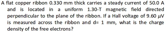

Turion
145
$$Δ{ V }_{ H }=\frac { IB }{ nqt } \\ 9.6*{ 10 }^{ -6 }=\frac { 50*1.3 }{ n*e*3.3*{ 10 }^{ -4 } } \\ n=1.28*{ 10 }^{ 29 }\quad electrons/{ m }^{ 3 }$$
mfb said:
You can use WolframAlpha to check calculations like that.
I thought the method was wrong because it gives us d=1mm but we don't use it in our calculations.
I'm not sure where the Hall voltage is measured, either 0.330mm or 1mm is not necessary.
Take a look at the Hyperphysics web page on the Hall Effect.
@Turion: Your calculation looks good.
