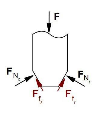

As usual, a Free Body Diagram will be a great help here. I encourage you to draw at least one for the vertical plunger - or whatever it is.
There is more than frictional force acting in the vertical direction! There is a component of the normal force that is vertical on each of the 2 contact surfaces. These will tend to push the plunger up.
The frictional force also has a vertical component - possibly positive or negative.
BTW: You really haven't given us your problem. Are you solving for the force that must be exerted on the plunger to keep it from moving upward, or are you solving for the range of the force that must be applied to the plunger to keep the system in equilibrium?
The Normal force on the plunger due to the spring on the right is:
[tex]\left|\vec{F}_{N}\right|=4,5\cdot\cos(30^\circ)[/tex] in a direction 30° above the horizontal.
So FN has a component in the y-direction (vertical direction) of:
[tex]\left(F_{N}\right)_y=4,5\cdot\cos(30^\circ)\sin(30^\circ)[/tex]
The frictional force associated with the spring on the left is in a direction which is either +120° or ‒60° from the positive x-axis. So the vertical component of this frictional force is:
[tex]\pm\mu\left|\vec{F}_{N}\right|\sin(60^\circ)[/tex]

Hello Pellefant.
Of course, the normal force the "plunger" exerts on the spring is equal & opposite the normal force the spring exerts on the plunger - that's just Newton's 3rd Law- a force and it's reaction force. Those forces do NOT cancel each other out because each is exerted on entirely different objects. ALL forces appear in pairs this way, even the frictional forces in this problem.
Don't be fooled by my user-name. I've been solving problems like this for over 40 years.
If you draw a Free Body Diagram for each spring and one for the plunger, you should see the angled surface between each spring and the plunger will allow each spring to exert a vertical force on the plunger. The countering force on each spring comes from the horizontal surface supporting each spring.
Free Body Diagram for the "plunger".
I'll do the left or right spring when I get a chance.
Hi i think i get it now; The force F1 i wrote about do no not act on the plunger, that so explains it; i can also see that on you free body diagram and understand it by intution. It was nice to get that problem out of the way :).
