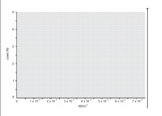

Hello,
I am trying to use this formula to fill in the rest of the table and I expect to get an answer between 0-5 x10-11. However i am getting nowhere near this however many times i attempt.

Load (m) (g)Load (W) (N)Deflection (mm)Deflection (δ) (m)48δI/L³ = (in x10^-11)
0​
0​
0​
0​
0​
100​
0.981​
5​
0.005​
200​
1.962​
10​
0.01​
300​
2.943​
15​
0.015​
400​
3.924​
20​
0.02​
500​
4.905​
25​
0.025​
Material: AluminiumL^3 =0.36^3 = 0.046656
Beam Size: 9.5mm x 3mm
b = 9.25mmLength =360mm
d = 3mmI = bd^3/12

I have calculated I to be = 1.78 x 10^-15 m^4
Yes the top of the last column, when i calculate it (48δI/L^3) I am getting answers that aren't in that range:
9.1537 x 10^-15.
I am not sure if i am typing it wrong into the calculator or my calculation for I is wrong.
The plan is to then put those answers onto this graph which has the values set from 0-7 x 10^-11 and my answers aren't near that.

You seem to be doing a 3-point bending test for which the stiffness formula is $$\frac{F}{\delta}=\frac{48 EI}{L^3}$$How did you get ##\delta## in your stiffness formula. The stiffness should be the slope of the graph of F vs ##\delta##. When you calculate the right side of the equation for comparison, make sure it is in consistent units.

Hello thanks for your time and the reply and apparently this is why: Rearranging the equation in the form y = mx+c means that the gradient of a chart of W against 48 δI /𝐿 3 will give the value of E.

Okay so i did: 48 x 0.005 x 1.78 x 10^-15 / 0.36^3
However i think the issue may be the deflection values, do you think 5mm is a lot of deflection of that beam with 100grams applied to it? maybe the indicator showed 5 but it really meant something like 0.05? or 0.5?

I think I have solved it! I was using the unit conversion for metres for δ, which was 0.005. However, when typing in just 5mm i am getting answers between 0-7 x 10^-11.

I think this is a silly way to do it. I would plot F vs ##\delta## and fit my best straight line through the origin to this. I would then calculate E from the slope m: ##E=\frac{L^3}{48 I}m##

This is how my University says how to do it. Just shows that I'm paying for people who probably don't know what they're doing haha. Thanks for your help Chester.
