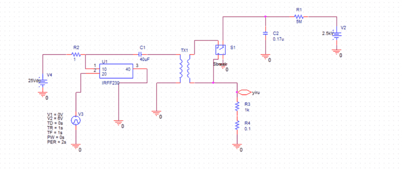

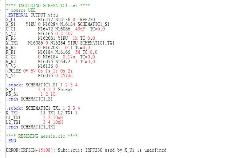

Error is like " no PSPICE template for 2N6798 , spark gap switch
how to find the .ilb of spark gap switch and 2N6798?
thank for your help.
The JEDEC part number 2N6798 is made by International Rectifier as the IRFF230.
There is a spice model for the IRFF230 in this collection, you may need to modify it for pspice.

I tried ,but the new error like this.
I am not sure what the mistake i made
Can you give me suggestions about this?
thank you very much.

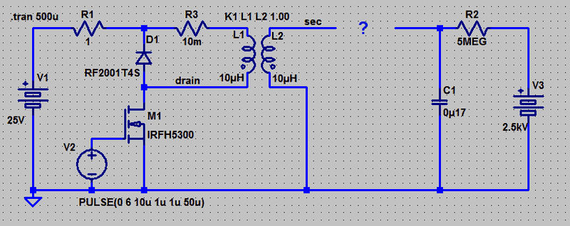

Your mosfet circuit is unusual. You must use pulse control of the gate. I have changed the circuit.
I have LTspice. See the attached circuit.
When M1 turns on, R1 limits the current through the transformer primary to Ip = V1 / R1 amp.
When M1 turns off, D1 conducts current through L1 to prevent voltage spike.
I do not understand your switch connections.
thanks for your apply

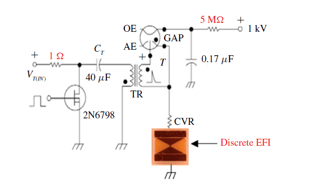

It is circuit from paper
I want to simulate this circuit with pspice.
This switch is spark gap switch.
But i do not know how to do
i am not a Electrical Engineering student ,so i am very confused about that

High voltage to trigger spark gap. Comes from a pulse transformer with high turns ratio. 1 : 50 ?
Design of transformer. Requires specification of spark gap device part number and data sheet.
Have you selected a three terminal spark gap component ?
What is part number for three terminal spark gap ?
Here are some spark gap examples and data.
http://www.highenergydevices.com/products/three-electrode%20/
Start with application note download; AN-TG-10 Use of Triggered Spark Gaps.
AN-TG-20 TX Miniature Triggered Spark Gaps Description and Use.
Also; Datasheets; TX Series Datasheet. Selection Guide; Three-Electrode Triggered Spark Gaps
AE = adjacent electrode? Adjacent to trigger = main electrode.
OE = opposite electrode? Opposite to trigger.

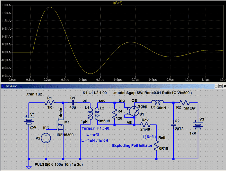

The MT4206 pulse transformer was used for original simulation.
It has only 1:1:1 turns ratio. It cannot be used for real circuit.
The trigger voltage must be HV, maybe 1kV. So turns ratio must be 25V : 1kV = 1 : 40.
Spice transformer ratio is set by inductance.
Inductance is proportional to n^2. So 1 : 40 turns ratio is 1.0uH : 1.6mH.

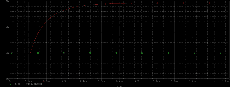

Attached is simple spice model of circuit and switch.
It shows same response as Fig 7 of Baginski Et Al. Micromachined Planar Triggered Spark Gap Switch.

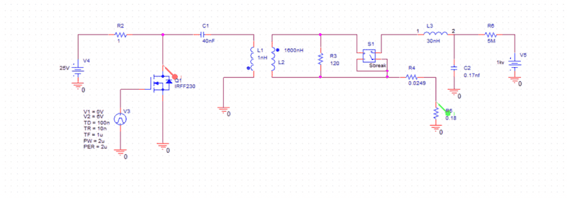

I tried,but my result is wrong.
thanks for your help.

DO NOT use “F” or “f” for capacitance with SPICE. It is sometimes seen as 1e-15 = 1 femto = 10-15.
Change C1 from 40nF to 40u
Change C2 from 0.17nf to 0.17u
Change L1 from 1nH to 1u
Change L2 from 1600nH to 1600u
Change R6 from 5M to 5MEG
What is your transformer coupling? Ktran L1 L2 1.000
What is your switch specification? .MODEL Sbreak SW(RON= ROFF= VT=500 )
Use any MOSFET that works in model. You may need higher voltage from V3.

Attached is file SG-4.asc.txt , remove the .txt to make SG-4.asc which is LTspice file.
Blue text is comment. Black text is Spice command or parameter values.
I do not use Pspice because it is limited or expensive.
LTspice is free. LTspice is not limited. There is a big LTspice users group.
