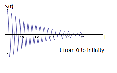

First of all, I have to calculate power spectral density S(jw) of this signal:
It looks something like that:
t>=0
It seems to me, that I can't use this standart formula:
So.. I see that there is signal multiplication- exponent and sinus, but still not clear how to get spectral density S(jw).
Any ideas?

But your ##S(t)## has ##e^{-at}## in it. If ##a## is large enough, won't that help you at your ##\infty## limits? I haven't worked it out because that's your job. Have you actually tried it? And your graphic shows only for ##t>0##.

What happens to terms like ##e^{-at}\sin(\omega_0 t)## and terms like ##e^{-at}e^{iwt}## when ##t\to\infty##?

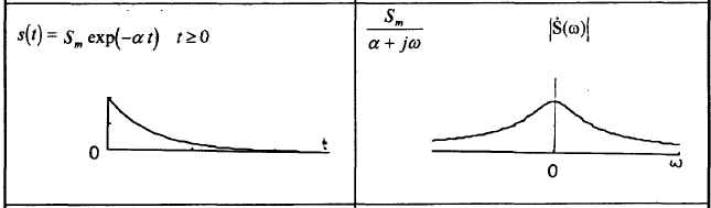

So.. I still don't know, how exactly I should say, but it's like Fourier transform. I have to calculate function in frequency domain.
For example:
I have to calculate my task like in this example.
And after that, also there are few extra tasks linked with S(jw), but now.. it means that it is Fourier transform and this is the answer of my s(t)?
In that case it gives 0 and then all part f(inf) gives 0.
There was doubts in my mind about Dirichlet's condition and sin(inf*w), but of course.. e^(-a*inf)=0, then it not matters.
Now it's clear. Thanks.

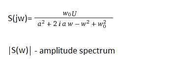

OK, if all you need is the Fourier transform of your time function then follow the advice in posts 2 and 4.
The Fourier transform definitely exists.

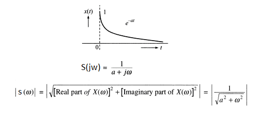

Also I have to calculate amplitude spectrum from S(jw).
But it's quite complicated s(jw) to separate real and imaginary part.
Are there is no easiest method?
So here is easy example:
What's the way in my S(jw) case? Must use this method?
I agree, the math is messy.

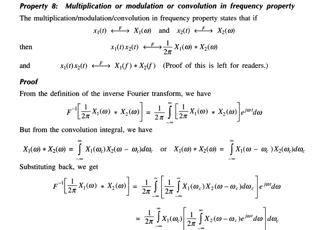

You should also consider that mutliplication in the time domain = convolution in the frequency domain.
