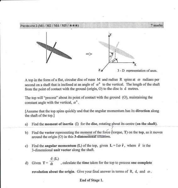

A top in the form of a flat, circular disc spins on a shaft that is inclined at an angle alpha to the vertical.
Now I have to find the moment of inertia I for the disc about its centre on the shaft.
My attempt was building I with spherical coordinates (r= length of the shaft, phi= \omega t , theta= angle to the vertical) But I think that's just the Point the vector r is pointing to the center of the disc ? :rolleyes:

How about you start with the definition of moment of inertia? (Assuming you need to calculate it from first principles rather than just looking it up.)
yeah I did it before but my problem is that I don't know how to describe the x y and z values to put them in the moment of inertia
I used the definition below for I and put in the spherical coordinates

Doc Al said:
Way too complicated! The moment of inertia of a disk is the same as that for a cylinder. See: Moment of Inertia: Thin Disk
thank you !
I know that the moment of inertia of a disc is the moment of inertia as a cylinder but how do i discribe the rotation of the disc when it spins on a shaft at an angle alpha?
The shaft of the spinning top would rotate on the coat of a cone i guess...
I'm not sure how detailed you need to be. Note that in part c they just refer to the direction the top is spinning as ##\hat r##.
okay thank you ! maybe I thought too complicated ... thanks a lot !
