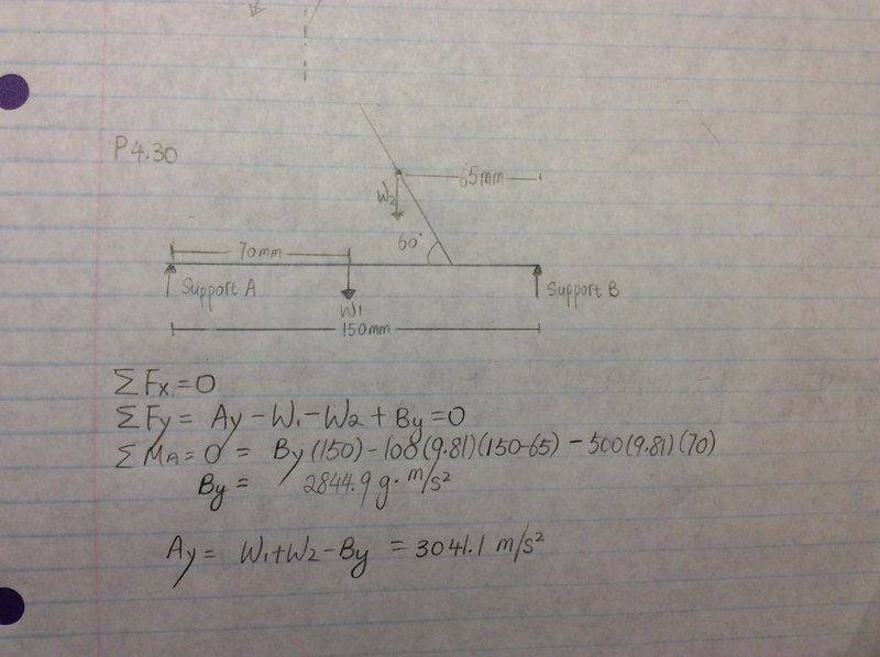

This is what I did, but it looks wrong to me

Ping427 said:
Can anyone help me with this question! I know to solve this problem, you have to set ΣF and ΣM =0, but what do you do with angle? (It's P.31 in the bottom)
Why do you think you need to do anything with the angle? The location of the center of gravity for the music player is shown on the figure. :wink:
If you want to express the reactions Ay and By in correct SI force units of Newtons, you should change the masses of the music player and the docking station from grams to kg at the beginning.
So they just place a angle there to trick me?
Sadly, yes.
SteamKing said:
Sadly, yes.
Thank you for telling me!:smile:
