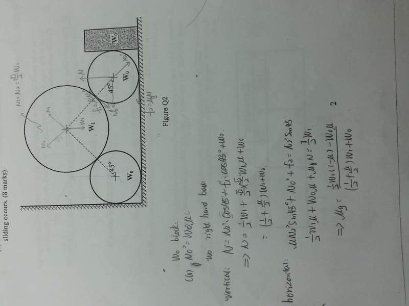

Two small balls, each of weight Wo, are supporting a big ball of weight W1, as shown in Figure Q2. The line connecting the center of the upper ball and that of a lower ball forms an angle of 45° with respect to the horizontal, as shown in Figure Q2. A block of weight Wo is placed on the right to prevent sliding of the balls. The vertical surface of the rectangle block is frictionless. The static friction coefficient equals μ between all balls and between the rectangle block and the bottom floor. Answer the following questions and express the answers in terms of Wo and μ. Make assumptions where necessary.
(a) Determine the minimum static friction coefficient between the bottom floor and the lower right ball for the system to be in equilibrium.
(b) Determine the maximum weight W1 that can be supported by the lower balls before sliding occurs.
f=μN.
Honestly, I have no thoughts about how to approach this problem. I am just thinking that, we should analyse the right ball, where it has a static friction μN, and N can be obtained by:
2Nsin(45)=W1;
And we use equilibrium for the right ball, and we will know the normal force it exerts on Wo. And we can then know the static friction coefficient by analyzing the block.
Can anyone give me more thoughts or inspirations to approach this problem?

I did my calculations as follow. Could you please check for me? This image is rotated wrongly when I upload. Could you please save it to your computer and rotate with windows photo viewer? It will be faster for u to read.
I can rotate it, but the image posted is far too small, and blowing it up to a readable size makes it all a blur. If you can't post a good clear image of your working, right way up, please take the trouble to type your working in, preferably in LaTex.
You can still refer to my sent image for some notations.
On the right handball, I denote:
normal force from bigger ball: N2'
normal force from ground: N
normal force from block: No'
weight: Wo
frictional force between the right hand ball and the bigger ball: f1=μN2'
frictional force between the right hand ball and the block: f2=μ'N
For the block:
No=Woμ=No'
For the bigger ball:
N2=(sqr(2)/2)W1
For the right hand ball:
Vertical equilibrium:
N=N2'cos45°+f1cos45°+Wo
N=((1+μ)/2)W1+Wo
Horizontal equilibrium:
μN2'Sin45°+No'+f2=N2'Sin45°
1/2 W1μ + Woμ+μ'N=1/2 W1
μ'= (1/2 W1 (1-μ) - Woμ) / (1/2 W1 (1+μ) + Wo)
You are assuming that all frictions are at their maxima. Can you justify that?
You're told that's frictionless.
N2=(sqr(2)/2)W1
f1 acts also from the r-hand ball on the large ball, and it has a vertical component.
There is friction between the r-hand ball and the ground, μ'. That is what you're trying to find.

For the first problem, I typed wrongly, it is friction between the ball and the floor.
And yes, I forgot to account frictional force on the bigger ball
For why I assume all frictions to be at its maxima, it is becoz I think once a part of this system is impending motion, any other parts of this system will be at impending motion since they are geometrically connected with each other.
I'm sure I could construct a system where everything is geometrically connected but the frictional forces don't all have to reach a maximum before something gives.
Suppose μ' is at its minimum value. Reducing it a tiny bit means something will move.
Can something move if friction between block and ground is still below max?
Can something move if friction between top ball and r-hand ball is still below max?
Um YEAH you are right. So I need to assume one friction is at maxima, and consider two cases where the frictional force between the bigger ball and the right hand ball is maxima and the frictional force between the block and the ground is at maxima?
You can "get rid" of the problem of not knowing the coefficient of friction between the floor and the ball if you take moments about this contact point.
The answers to my two questions are different. If the block doesn't move, nothing else can, so we can assume friction there is at max. When the block slips, there are two possibilities for what else does. Note, however, that it does say "Make assumptions where necessary." Since it is asking for a μ' that prevents slipping, you might need to make an assumption there. E.g. if μ is too low, could it be that no matter how large μ' is slipping will occur?
