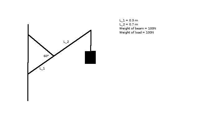

Please see attachment. A uniform massive beam attached to a wall at one end and supported by a cable (also attached to wall). On the free end of the beam is a weight. We are supposed to find the tension in the cable.
sum of the torques about "pivot" (point where beam meets wall):
where \alpha is the given angle of 60° and \theta is the angle of the beam to the horizontal. Also W is the weight of the load, WB anf F is the force in the supporting cable.
\Gamma = 0 = L_{1}Fsin \alpha - \frac{1}{2}(L_{1} + L_{2})W_{B}cos \theta - (L_{1} + L_{2})Wcos \theta
L_{1}Fsin \alpha = \frac{1}{2}(L_{1} + L_{2})W_{B}cos \theta + (L_{1} + L_{2})Wcos \theta
From there it should be a simpple step to solve for F. The problem is I can't work out \theta. Is there a way using the information provided?
thanks

And you have 2 unknown one equation. Algebra tells us that you can't solve the the unknowns.
Think about what kinds of equilibrium there are.
thanks. I guess you mean that it is static equilibrium. still don't see how this helps in this situation.

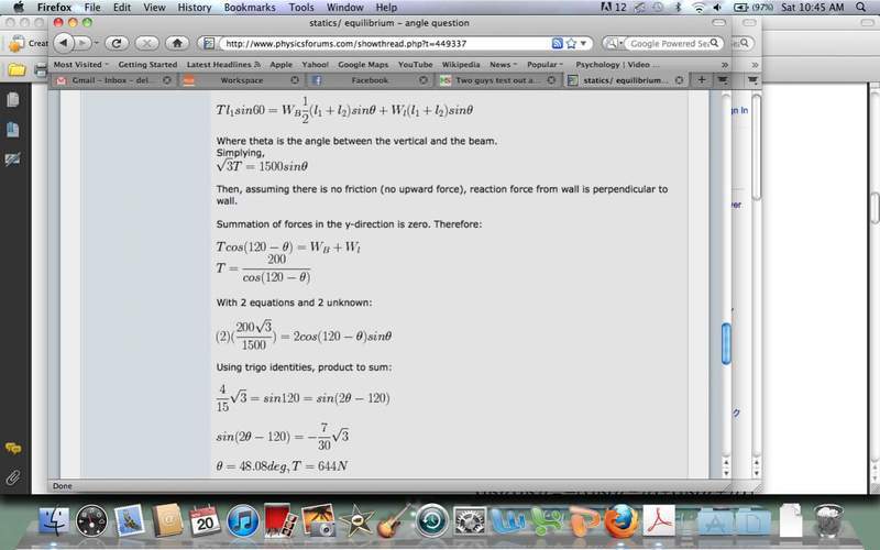

I somehow am able to compute an answer out. Is there any mistake i made?
Sorry, my computer needs an updated browser, I can't read LaTeX, it shows up black on my screen, so I can't readily spot your error. But I don't see how you can solve for theta...surely there exists a solution to this problem for any angle theta, not just the one you found.
Here's my print screen (:
Although I haven't checked all your work, I believe the angle theta that you have found is the one and only angle where the vertical reaction force of the wall on the beam is 0. This was based on your assumption, keenly noted, that there is no friction between the wall and beam, which you stated earlier. For every value of theta other than the one you have found, there is a vertical reaction of the wall on the beam, and the problem cannot be solved without additional information.
If the intent of the problem was to assume that the wall is frictionless, the problem should have stated that assumption. Or maybe the angle theta was inadvertently left out of the question? I don't know.
Yeah. I assumed that there is no friction so as to allow me to carry on computing the value. Thanks for your input. Guess the question is no very clear.
hi guys (gals?) thanks for all the help. the question as is is not solvable. just got an email from the prof saying that the angle between the beam and the horizontal should be 30°, which wasn't stated in the original question.
