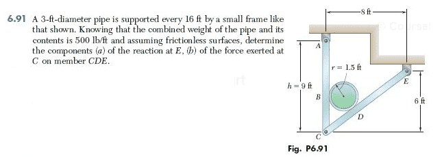

yaro99
75
Statics diagram of problem 6.91: a 3-ft-diameter pipe supported by a frame with members ABC and CDE, labeled h = 9 ft, r = 1.5 ft, 8 ft, and 6 ft, with points A, B, C, D and E.
ƩF_y=0
ƩF_x=0
ƩM=0
The weight of the wire is 500*16=8000lb

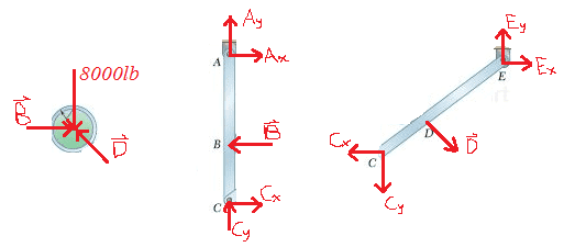

I isolated each part of the system:
Free-body diagrams in three parts: a pulley or spool with an 8000lb load and forces E and D; member ABC with pin A reactions Ax and Ay, force B, and reactions Cx and Cy; member CDE with reactions Cx, Cy, Ex, Ey and force D.

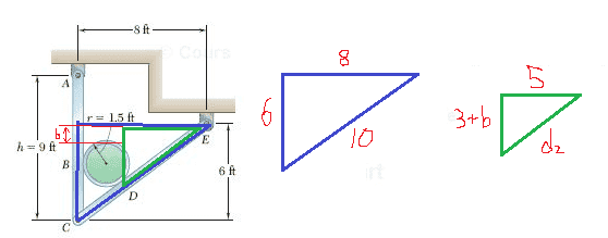

Using a force triangle on the cross section of the wire, knowing it is a 345 triangle:
8000/4=B/3=D/5
B=6 kips
D=10 kips
I wrote equations for members ABC and CDE:
for ABC:
ƩMA = 6*d1 + 9*Cx = 0
for CDE:
ƩME = 10*d2 - 6*Cx + 8*Cy = 0
d1 and d2 are the vertical distance from A to B, and the diagonal distance from D to E, respectively. This is what I had trouble finding.
I tried using similar triangles:
Two annotated force triangles: a blue right triangle with legs labeled 6 and 8 and hypotenuse 10, and a green right triangle with top 5, side 3+b, and hypotenuse d2.
5/8 = a/10 = (3+b)/6
b=0.75ft
d2=6.25ft
Since b is 0.75, d1 = 9 - 6 + 1.5 + 0.75 = 5.25ft
Plugging these into the above equations, I get Cx = 3.5kips, and Cy = 10.4 kips, which are not the right answers.
I would have expected Cx and Ex to point the other way to your diagram.
I think you may need to revisit the distances to the contact points (pipe to frame).
If you put point P at the center of the pipe, then what do you notice about the triangles CBP and CDP, and, therefore the relative lengths. You know the radius of the pipe and the angle BCP.
note: suggest you use d=|CD| and b=|CB| to ease typing ;)
Left: physics diagram of a pipe over a corner with points A through E, labeled 8 ft, r = 1.5 ft, h = 9 ft, b and 6 ft. Right: two annotated right triangles, a blue one with sides 8, 6 and 10, and a green one with sides 5, 3+b and d2.
The vertical side of the green triangle is not tangent to the right side of the pipe. So, I don't think that the horizontal side of the green triangle is 5 ft.
Maybe you can use the red triangle shown in the attachment to find the distance between D and C.
[EDIT: Oops. I see Simon posted while I was busy constructing my post.]
Judging from your sketch, you seem to have assumed that a vertical line tangential to the RHS of the pipe and a horizontal line tangential to the underside of the pipe will intersect CDE at the same point. That is not the case.
Free-body diagrams of three parts: a pulley with a labelled 8000lb load and forces D and E; a vertical bar labelled A, B and C with reaction forces Ax, Ay, Cx, Cy and force B; an inclined bar labelled C, D and E with forces Cx, Cy, Ex, Ey and D.
Just curious as how the vertical bar will remain static if there are no force vectors down?
Right, there must be a downward force. But it's ok to set it up as in the free body diagram. In working out the equations, you will just find that Cy is negative which indicates it's actually downward on the vertical rod and upward on the other rod.

Thanks everyone for the help, I figured it out.
Using the triangle method suggested, with triangles BCP and PCD, I found that angle BCP = angle PCD = 1/2 angle BCD = (1/2)*arctan(8/6) = 26.6°
using the law of sines for BCP:
1.5/sin(26.6) = b/sin(63.4)
b = 3ft
and for PCD:
1.5/sin(26.6) = d/sin(63.4)
d = 3ft
where
d=|CD| and b=|CB|
this makes d1 = 9 - 3 = 6ft, and d2 = 10 - 3 = 7ft
Plugging these into my equilibrium equations (and fixing my error in the ƩMA equation) I get the correct answers.
To find Ex and Ey I just used ƩFx=0 and ƩFy=0 for member CDE.
