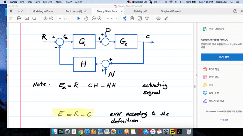

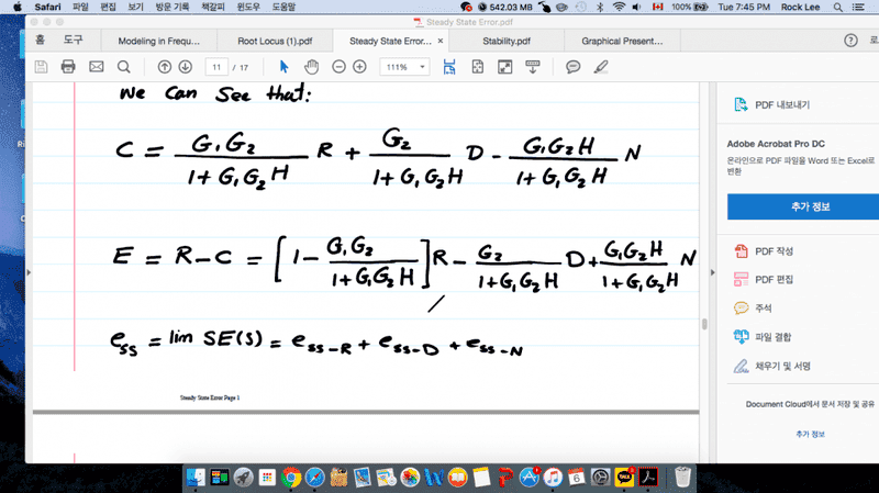

Hello,
I have a question about steady state error.
how can we get to the C?
I think it has to be Ea(G1+D)G2=C
which gives(R-NH)(G1+D)G2 / (1+(G1+D)G2H)=C

Hi,
Is there a contradiction between what you write and what the author writes ?
