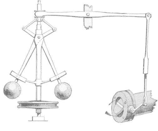

Consider the flyball governor in this system. It senses the changes in speed of the turbine. If load is increased, the balls will slow down and will move inwards, moving point B upwards. Now, this will open some additional valves to allow more fuel. What is the role of speed changer in this? Basically, what is a speed changer? How is reference power set in the speed changer? Please explain.
Also, is it correct that the primary ALFC loop (containing governor) is used to prevent sudden changes in frequency and there remains some steady state error in frequency even after opening or closing the additional valves?

I'm sure that there are some mechanical flyball governors still in service, but most plants do it electronically or digitally today. The "speed changer" sets the speed reference point (which is proportional to power reference point). Many plants call it the speed/load changer to emphasize that it does both functions at once. During startup, before synchronization with the grid, it changes speed. After synchronization, the same adjustment it is used to change load (i.e. generation).
That picture is of James Watt's original governor. The turnbuckle on the vertical member to the right could be used as the speed changer. If you adjust the turnbuckle, you change the amount of power without changing speed. An adjustment nut on the top of the flyball assembly could do the same thing.
Take away the word "sudden" from your description; frequency is incapable of sudden changes.
The governor acts to change power in response to speed changes. A proportional controller does not force the speed error to return to zero, so yes an error remains in steady state. The key thing to remember is that speed governors act locally, and swiftly. They do not need information other than the locally measured frequency. AGC does need central measurements and remote communications, and it controls all generators in the area, not just one. ACG is necessarily slower than governor action.
And that is how you "set the reference power" in speed changer?
This governor is in our syllabus. So, when the turnbuckle is adjusted for setting reference power, is there some additional controlling force that is applied to the governor flyball mechanism to maintain its speed?
Also, I read that the reference power set is higher than the actual power, which increases the proportional error and more fuel can be allowed on the turbine. Is this reference power setting always constant for a machine?

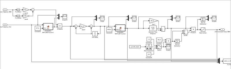

I read this expression from block diagram:
Input to the governor block was written as
ΔPg=ΔPref-Δf(s)/R. I can understand that the term Δf(s) is a direct feedback from the electrical grid but where does this ΔPref come from? Why change the reference power?
You're missing an important point. Before synchronizaiton, the governor controls speed. After synchronization, the generator is locked to grid frequency, and a singe generator can do almost nothing to change the frequency of the entire grid. Therefore, when synchronized, that same speed control changes power, not speed. You should review the step-by-step chronology in the first PF insights article.
Yes, if the set point is the same as the feednback, the output would be zero, meaning no steam or no fuel, zero power. Therefore, in the steady state an error remains. The error times the gain is proportional to the steady state power.
Pref is the speed/load changer we were talking about. It is adjusted by the operator and also by the grid (i.e. the raise/lower pulses you mentioned.)
I think you are getting confused by the different names used for these things. Historically these things have picked up many names over the years. We just have to live with that. Learn to focus more oh the topology of the feedback loops rather than the labels of the components. For each loop, what gives you a steady state?

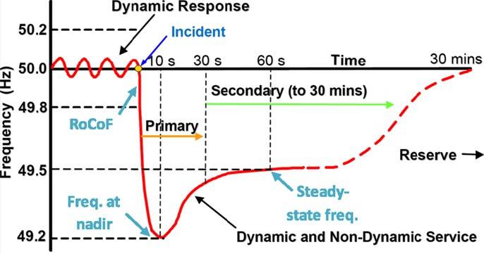

I read the first PF insights article you mentioned. It says that after about 15 seconds, central generation control unit senses the changes in speed and issues new set points to the individual generators. Does it include setting of Pref? When the speed changer receives this change in Pref, does it immidiately set the new power reference? Doesn't that affect its current operation? I mean, if the generator is supplying 100MW when the Pref signal is received from the central control, and the new Pref is 120MW, how does the speed changer respond?
I know I am asking too much but I can't get my head around many things and I am having trouble correlating various blocks of the system.

As far a maintaining frequency, the generator governor is considered "Primary Control". (ie, in the time frame of seconds) But for maintaining frequency for a control area (where ACE is being calculated there), that's where AGC comes into play. The setpoint on the generators (when set to automatic mode) is determined where both proportional and integral control is used. This is considered "Secondary Control". (ie, in the time frame of minutes)
From the NERC Balancing and Frequency Control document I posted:
Primary Control is more commonly known as Frequency Response. Frequency Response occurs within the first few seconds following a change in system frequency (disturbance) to stabilize the Interconnection. Frequency Response is provided by:
1. Governor Action. Governors on generators are similar to cruise control on your car. They sense a change in speed and adjust the energy input into the generators’ prime mover.
2. Load. The speed of motors in an Interconnection change in direct proportion to frequency. As frequency drops, motors will turn slower and draw less energy. Rapid reduction of system load may also be effected by automatic operation of under-frequency relays which interrupt pre-defined loads within fractions of seconds or within seconds of frequency reaching a predetermined value. ...
Secondary Control typically includes the balancing services deployed in the “minutes” time frame. Some resources however, such as hydroelectric generation, can respond faster in many cases. This control is accomplished using the Balancing Authority’s control computer4 and the manual actions taken by the dispatcher to provide additional adjustments. Secondary Control also includes initial reserve deployment for disturbances.
In short, Secondary Control maintains the minute-to-minute balance throughout the day and is used to restore frequency to its scheduled value, usually 60 Hz, following a disturbance. Secondary Control is provided by both Spinning and Non-Spinning Reserves.
The most common means of exercising secondary control is through Automatic Generation Control (AGC). AGC operates in conjunction with Supervisory Control and Data Acquisition (SCADA) systems. ...

Any ideas on how to improve the output using PI or PID?
Sure, I've done lots of work on that question. But the results are unique to the power plant. You need to model the dynamics of the primary energy source (boiler, reactor, hydro, whatever) and the dynamics of the power grid and nearby generators.
There are also varying definitions of "improved." The system operator that runs the central AGC wants all power plants to respond exactly as they predict it will. That enables them to predict the overall system response when they give commands to all generators. If you make a significantly "improved" governor, they will have to make a special model of your power plant in the AGC. That will not make them happy because is it too hard to maintain a unique model for every generator.
So what I'm saying is that your idea of "improved" and other's ideas of "improved" may conflict.
Look up "Isochronous" .
On a big system that's likely to cause you trouble if implemented locally. It's what the central control does for you.
Here's a link to a paper by the folks who "Wrote the book" on governors.
http://files.engineering.com/getfil...sc=212727627.1.1525454864261&__hsfp=449896063
it'll put a pdf in the downloads folder on your C drive.
Thanks for your response, any suggestions where can I add the PID or PI controller to improve my delta frequency ?
If you add integral to an everyday 'droop' governor you have an 'isochronous' governor.
It is option on small machine governors I've seen that might operate as an island, ie not connected to the grid..
But you cannot willy-nilly add integral to multiple machines that are operated in parallel lest they commence 'chasing' one another. You should measure and proportion load among them.
At the central control point to all plants is the place for integral. In my day the dispatchers did that manually by calling plant operators on the radio and asking them to adjust generation slightly.
old jim
old jim
Thanks Jim
