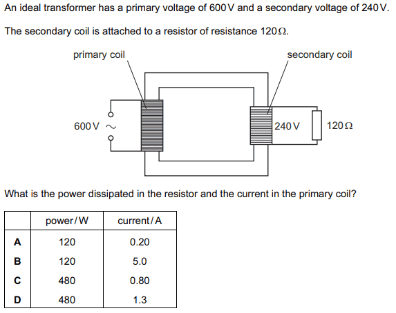

Calculating Current in Primary Coil: Where Does P = V^2/R Formula Come In?
In summary: Rboth forms are equivalent...if one is calculating dissipation through load resistance R its good but how you got 5 amp as current?

How will we calculate the current in primary coil?
The current in the secondary coil will be 2 Amperes by I = V/R. So in the primary coil by using ratio proportion method, the current in the primary coil will be 5 Amperes. But this leads to wrong answer.

Show work for how you come up with 5A for the primary coil current as a starting point...

is there a relation between Vp Vs and Ip , Is ? ultimately they are related to number of turns also.
600V ---- x
240V ---- 2
Since they are directly proportional, we can get x = 5 ampere but I don't think this is a correct answer..
But number of turns in primary and secondary coil are not mentioned..
By law of conservation of energy - power is conserved in the input and output
Vp . Ip = Vs. Is
Vp . Ip = Vs. Is
Oh Thanks, by finding Ip I can find the power dissipated by the formula P = IV right?

Just to increase knowledge, where do we use the formula P = V^2/R ?

its v^2/R
but how you got 5 amp as current?.
