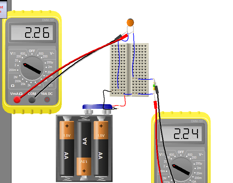

hi,
i tried to simulate a simple capacitor and resistor charging circuit like this
i used an imaginary resistor value "10M ohm" the result as you see appear to be strange, why this happened? is capacitor's charge is relative to the voltage on the capacitor it self?
and i need some recommendations of books explains electrical circuit component :)
thank you.
What simulation program is this? Does it simulate the impedance of the voltmeter. If so, what is their impedance?
+1
Does it model leakage current in the capacitor?
