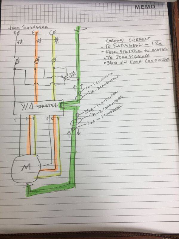

In the attached picture, I’ve drawn a crude schematic of the motor circuit. It is fed from a switchgear feeding 3 total motors.
The feed contains 2 parallel conductors on each phase and ground. The equipment ground reads 12a going back to the switchgear, 6a per conductor. From the starter to the motor each ground conductor measures 36a, and 6-7a when measures on both. There are 2 conduits with 1 ground each. Each conduit contains 1,2,3 and 4,5,6 motor leads. (6 lead motor)
It seems to cancel out like there is a loop there. The grounds are tied on to the same lug, so it’s like it’s only on half of the ground circuit.

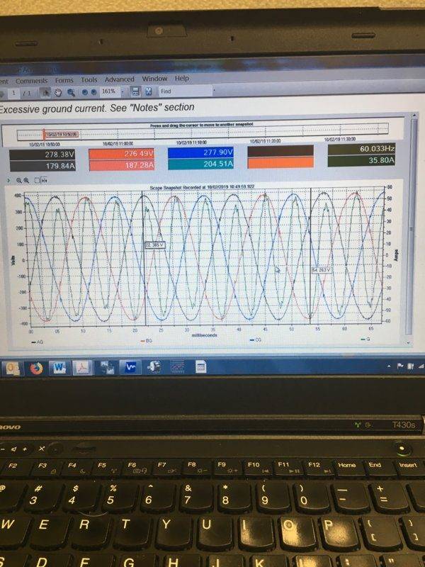

I know it’s strange. And I’ve never seen it before. I’ll also attach the data I collected with a fluke logger. The ground current was only measured on 1 conductor during that acquisition to read the 36 amps.

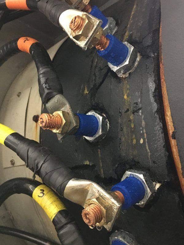

The motor terminals (on a hermetic motor) have a lot of water on them, and my boss believes that is causing it. But that doesn’t explain the ground loop. We also ran a 500vdc meg test and saw >1ma of leakage to ground. I believe we would see more like 36amps if that was the case.

Ground current is also 180hz. That indicates all three phases are contributing. 3rd order harmonics are high. But I have a lot more to learn about harmonics, so that could be irrelevant. The data for phase to ground voltage/ and ground current is attached. I have a full report but it is too large to attach

This needs to be broken down a bit more. You mention switchgear feeding three motors but you seem to imply that only one motor is suspect of a fault. Is this correct? Parallel conductors should not do what you described. Maybe if they are terminated together on one end they could, but not both ends.
Likes kenneth edmiston and Tom.G
To answer the questions top to bottom, it is not an earthed neutal. It is on an equipment ground. the current is constant during operation. The ground is terminated in the peckerhead and does not enter the motor.
If the grounds were open between the motor starter and switchgear I would expect to see no current, instead I am reading 12a back to the switchgear.
You are right, all three motors are experiencing current imbalances and excessive ground current. None that I saw had this strange issue. The grounds terminate in the switchgear on a common ground buss. And are terminated together at the starter.
I know it seems very unlikely that there is a loop like that, and I agree. But I tried everything I could think to disprove that theory and couldn’t. The only thing I was unable to do was open one of the parallel grounds to observe what happened to the current with one conductor. I didn’t want to send the current back to the starter and trip the ground fault relay. This is in a hospital
