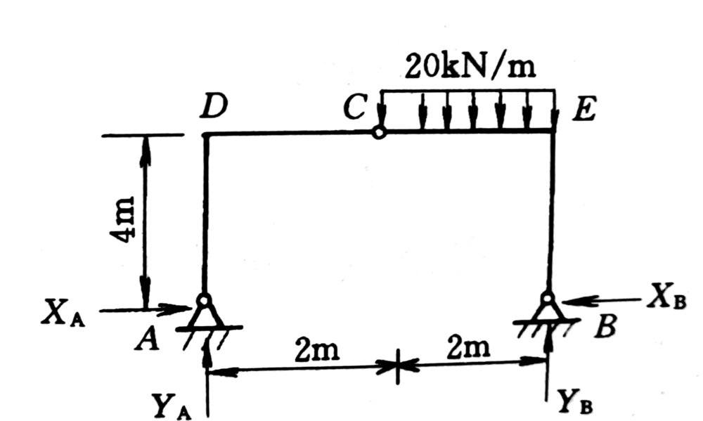

What's your result of ##X_A##? I find mine is different from the standard answer.
My answer for $$X_A =5 kN$$
Problem Statement: What's your result of ##X_A##? I find mine is different from the standard answer.
Relevant Equations: My answer for $$X_A =5 kN$$
$$\sum m_C=0$$
Here is a triple hinge, try to plot its M, W, N.

Show your work

Show us the details of what you did.
