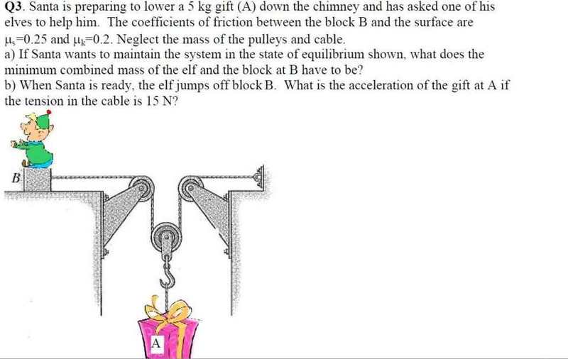

Solving MA: Sum of Forces = Mass x Acceleration
To solve for the acceleration of body A using the equation Sum of Forces = Mass x Acceleration, focus on analyzing the forces acting specifically on body A. The first part of the problem has been solved, yielding a mass of 10kg. For part B, it is crucial to correctly identify which free body diagram (FBD) to draw to accurately assess the forces on body A. Properly identifying the forces will lead to the correct calculation of acceleration. Understanding the relationship between mass, forces, and acceleration is key to solving the problem effectively.
Oblivion77
113
Sum of forces = MA
I already found the answer to part A, which is 10kg. But for part B I am not sure which box to draw my FBD on.
Since you want the acceleration of body A, analyze the forces on body A.
