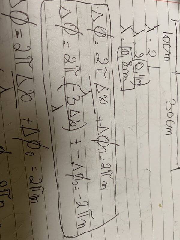

Two loudspeakers emit sound waves of the same frequency along the x -axis. The amplitude of each wave is a. The sound intensity is minimum when speaker 2 is 10 cm behind speaker 1. The intensity increases as speaker 2 is moved forward and first reaches maximum, with amplitude 2a, when it is 30 cm in front of speaker 1. What is
a. The wavelength of the sound?
b.The phase difference between the two loudspeakers?
c.The amplitude of the sound (as a multiple of a ) if the speakers are placed side by side?
Wavelength=2L
2pix/wavelength+Phasedifference
Wavelength = 2L = 80cm

I confirm your value for wavelength.
The rest I cannot make sense of and it is truncated. Please define your variables and post as typed algebra, preferably in latex. Images are for diagrams and textbook extracts.
One symbol is unclear... could be a lowercase x or a backward α.
ϕ=2πx/λ for the phase difference, how can you measure the phase difference for the speaker 2 when it moves to its maximum? I was trying to measure the speaker 2 at its minimum and then measure it to its maximum... does it make sense ...thanx

ok the difference between the two formula is the difference -2πx/λ
Right, so if x is 30cm and the wavelength is what you calculated, what is the phase difference in radians?
2πx/λ
=2π0.3/0.8
=2.355
=π/1.33 rad :rolleyes:

ok so this is what i came up with
2πx/λ
=2π0.3/0.8
=3/4π
2πx/λ
=2π0.3/0.8
=3/4π
Yes.
