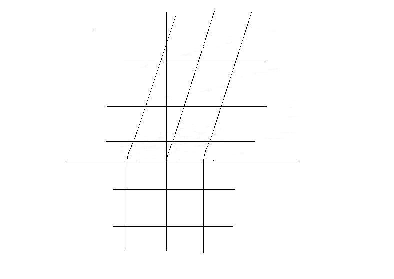

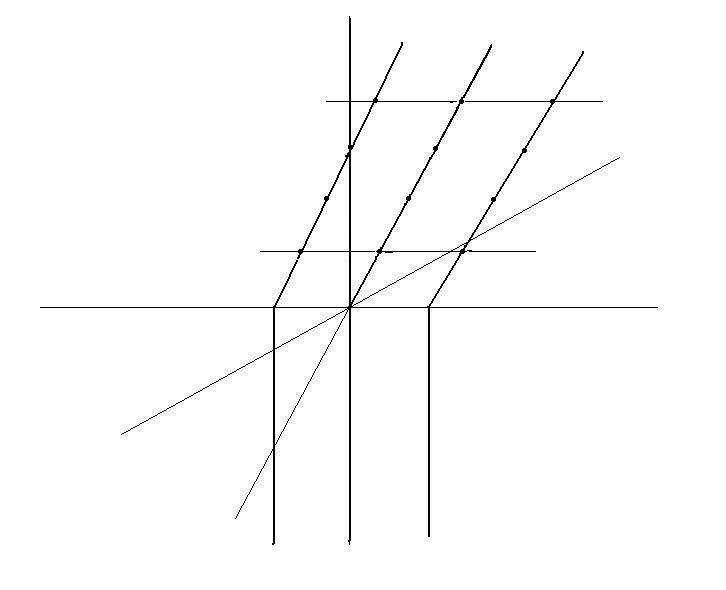

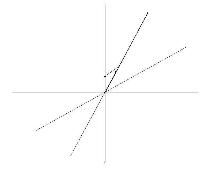

Hello,
The below images show O's accelerating motion with respect to R. As speed changes desynchronization becomes bigger with respect to R.
Please, look at first frame of below image. It shows desynchronization of clocks when frame is in motion. But, it is with respect to R.
When we transform to first frame, as below image shows there is no longer desynchronization with respect to O. But, second frame is desynchronized with respect to O.
But, again we transform to second frame. there is no longer desynchronization with respect to O. But, first frame is desynchronized with respect to O.
So, desynchronization is only there when we see other frame. Our own frame cannot have desynchronization with respect to itself.
So, as I understand constant speed of frame would not create desynchronization, and changing in frame (acceleration) also would not create desynchronization.
Can you explain me how acceleration can create desynchronization with respect to O?
John232 said:
I don't recal ever hearing that clocks that accelerated together at the same rate would ever no longer be synchronized.
In an inertial frame this is correct. Two clocks which are initially synchronized and share the same speed profile will remain synchronized, but only in that inertial frame.
In other inertial frames or in non inertial frames they will not be synchronized. O's frame is non inertial.

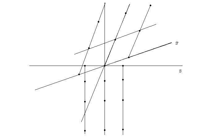

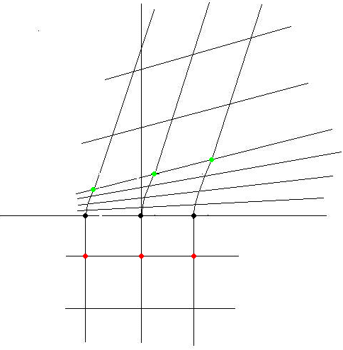

There is other doubt too.
second image of post #36 says clocks is synchronized with respect to O, but not for R. For R clock A is ahead of clock B, because signal reaches lately to B with respect to R because of direction of motion.
Suppose, that train is coming from far left of R, it passes R and goes far right with constant velocity. So below image show how clocks becomes desync with respect to R. It also tells train coming from left and goes right not make changes in desync. A is always ahead of B with respect to R during whole journey.
But, wait if we think how R sees clocks during whole journey. Below image show that
There is matter that train coming from left and goes to right. Coming from left tells R that clock B is ahead of A, and going right tells R that clock A is ahead of B.
Look, at the point where R and O is on perpendicular line of train path way. This is the point where R thinks both clock is synchronized.
From my understanding, first image shows that "R thinks that clocks would be desynchronized like this with respect to O". Neither for R the clocks would be desynchronized like this, nor for O.
What I understand is clocks is perfectly synchronized for O and, clocks is desyhnchonized with respect to R as showed in second image.
Can anyone shade some light on this?
Certainly, it follows directly from the Lorentz transform. Let's analyze the scenario from the OP where at t=0 in the original frame A, B, and M all accelerate instantaneously up to v = .6c and furthermore let's use units where c=1 and where the distance from M to A and from M to B is 1 in the original frame.
So, in R's frame the worldline of A, O, and B are:
[tex]r_d=\left(t,x=\begin{cases}<br /> d & \mbox{if } t \lt 0 \\<br /> 0.6 t+d & \mbox{if } t \ge 0 <br /> \end{cases}<br /> ,0,0\right)[/tex]
where d=-1 for A, d=0 for O, and d=1 for B.
As per the OP, the clocks are initially synchronized in R's frame such that at t=0 they all read 0. So, we can calculate the time displayed on each clock, τ, using the spacetime interval. Solving for t we get:
[tex]t=\begin{cases}<br /> \tau & \mbox{if } \tau \lt 0 \\<br /> 1.25 \tau & \mbox{if } \tau \ge 0 <br /> \end{cases}[/tex]
Substituting into the above we get:
[tex]r_d=\left(<br /> t=\begin{cases}<br /> \tau & \mbox{if } \tau \lt 0 \\<br /> 1.25 \tau & \mbox{if } \tau \ge 0 <br /> \end{cases},<br /> x=\begin{cases}<br /> d & \mbox{if } \tau \lt 0 \\<br /> 0.75 \tau+d & \mbox{if } \tau \ge 0 <br /> \end{cases}<br /> ,0,0\right)[/tex]
Noting that τ does not depend on d in this frame we see immediately that the clocks remain synchronized in R's frame.
Now, boosting to the primed frame where O is at rest for τ=t>0, we obtain.
[tex]r'_d=\left(<br /> t'=\begin{cases}<br /> 1.25 \tau - 0.75 d & \mbox{if } \tau \lt 0 \\<br /> \tau - 0.75 d & \mbox{if } \tau \ge 0 <br /> \end{cases},<br /> x'=\begin{cases}<br /> 1.25 d - 0.75 \tau & \mbox{if } \tau \lt 0 \\<br /> 1.25 d & \mbox{if } \tau \ge 0 <br /> \end{cases}<br /> ,0,0\right)[/tex]
Noting that τ does depend on d in this frame we see immediately that the clocks are desynchronized in O's frame. If there is some step that you do not follow then please ask for clarification. But it is quite clear the the clocks remain synchronized in the unprimed frame and are not synchronized in the primed frame.

mananvpanchal said:
Please, shade some light on my post #36 and #39. Please, tell me what is wrong with my understanding.
If you go back to your #36 and #39, you can see that you have identified some events on A and B which are identified as being simultaneous for O.
What you have not done is indicate what the clocks at A and B read at those events. However, if you look at the length of the line from the bend, when the clocks all read 0, to the events in question you will see that they are different lengths.
Therefore A and B will not read the same at those events. They will therefore be desynchronized according to O.

John232 said:
I fail to see how that is true without an explanation. For instance, how does the relation of the distance of two objects make them observered from rest as measuring time differently when they have accelerated the same amount for the same duration?
If we have a long object such as a rocket with initially synchronised clocks at the tail and nose and accelerate the rocket, the clock at the tail travels a further distance than the clock at the front of the rocket in a given time as measured in the original rest frame. This causes the clocks become unsynchronised in the rest frame of the rocket as the rear clock effectively has to travel faster (in the original frame) and time dilates to a greater extent. This is because in order for the rocket to retain its proper length in the rest frame of the accelerating rocket, it is length contracting in the original frame. THis form of acceleration is known as Born rigid acceleration (See http://www.mathpages.com/home/kmath422/kmath422.htm or Google Bell's rocket paradox). The clocks will remain synchronised (in the launch frame) under acceleration if we insist the clocks remain the same distance apart in the launch frame, but under these conditions the the rocket will be increasing its proper length and eventually be torn apart. Even under these conditions, the clocks will be unsychronised in the rest frame of the accelerating rocket because the rocket has a velocity relative to the launch frame and the relativity of simultaneity means that if the clocks appear synchronised in the launch frame they will not be synchronised in the accelerating rocket frame.
Sorry for the layman's sloppy explanation but I think that is the gist of it ;)
