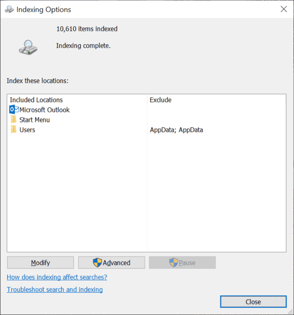

It used to be that "indexing" as a background task took lots of CPU and disk bandwidth (in earlier versions of Windows). I made it a habit to disable indexing on my computers, and ignored the warning that doing so could make disk searches take longer. I don't know if this is still an issue in Windows 10.

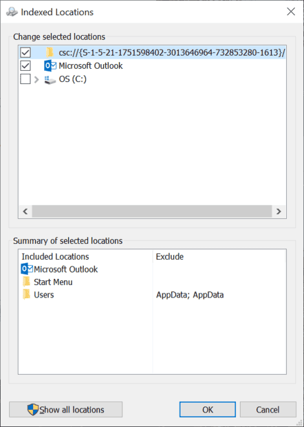

When you look at your Indexing Options in your Win10 Control Panel, what does it say? I got there by typing "Indexing" in the little Windows run box at the lower left of the screen, and selected Indexing Options:
