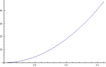

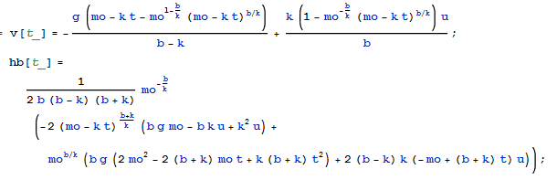

So I have some very complicated functions that do not have trivial inverses, but I'd really like to make a new function from them. What I have is:
v(t): velocity as a function of time
h(t): height as a function of time (never mind that is says hb)
What I want:
v(h): velocity as a function of height
The height function goes as an exponential function, so there are no local minima to worry about:
Other than fitting a polynomial to the h(t) function (which I'm not sure would be invertible anyway), does anyone know of a good way to combine these functions into v(h)?

How/where do you need v(h)? It is easy to calculate individual points, and you can also calculate the derivative v'(h) analytically for every point where you know t.
If (b+k)/k is a small integer, it is possible to write down t(h) in closed form, otherwise it is probably impossible.
Introducing new variables for t-independent stuff would make the equations much more readable.

Unfortunately, the quantity [itex](b+k)/k[/itex] will be, at best, [itex]1[/itex] so it can't be ignored...

Unfortunately, the quantity (b+k)/k will be, at best, 1 so it can't be ignored...
If it is 1, h(t) is a polynomial of degree 2, and easy to invert.
Numerically, you can just integrate over t and don't need anything special.
Yeah the problem is, it'll never be 1 in reality. It'll be something like (0.05+k)/k which is why it's so hard to invert.
All that doesn't matter if you just need a numerical value for the integral.
