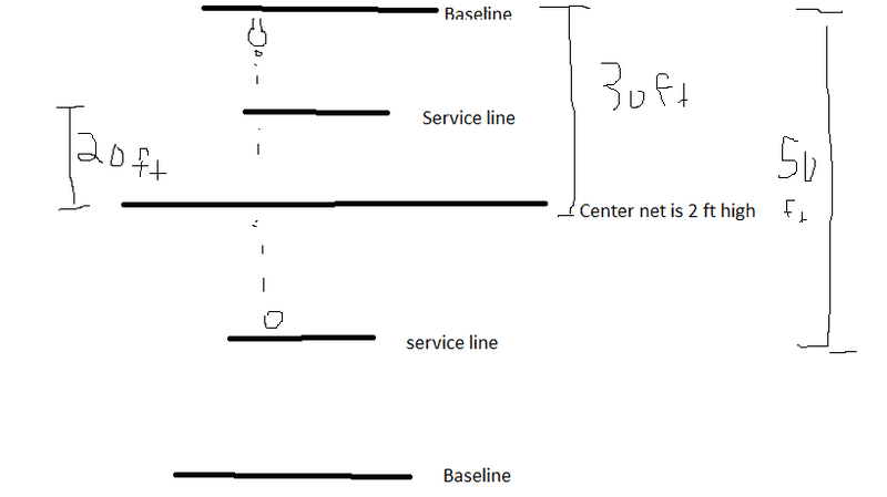

1. Consider tennis net which is 2 ft high at its center point; the service line is 20 ft from the net, and the baseline is 30 ft from the net. You have a bullet-like service that travels in a straight line, just clearing the net before hitting the service line.
a) What angle does the trajectory of this serve make with the horizontal?
b) At what height above the ground is the ball struck with the racket?
1)i don't know how i would find an angle without given one? do i need to assume?
2)dont know where to start
1)please help spent hours trying to solve this problem

heres what i drew and my thoughts
It is not shown.
ehild

jackarms said:
The problem says it travels in essentially a straight line from the start until the net, so the path lies directly along the horizontal. What then is the angle between the path and the horizontal?
I don't follow. Just because it travels in a straight line doesn't mean the path has to be horizontal... just straight, right?
This is the diagram I would draw. Only needs basic trig to work out the angle and H. You could also work out H using the law of similar triangles.
Likes 1 person
yea that makes more sense c watters
Ah yes, my bad. I glossed over the word "service" and just thought the ball was being hit somehow. I think that diagram is the best way to interpret the problem. So I guess it ended up being more geometry than anything...
so for the tan-1(2/20) of the little triangle be the same as theta of the whole triangle?
the angle is (.1) very small
i got 5.1 as the height
Check the angle. I got 5.7 degrees and exactly 5 ft for the height.
Tan^-1(2/20)=5.7
H=(2/20) * 50 = 5 using the similar triangles rule
Just for completeness this is how the similar triangles rule works...
The angle is the same for the small and large triangle so:
Tan(θ) = 2/20
Tan(θ) = H/50
2/20 = H/50
H = (2/20) * 50 = 5ft
