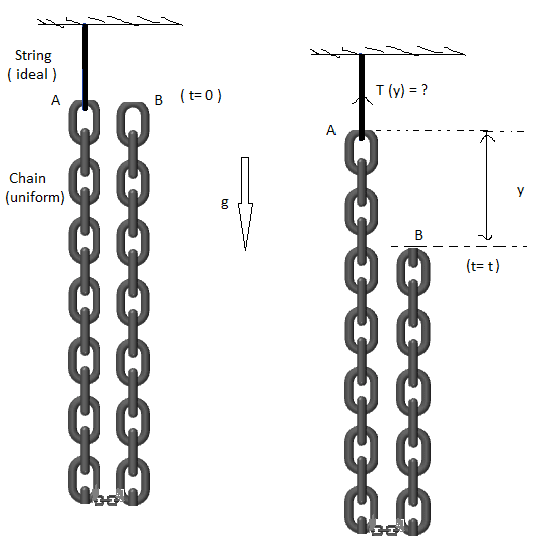

A uniform chain of length L and [constant] mass per unit length λ is suspended at one A end by an inextensible light string. The other end of the chain B is held at rest at level of end A of the chain. [See image.] Now if the end B of the chain is released under gravity, then find the tension in the string when the end B has fallen a distance y
Two diagrams of a uniform chain hanging from a string: at t = 0 both ends A and B are level, and at t = t end B has fallen a distance y, with T(y) = ? marked at the string and g shown pointing down.
F=dp/dt
I was thinking the tension would be equal to the weight of the chain [itex]gλ(\frac{L}{2}+y)[/itex] plus the change in momentum per time of the chain that is transitioning from the right to left side (in the image).
The momentum per time would be equal to the speed times the mass per time, and the mass per time would be the speed times the linear density, so I get:
[itex]T=gλ(\frac{L}{2}+y)+λv^2[/itex]
v can be written in terms of y as [itex]v=\sqrt{2gy}[/itex] so I get:
[itex]T=gλ(\frac{L}{2}+3y)[/itex]
But this is apparently incorrect

If the right end went down by y, how long is the left side?
L/2 + y
If the right side is fully down (y=L) then the length of the left side is L/2+L > L? I see a problem with that assumption.
[itex]T=\frac{gλ}{2}(L+5y)[/itex]
But it still says this is the wrong answer :confused:
Yes I just realized this o0) The amount of mass transitioning per second would not be λv, it would be λv/2
Thanks mfb :) and sorry for being careless

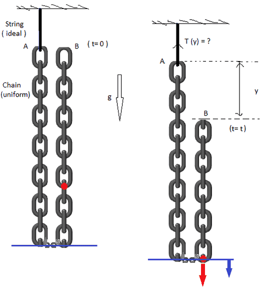

It's important to distinguish between the downward velocity of a point of the right side of the chain and the downward velocity of the lowest point of the string. Specifically, consider a red dot painted on one of the links on the right side. Also, consider a blue horizontal line that moves down so that it is always level with the lowest point of the chain. Note that the red dot will catch up to the blue line.

I think you are right that all points on the right portion of the chain have the same free-fall acceleration, g. Once a link on the right side catches up to the blue line, it is abruptly brought to rest.

It depends what you mean by the speed of the bottom of the right hand section of chain.
An individual link approaching the bottom moves at the same speed as the top of the section, gt, or √(2gy). The locus of "the bottom of the chain" descends at half that speed. Consequently the transference from right to left is also at the half speed.
It's a bit like rolling contact of a wheel. The locus of the point of contact moves with the same velocity as the centre of the wheel, but the part of the wheel instantaneously at the point of contact is stationary.

I would say that that the speed of the differential element (red dot) just before it is brought to rest is equal to the speed of the top element of the right segment at that instant. But you also need to consider how much mass is brought to rest per unit time if you are trying to get the force.

The links in the left segment are at rest. When a link in the right segment becomes part of the left segment, it comes to rest.

Suppose at some time the top of the right section is descending at speed v. In time dt, the top of the right section descends vdt. The length of the right section reduces by vdt/2. The length of the left section grows by vdt/2. A length vdt/2 is transferred from the right to the left; in doing so it goes from descending at speed v to being stationary. Its change in momentum is (λvdt/2)v=λv2dt/2.

No, the speed of the red dot just before it comes to rest is the same as the speed of the top end of the right segment. This speed is the speed obtained by free falling a distance y.
