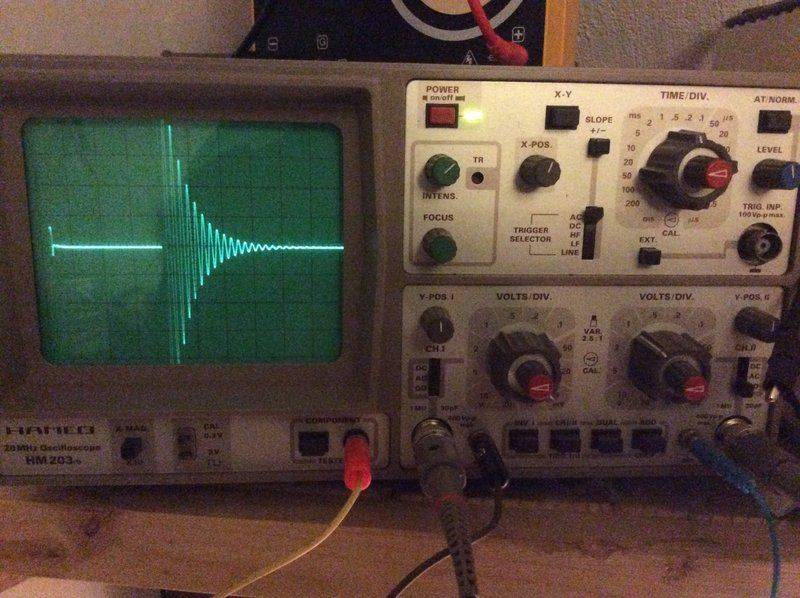

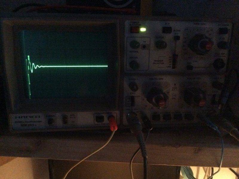

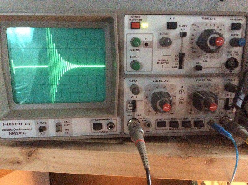

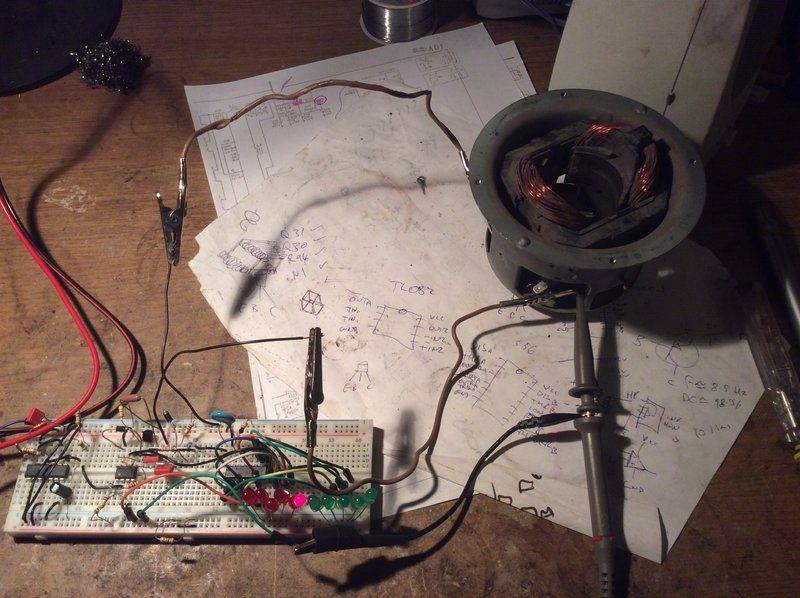

Or... maybe I could feed pulsed DC into the coil and count the ringing on my scope?
Guineafowl said:
Looks exactly what I need.
Now THAT's interesting.
Please pardon the following ramble. Old guys just do that.I once devised an inductor test that seemed to work
but it gave results comparable to a much easier to use computerized inductance meter we already had in the shop.
I mention it because it's sort of similar to your "Ringing" test.
I established about an amp DC through the coil
then interrupted it and captured the 'inductive kick" in a capacitor trapping it there with a rectifier..
Connected to the capacitor i had a Fluke DMM set for peak capture.
I sized the capacitor for about a hundred volts on the coils i was measuring.
It would find coils with shorted turns but so did the little computerized inductance tester .

So I'm thinking- since you have a 'scope - and we can now buy Hall flux sensors reasonably
One of these glued to a popsicle stick should detect flux:
http://www.ti.com/lit/ds/symlink/drv5053.pdf
And the most striking thing i noticed about my inductors was their phase shift when extra current flowed...
And since power tools have a laminated core, eddy currents should be low,
meaning more than a teeny bit of phase shift between measured current and measured flux should be a decent indicator of shorted turns.
I envision a source of line frequency AC current an amp or less, a current measuring resistor, and a Hall flux detector probe.
Readout could be either a 'scope, or an analog meter indicating phase shift in degrees.
Just squaring up and AND'ing two sines gives a PWM proportional to phase difference... a DC meter reporting average value of that PWM would work.
You'd soon either become skilled at its use or figure out what's wrong with the idea.
And if you said it worked i'd buy one.

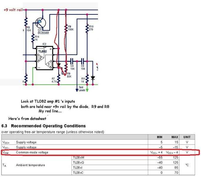

Here's my first thought. Usually my first thought turns out wrong, but here it is.
TL082 is operating outside its recommended range of input common mode voltage
snips from your schematic and TL082 datasheet
It's very confusing because later in datasheet (table 6.5) they show typical common mode range equal to V+ .
Note with just a 9 volt supply, recommended input range of (V- plus 4) to (V+ minus 4) is only between 4 volts and 5 volts. That circuit has it at 8.4 volts.
So i take that to mean some amps might work and others might not.
I'd try about 4K in series with that diode to bias the inputs close to mid supply, and reduce R9 tenfold to bring them closer together.
Then see if it counts more rings .
That'll show whether we understand that part of the circuit.
What do you think ?

Probably a good idea to add diode clamps from node R8-R9-C4 to V+ and V- , to protect TL082's inputs from the inductors
old jim

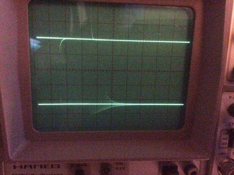

Ignition coil secondary (good, I think). Reading: 1 ring
Field coil of vacuum cleaner motor (good). Reading: 4 rings.
Small wall adapter SMPS transformer primary (good). Reading: 9 Rings.I also held the test leads like brushes across the rotor commutator, and turned. Each rotor coil gave a reading of 4 or 5.
So as you see, it's more useful than I thought. What I really need is some known good and known shorted coils of the same type to calibrate it. I played around as you suggested with the TL082 voltages, managed to reduce them but couldn't get any decent ringing off the ign coil.
I suspect the failure of the ign coil to ring is something to do with either the sheer size or the fact that the negative side is common to primary and secondary.
I did try connecting a neon and 33k resistor in parallel with the coil secondary, then touching 6V to the windings. As I disconnected, the neon flashed briefly. Crude, but effective? No good for the primary, though.
My inductance meter, however, gives a reliable reading of -30.6 uH for the ign primary and 30.0 uH for the SMPS secondary, both of which didn't read well on the ringer. Not sure why the minus sign but it may serves as a benchmark for others. Perhaps, amongst the eBay devices, breadboard builds and my Heath-Robinson approach I have all I need to test any coil?!
Likes Asymptotic

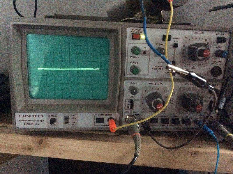

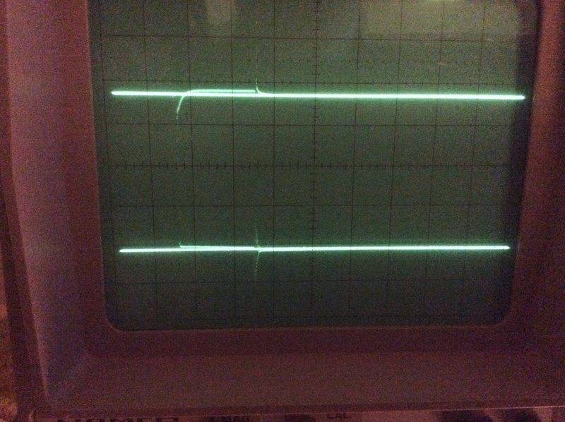

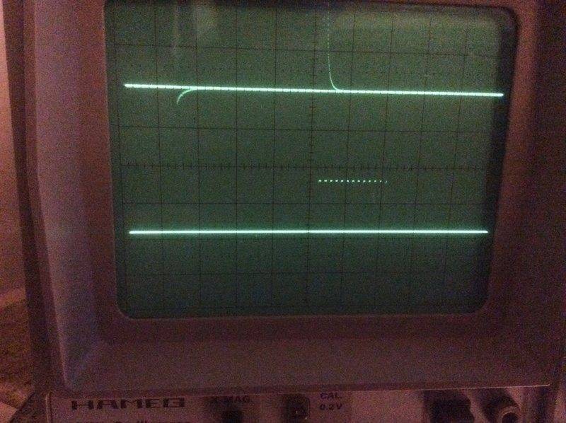

Last one: Current-voltage characteristic curve for the ign coil secondary, using the scope's component tester. Horizontal line is open circuit, vertical is short. The very slight upward angle suggests high resistance, the looping a phase shift (?).
I wonder if your ignition coil has shorted turns in secondary. How does its primary ringdown look ?
Can you perhaps get a junk one from an old lawnmower or weedeater ?
Q of that one is mighty low. Great scope shots !
Ignition coil primary lissajous will be interesting. The more circular the higher the ratio X/R
Those secondaries are tiny wire because the sparkplug current is small. That might explain low Q. Primary on other hand has to handle a few amps.Interesting work you're doing here !
old jim
Q of that one is mighty low.Great scope shots !
old jim

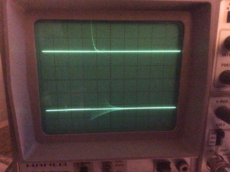

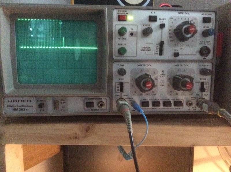

Ign coil primary - a score of 2 on the ringer.
Scope Lissajous is a near-vertical line, as for a short, but shorting the leads 'twitches' the line slightly thinner, so there is a slight circularity.
The coil was a cheap one I bought online for use with my homemade electric fence energiser. It's done lengthy service sitting in the chicken house, pulsing away open-circuit (very seldom did it get a 'fox' path to ground). It could well have some damage.
Likes jim hardy

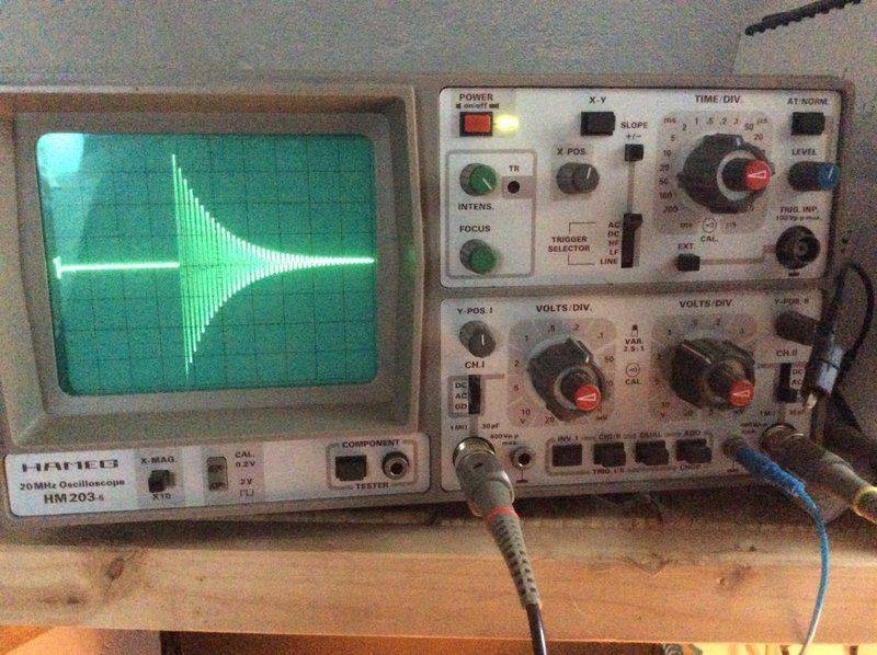

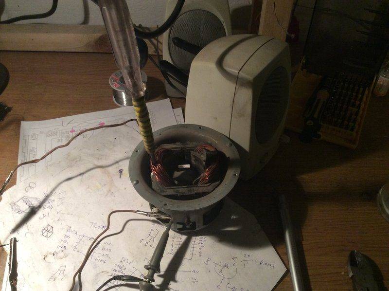

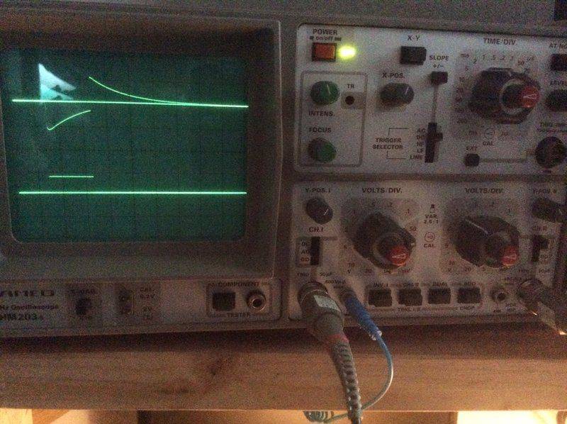

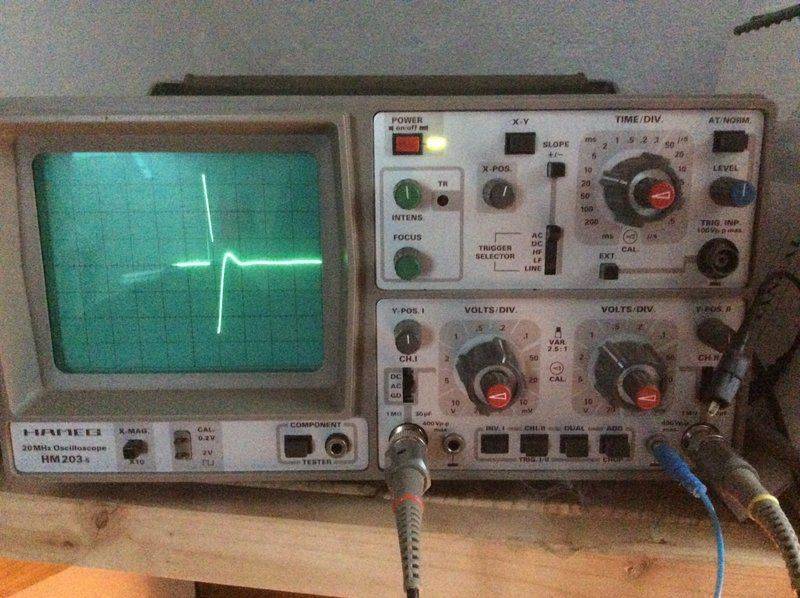

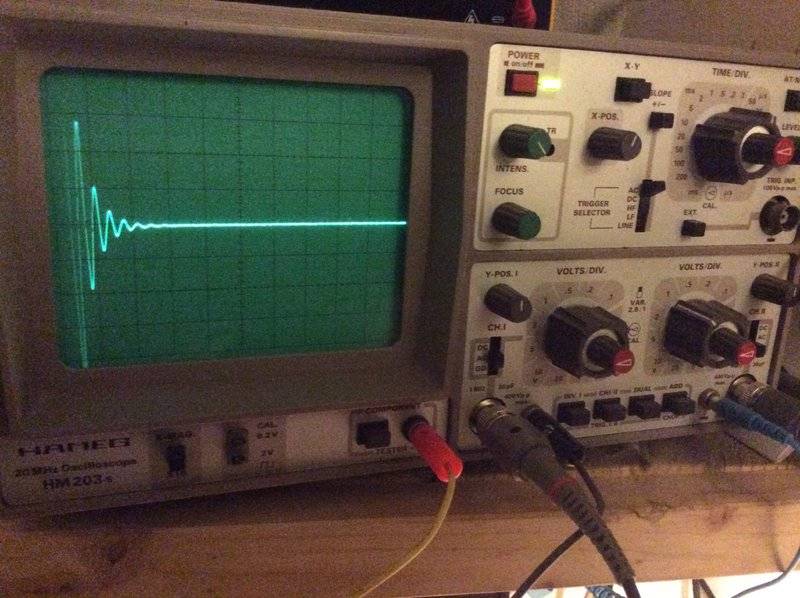

Vacuum cleaner motor field coil ringing pattern again. Scope timebase 0.5 ms/div.
Test rig - note ringing score of four (First LED is zero).

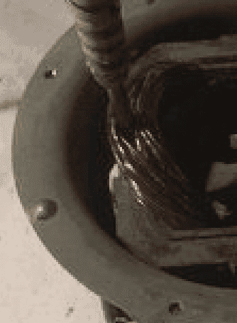

Ringing now damped to a score of 1. Scope timebase advanced to 0.1 ms/div.
The culprit!It's fun as a toy AND it can test stuff. What more could you want?
Well now ,,,, There's an epiphany !
Shorted turn by driving a screwdriver into the coil ?
If i read your 'scope right
Made it decay in just a couple cycles, tightening up the decay severalfold
and frequency went from 9 peaks in 1 msec = 9khz to 5 peaks in 0.2 msec = 25khz?
Your gizmo looks like quite a handy addition to a small motor guy's toolbox. One would quickly learn what to expect.
Congratulations, and thanks for the lesson !
old jim
Likes Guineafowl

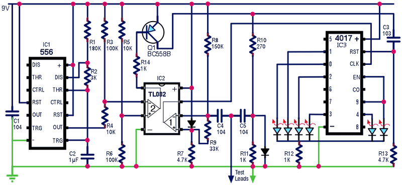

Here is the circuit again, for reference:

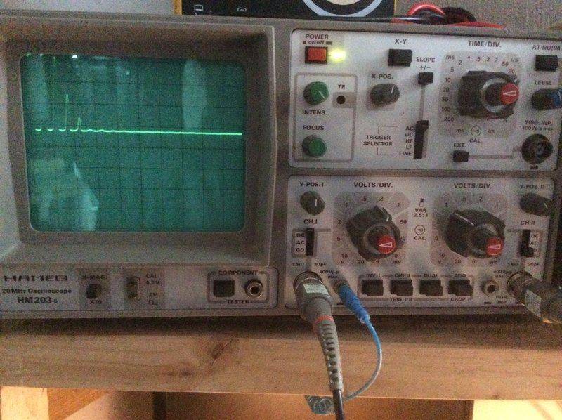

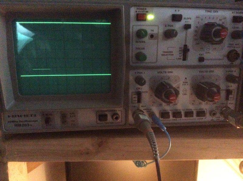

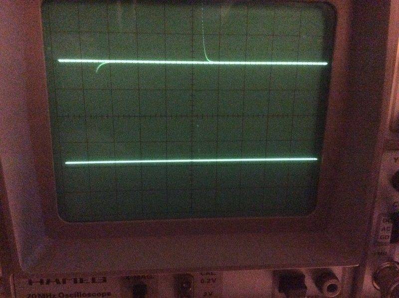

Measuring at the clock input pin, here is the trace from the SMPS primary, which measure 10 rings:
0.2 V/div x10
0.2 ms/div
Ringing frequency is 6.25 kHz. Pulse height 6.2V + 1.6V offset. Pulse width 30 us.

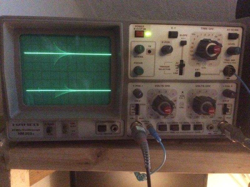

Again, measuring at the clock input pin, here is the trace from the SMPS secondary, which measures 1 ring:
0.2 V/div x10
20 us/div
Ringing frequency 83.3 kHz. Pulse height 7V + 1.6V offset.
Now, 3-4 good rings are clearly visible for the secondary, But the 4017 is not counting them. The frequency (83.3 kHz) is well within the bandwidth of the 4017 (10 MHz) and the pulse width (5 us) is too (min 45 ns). The pulse height is comparable to the primary result (in fact, they are both clipped at the top of the screen). This does not seem to be a signal amplification problem - why is the 4017 not counting the secondary rings?
What's pin marked "EN" ?
I don't see such a pin in the datasheet.
http://www.ti.com/lit/ds/symlink/cd4017b.pdf
If it's "Clock Inhibit" it can block counting.
i'd give that LED its own pulldown resistor. The LED's should each have their own pulldown anyway.
I think it's the clock inhibit, as you say. If pulled low, it enables clocking. I've only provided one common 1k resistor for all the LEDs, since they're only lit one at a time. I'll have a scope of that pin if I get time tomorrow.
Likes jim hardy
Oooops my bad - i assumed this was an old fashioned binary output...
You're right you only need one..
Thanks !

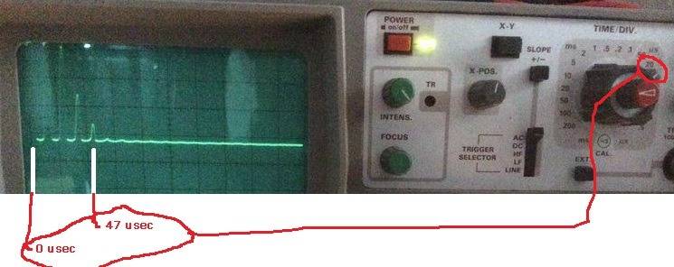

  • #32

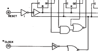

Check your RESET pin with 'scope ?
C3 and R13 values...
10,000 pf(103?) and 4.7 K ohms is 47 microsecond time constant, by which time your ringdown is finished.
So maybe it misses the show while waiting for end of RESET ?
  • #33
The 4017 datasheet shows the VIH Min. as 70% of VCC. With 9V Vcc the Clk must exceed 6.3V to be recognized. The scope trace shows the second pulse to about at that limit.
Conclusion: You're going to need more gain to capture that signal.
See pg. 3 of: http://www.ti.com/lit/ds/symlink/cd4017b.pdf
Likes Guineafowl and jim hardy
  • #34
And VIL below about 30% (to be recognized low. )
Dont know if that applies to Reset which doesn't have the Schmitt trigger like CLOCK does
but just looking at datasheet and your circuit, i'd say it's plausible
that exponential decaying voltage on reset pin holds counter in RESET for as much as 50 microseconds .
Use second channel on scope to see how long before it starts counting ?
ch 1 on clock, trigger from there,
ch 2 on "1" digit to show first count ?
old jim
If the right-hand op-amp is in open-loop, do I just need a higher OLG op amp?
Or is the problem that the TL082 doesn't swing close enough to the +ve rail? If so, which characteristic on the datasheet details better rail-to-rail figures?
