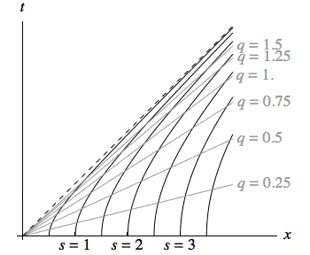

  • #105
A-wal said:
It it happens in one system, it should happen in all of them, it will just look different. Reaching the event horizon is exactly like accelerating to a relative velocity of c. It can't happen, surely. Am I wrong yet?
Instead of talking about the event horizon of a black hole let's talk about the event horizon in Rindler coordinates. Does the event of an inertial observer crossing the event horizon happen in an inertial frame? Does it happen in the Rindler coordinates?

Actually, no. Some coordinates do not cover all of spacetime. The Rindler coordinates and Schwarzschild coordinates share the fact that there are some events in their respective spacetimes which are outside of the coordinate system. For example, what is the Schwarzschild coordinate of something halfway between the event horizon and the singularity?

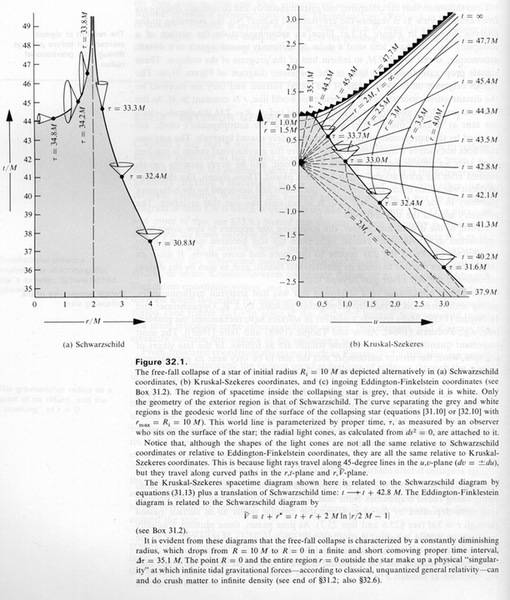

I'm liking the Schwarzschild one more and more. It says an object can't cross the horizon judging by what you just said, correct? How can an object reach the horizon when it would be infinitely time dilated from any other frame?
  • #109
It would only be infinite time dilated for an object at rest in the Schwarzschild coordinates. For a free-falling observer the time dilation is finite.

That's paradoxical! In one it does and in the other it doesn't. How can two different coordinate systems that give two different outcomes both be right? What if someone at rest in Schwarzschild coordinates waited till the end of the black holes life? What would someone who was falling in see when looking at a more distant object? You're saying the situation is non equivalent to looking at a closer object? That doesn't make sense!
I'm not giving up until I've got this straight in my head.
  • #111
There is no outcome which is disagreed-upon by different coordinate systems. The difference is not the coordinate systems, it is the motion of the observer. A free falling observer detects a finite redshift in any coordinate system and an accelerating observer (stationary in Schwarzschild coordinates) detects an infinite redshift in any coordinate system.

Apparently the Rindler coordinates are to show the relativistic effects of an object under acceleration. Like the fact that the back of the object has to accelerate faster than the front from the perspective of a non-accelerating observer because of length contraction. And apparently this can also be used to show the effects of curved space-time instead of acceleration, which makes sense because they're the same thing. An event horizon appears that the accelerating object can't reach for an observer using these coordinates, so an event horizon that can't be reached is created when applied to curved space-time as well.
I can't see any self-consistent way of resolving this without the event horizon receding as it's approached. A distant observer would see the in-falling object undergo length contraction and time dilation as it approaches and it would reach infinity at the horizon, so it can never get there, and conversely the object itself would observe the rest of the universe speeding up as it got closer, becoming infinitely reverse time dilated at the event horizon, again meaning it can never actually get there.
I'm assuming that I'm going wrong when I switch it round and look at it from the perspective of the in-falling observer. So I need to understand how the situation can be both non-symmetric and self-consistent at the same time (without moving the goal posts).
Essentially correct. I wouldn't say that the horizon cannot be reached, I would say that it cannot be reached in a finite amount of coordinate time. You can reach it in a finite amount of proper time simply by falling.

Why? Suppose you have an ordinary inertial coordinate system to describe your movements today, and at t=10350 seconds you step outside of your house. Now, let's transform your movements into a different non-inertial coordinate system:
x' = x
y'=y
z'=z
t' = t^2/(t-10350)
In this coordinate system, no finite time can be assigned to the event of your stepping outside the house. But that doesn't mean it can't be used to label events that happen to you after you step outside, say at t=10400 seconds in the original inertial coordinate system.

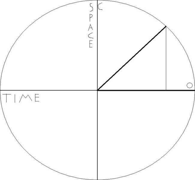

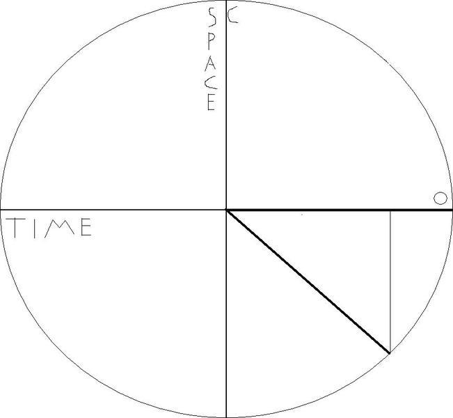

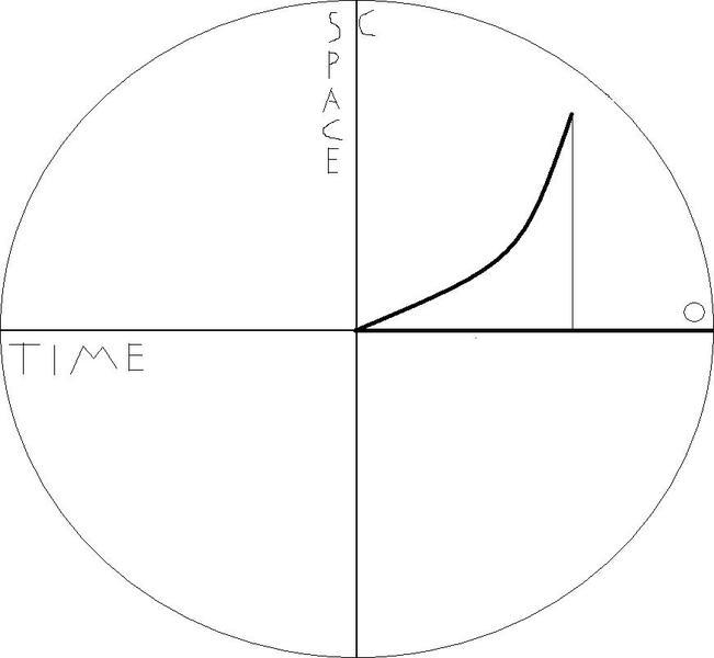

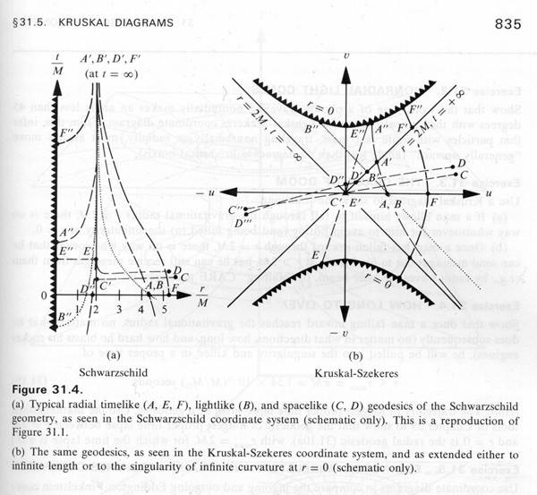

Rather than thinking of it as a singularity in the middle surrounded by the black hole I think it makes a lot more sense to see it as one thing. The singularity appears to get stretched in time and space the further away you are from it.
Figure 1: This is what I meant by using right angles for c and the event horizon. I haven't checked if this works but there's no reason why it shouldn't.
Figure 2: You can see that at half the speed of light (45 degrees) time dilation and length contraction are between a quarter and a third, ish. It's frame independent because from the other ones perspective you get this.
Figure 3: To represent acceleration you use a curved line.
To see it from the accelerators point of view you would need a sphere. An inertial observer would be moving round the edge while an accelerator could take a short cut through the sphere.

  • #148
JesseM said:
No you wouldn't. At every moment in Schwarzschild coordinates they are moving towards the horizon, but at a slower and slower and slower rate; the same is true of your signal. The way the speed of the falling observer and the speed of the signal slow down with time, it works out that there is always some finite distance between the signal and the observer in Schwarzschild coordinates (again assuming the signal was emitted at some time when the falling observer was already close enough to the horizon that all coordinate systems agree the signal can't catch up to the observer at any time before he reaches the horizon)
I assure you that this is what would happen in Schwarzschild coordinates if you sent a signal too late to catch up with the falling object; both would travel more and more slowly as they approached the horizon, but the distance between them would never reach zero.
A-wal said:
because time dilation and length become more pronounced, not less over relatively shorter distances.
How do you think that's incompatible with what I just said? Time dilation in Schwarzschild coordinates does become more pronounced as you approach the horizon, which is why the signal travels slower and slower and never manages to catch up with the falling observer.
A-wal said:
The signal would never reach a frame where the object it's heading towards crosses the horizon.
I don't know what you mean by "reach a frame". We are analyzing the problem in a single frame, Schwarzschild coordinates--if you want to do something different please specify what frame or frames you want to use. In Schwarzschild coordinates, it's true that the object never crosses the horizon, but its speed also never reaches exactly zero so it's always getting slightly closer, and meanwhile the speed of the signal is continually decreasing too, in such a way that it never quite catches up to the object at any time in Schwarzschild coordinates (again assuming the signal was sent out too late).

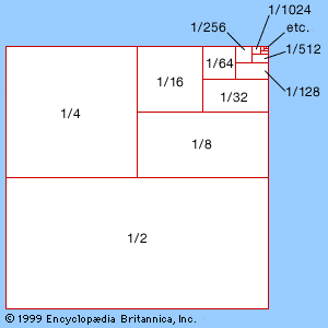

Are you familiar with the idea that the infinite geometric series 1/2 + 1/4 + 1/8 + 1/16 + 1/32 + ... 1/2^N + ... will never quite reach a sum of 1, although it gets ever closer to it? You can get an idea of why this is the case from looking at this image:
Anyway, the point is that in Schwarzschild coordinates, both the falling observer and the signal approach the horizon in a way that resembles this--each second the distance they travel is smaller than the distance they traveled in the previous second, in such a way that their position never quite reaches the position of the horizon, no matter how many seconds we count. And for a signal sent out too late to catch up to the falling observer, it would also be true that the distance between them is continually closing but it never quite reaches zero--if the gap between the signal and the falling observer is 1 at some time (in whatever units you want to use), then at some later time the distance is only 1 - 1/2, at a later time it's 1 - (1/2 + 1/4), at a later time it's 1 - (1/2 + 1/4 + 1/8), and so forth.
A-wal said:
You can never see an object reach the horizon no matter how close you get in the same way as in SR one observers view of another's time never actually freezes, because c can't be reached.
That's true.
A-wal said:
Actually the signal example doesn't work because it would always travel away at c locally, so you couldn't follow it.
It doesn't "always travel at c locally" in Schwarzschild coordinates! In Schwarzschild coordinates the speed of the signal continually decreases as it approaches the horizon. Light only travels at c in a locally inertial coordinate system, but such coordinate systems have an infinitesimal size in GR so they can't be used to define the distance between two things at different points in curved spacetime, like the falling object and the signal.
A-wal said:
We'll just use another observer heading in behind but with more inertia. The one behind will have to catch up before the horizon is reached and that's regardless of the distance between them to start with because there is no external frame in which it the closer observer crosses the horizon, so it can't ever be too late.
Nope, doesn't work that way. If both observers are sent from the same radius, then whichever had a larger initial speed in Schwarzschild coordinates will necessarily be decelerating at a greater rate in Schwarzschild coordinates, i.e. its speed in these coordinates is dropping more quickly (and the same is true for light, its speed drops more quickly as it approaches the horizon than massive falling objects). This may help understand why the one sent out later can avoid ever catching up to the one sent out earlier even if the one sent out later had a greater initial speed.
Anyway, remember anything you say about what happens to two objects (or an object and a light signal) approaching the black hole horizon in Schwarzschild coordinates can also be said of two objects approaching the Rindler horizon in Rindler coordinates. Do you understand that in Rindler coordinates, observers moving towards the horizon who have constant speed in inertial coordinates will instead have constantly decreasing speed in Rindler coordinates, and will never quite reach the Rindler horizon at any finite Rindler time? Do you think this means it is always possible in Rindler coordinates for a second object to catch up with one sent towards the horizon earlier, regardless of how much later the second is sent? After all you can always give the second object a greater initial speed in Rindler coordinates...
A-wal said:
It's different with SR because there's no contradiction with inertial frames.
But I'm not talking about comparing inertial frames, I'm talking about comparing the Rindler coordinate frame (a non-inertial coordinate system) with inertial frames. This diagram was showing what lines of constant position and time in Rindler coordinates look like when graphed in an inertial frame:
The black hyperbolas labeled s=1, s=2 etc. represent lines of constant position in Rindler coordinates, the gray angled lines labeled q=0.25, q=0.5 etc. represent lines of constant time in Rindler coordinates. So if you have a series of events at known coordinates in the inertial frame, you could use this diagram to figure out their approximate s and q value (or use the coordinate transformation to get more accurate values), then a diagram from the perspective of Rindler coordinates would be one where all the s-lines of constant position are just vertical lines, while all the q-lines of constant time are just horizontal lines, forming a nice grid. Then if you plot a series of events on the worldline of an object which crossed the Rindler horizon at some finite time in the inertial frame, in the Rindler graph the object would seem to move slower and slower as it approached the horizon, never quite reaching it at any finite Rindler time-coordinate.
A-wal said:
In the case of a black hole you've got an event horizon that can't be crossed unless you yourself cross it.
Same is true of the Rindler horizon--regardless of whether you plot it in inertial coordinates or Rindler coordinates, you can see that no one who remains outside the horizon (like the accelerating observers who have a constant position in Rindler coordinates) will ever get a signal from any event on or beyond the horizon, the only way to see these events is to cross the horizon yourself.
So again--what's the difference? Maybe with my additional explanations, you can finally see that there is no difference, that the way the same events are viewed in Rindler coordinates vs. inertial coordinates exactly mirrors the way the same events are viewed in Schwarzschild coordinates vs. Kruskal-Szkeres coordinates?
I don't understand these diagrams at all, you need to give more explanation. Where is the event horizon? What does the circle represent? What does the thick black line parallel to the time axis represent? What does the second thick black line at an angle relative to the first (or the thick black curve in the third diagram) represent? Do you think this is how events near a black hole would work in some coordinate system defined in the right way, or are the diagrams supposed to show something frame-independent?

Now, about those diagrams. I came up with this when it occurred to me that all objects are only separated from each other by two dimensions because you can always draw a straight one dimensional line between any two objects. The thick black horizontal line represents an inertial observer. You're always horizontal because you're always static in space and moving through time at c. The length of the lines represent proper time. The thick diagonal line represents a second observer in a different inertial frame, but from the perspective of the first observer. The angle of the diagonal line comes from its speed relative to c, so .5c is 45 degrees. Draw a line down from the end of the diagonal line to the horizontal line to see how time dilated/length contracted the second observer is from your perspective. It's frame-independent without acceleration because you can move the diagonal line so that it's horizontal and the other observers world line is now diagonal (diagram 2). The third diagram represent an inertial observers perspective of an accelerating observer.
Forget what I said about using a sphere because there is no speed limit from the perspective of an accelerator. It doesn't work because you could reach any object in the universe as quickly as you like in proper time if you could stand the g force because length contraction/time dilation would bring the object to you. Maybe warping the circle into a oblong would do the trick.
Anyway this wasn't why I originally posted. There was a reason I named this thread The Arrow Of Time. I had an idea about what happens inside the event horizon that ties into those diagrams. I just didn't understand how an object could reach the horizon in the first place. This is extremely simple and to me it makes perfect sense. Inside the horizon time moves backwards. At the singularity no time has passed at all since the formation of the black hole. So any object entering the horizon would be pulled back through time to the exact moment in time and space that the black hole formed where it pass through the eye of a metaphorical needle and be converted into the simplest form of energy, which is why the formation of black holes is always proceeded by a gamma ray burst. The only information to survive the black hole is matters value, so no paradoxes. Obviously the value of the gamma rays would have to match the value of all the matter that falls in over the black holes life span. I tend to think of time as coming from the expansion of the universe with matter slowing it down. In the case of a black hole the universe is locally contracting making time move backwards. I may be getting very carried away with this bit but maybe the black hole actually reduces in mass when matter enters it until the same value of matter has gone in as the value of the energy that originally came out (as it's the same stuff), would would kind of go along with the whole working in reverse thing.
  • #150
Got it! To do it from the accelerators point of view you would need to make the circle smaller or bigger, as in less than or more than (overlap) 360 degrees, depending on whether you were accelerating or decelerating relative to the other one.
