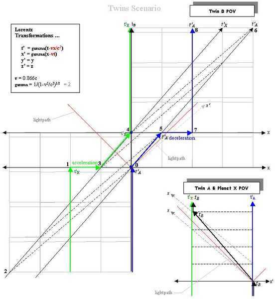

I'm not sure how else to communicate it. I tweeked an old illustration and posted it, and provided a narrative description of it. The debates here have been over side-issues, mainly semantics, and not my specific point at hand.
At one point or another here, I think everyone has agreed that I consider ... twin B's experience during non-inertial motion is the "collective equivalent" of an infinite number of contiguous corresponding inertial frames-of-reference of which twin B momentarily occupies. I do not see this as the frankenstein-force-fit description, as DaleSpam suggested prior. IMO, twin B's POV "actually is" the very same as said collective equivalent. However, twin B must sum the LT solutions for each of those infitesimal segments considered (over the interval), and this summing is what allows the LTs that were designed for the all-inertial case to apply to the non-inertial POV.

DaleSpam said:
What is "instantaneous slope" if not "change in position over duration". You are contradicting yourself.
For reference ...
https://www.physicsforums.com/attachm...2&d=1299884366"​
DaleSpam,
Look at the illustration in the link above. If we are to assume that velocity is nothing more than the change of position over time, then twin A moves superluminally from point 1 to point 3 thru B-space during B's own virtually-instant proper acceleration. Clearly, this velocity cannot be used in LTs, and for good reason. I don't see this as overly complicated, personally.
My position is that the slope of the A-worldline dictates A's current velocity wrt B per B, far as "what velocity B should use in the LTs" goes. If you imagine a uniform almost-virtually-instant twin B proper acceleration, it's quite easy to envision how the A-worldline progresses from vertical to the slope of 0.866c, never exceeding 0.866c, let alone c.
Now you assume I am contradicting myself. However, there are 2 processes occurring wrt the A-worldline (per B) as B accelerates ...
(1) The A-worldline rotates steadily from vertical to a slope indicative of 0.866c, never exceeding 0.866c.
(2) The intersection of "the A-worldine and B-line-of-simultaneity" moves thru B-space, and can be superluminal.​
Now if the velocity is to be determined by the receipt of light signals, and doppler shifts converted into their appropriate dilation equivalent, then superluminal motion is never detected. The established velocity will match the current slope of the A-worldline per B. The reason this works out as such, is because events move in space and time per B during his acceleration, something that does not happen classically. One such event would be the location of the A-clock upon commencement of B acceleration, ie twin B's departure event from twin A. As twin B accelerates, said event drops further and further back in B time, and further and futher away in B-space, per B. This keeps the worldline slope at sub-c, which in my illustration never exceeds 0.866c even though A must move thru B-space superluminally (if velocity is determined in the classical way change in position over time).
GrayGhost

GrayGhost said:
For reference ...
DaleSpam,
The link doesn't work.
Ahhh, a Cut-N-Paste problem there. Here's a repost with th correct web address ...
For reference ...
DaleSpam,
Exactly. And again, it is not an assumption, it is a definition. If you wish to re-define velocity then you may, but you need to be completely specific about it.
Your point (1) is clearly not true in your diagram. The slope of the A worldline clearly exceeds 0.866c, or even c. Regarding (2) "the intersection of the A-worldline and the B-line-of-simultaneity" is just a long-winded way of saying the position of A in the B frame. The velocity of A in the B frame is by definition the derivative of this. Again, if you wish to redefine velocity you will have to be very specific. More math less english. Even if B's acceleration is finite this can lead to v>c.
Yes, that is the Dolby and Gull approach, not the naive/CADO approach.
What does this mean? What is the formula that describes this "motion of events"?
I think perhaps this is the key thing that you need to define, then you could possibly define your new concept of velocity as some sort of motion in addition to or relative to this motion of events. But you really need to be clear and mathematically precise here if you want to ensure a self-consistent outcome.
Honestly, rather than patching up such a strange ad-hoc concept, I think you would be much better served actually learning some differential geometry. But if you do want to pursue this the place to start seems to be this concept of the motion of events. Start by expressing that mathematically.
Dale Dale DaleSpam. It's quite interesting you know. The theory demands that no material body can accelerate to speed c, because of energy considerations. Add, speed c represents a cosmic speed limit. Yet per twin B, twin A could move superluminally thru B-space. So what does it all mean? Hmmm.
Conceptually, it's quite clear in my mind, personally. Events move in B-space per B while B continues his own proper acceleration. Such an event is the B-departure-from-A. This is what keeps the velocity < 0.866c in my example (let alone < c), even though A moves superluminally per B from a standpoint of the-change-in-position-over-time.
You know ... this reminds me of the problem whereby many folks remain stuck, because they generally tend to ignore the time dilation while focusing only on spatial changes. Neither can be ignored, and they always exist in unison. In this case, IMO, twin A moves superluminally (per B) only if B focuses only on the spatial contraction while ignoring the time dilation component altogether. If the time dilation component is not ignored, then the cosmic speed limit is not violated. Add, it's referred to as time dilation ... however really, its a dilation of spacetime.
Indeed, what needs to be done is to math-model the twin B experience as the-collection-of-momentary-colocated-inertial-frames-of-reference that B co-occupies. Yes, differential geometry should get the job done. I haven't seen it anywhere, but I find it very difficult to believe no one has done this as yet. Now, Mike Fontenot believes he has done this. Where Mike simply states that twin B cannot use his own recorded A-velocity in the LTs (he must use an A-framer's recorded v), I merely made the attempt to explain WHY twin B must do so, and why it works. Wrt that matter, I figure I'm saying the same fundamental thing as Mike, but I'm not sure he realizes it yet.
Also, I never looked at it as though I was changing the definition of relative velocity. However, maybe I am now that you mention it? I suppose it'd be a rather presumptuous thing to do, assuming it hasn't yet been done. As I said though, I doubt I'm the first to suggest this, and I'd be very very surprised if no one has modeled it as yet. It's not a change to the classical velocity definition far as non-luminal speeds go ... it applies only to the case of luminal (and superluminal) motion from a non-inertial POV, in the relativistic case.
Wrt another comment you made ... it seems to me that if the Dolby and Gull approach converts doppler shift to the appropriate spatial offset, it should be equivalent to what I've been saying. Yes? I mean, the relativistic doppler shift is the result of dilation in space and time both, so said conversion must account for both the time component and the space component.
GrayGhost
