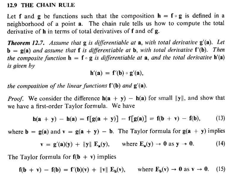

I am reading Tom M Apostol's book "Mathematical Analysis" (Second Edition) ...
I am focused on Chapter 12: Multivariable Differential Calculus ... and in particular on Section 12.9: The Chain Rule ... ...
I need help in order to fully understand Theorem 12.7, Section 12.9 ...
Theorem 12.7 (including its proof) reads as follows:
Page from a textbook titled 12.9 The Chain Rule, stating Theorem 12.7 and its proof with numbered equations (13) to (15) for the total derivative of a composition h = f∘g.
Typeset proof page from a multivariable calculus text defining E(y) via equations (16) and (17) and showing the norm ratio remains bounded as y tends to 0.

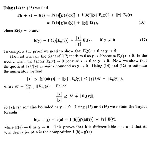

In the proof of Theorem 12.7 we read the following:
" ... ... Using (14) in (15) we find
##f(b+v) - f(b) = f'(b) [ g'(a) (y) ] + f'(b) [ \| y \| E_a(y) ] + \|v \| E_b(v)####= f'(b) [ g'(a) (y) ] + \| y \| E(y)## ... ... ... (16)Where ##E(0) = 0## and##E(y) = f'(b) [ E_a(y) ] + \frac{ \| v \| }{ \| y \| } E_b (v) \ \ \ \ \text{ if } y\neq 0## ... ... ... (17)... ... ... "
*** EDIT ***
It now occurs to me that in fact Apostol is defining E(y) in equations (16) and (17)
I should have seen this earlier ...
Peter
================================================================My questions are as follows:Question 1
Can someone show how Equation (16) follows ... that is ...
... how exactly does ##f(b+v) - f(b) = f'(b) [ g'(a) (y) ] + \| y \| E(y)##
follow from
##f(b+v) - f(b) = f'(b) [ g'(a) (y) ] + f'(b) [ \| y \| E_a(y) ] + \|v \| E_b(v)##?
Question 2
What is ##E## ... I know what ##E_a## and ##E_b## are ... but what is ##E##?
Similarly ... what is ##E(y)## in (16) and in (17) ... shouldn't it be ##E_a(y)## ... ?
Further ... why (formally and rigorously) does ##E(0) = 0##
Question 3
Can someone please demonstrate how/why
##E(y) = f'(b) [ E_a(y) ] + \frac{ \| v \| }{ \| y \| } E_b (v)##
Help will be appreciated ...
Peter

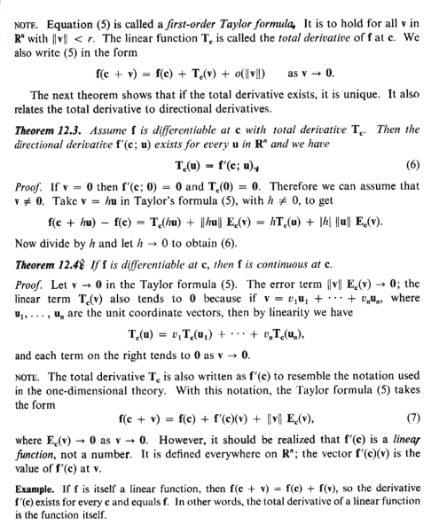

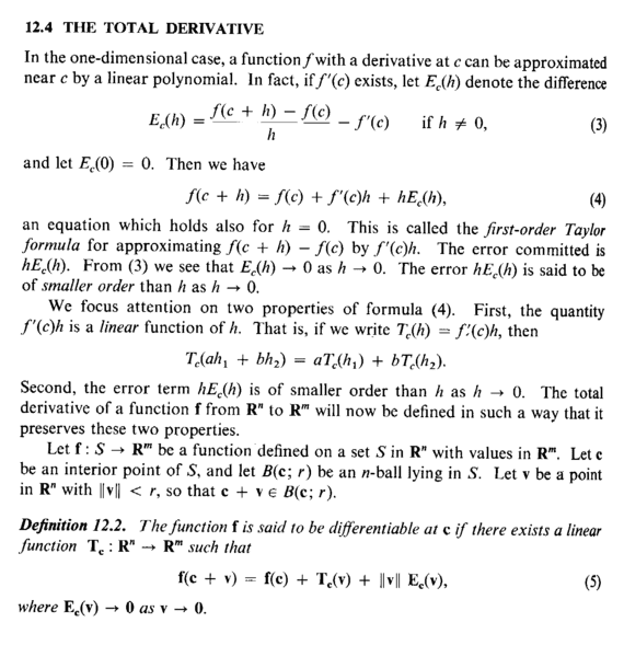

It may help Physics Forum readers of the above post to have access to Apostol's section on the Total Derivative ... so I am providing the same ... as follows:
Page from a textbook titled 12.4 THE TOTAL DERIVATIVE, showing definitions of E_c(h) with equations (3) and (4), the first-order Taylor formula, and Definition 12.2 of differentiability at c with equation (5).
Printed textbook page with a NOTE on the first-order Taylor formula, Theorem 12.3 and Theorem 12.4 with proofs, and equations (5) to (7) on total derivatives.
Hope that helps ...
Peter

Math Amateur said:
*** EDIT ***
Peter
Which of the following questions does this answer already?
Question 1
follow from
I guess this is the question you answered yourself: ##E(y)## is defined in (17) such that this follows.
Question 2
The general formula for differentiation in direction ##v## goes: ##f\,'(a) \cdot v = f(a+v)-f(a)+r(v)## with a remainder function ##r()## that has to obey ##\lim_{v \to 0} \dfrac{r(v)}{||v||} = 0##. ##E()## is the remainder we get from our formulas. Now we have to show, that the limit condition is obeyed.
No. (17) is what defines ##E(y)##, and it depends on both evaluation points. But since ##b=g(a)##, in the end it depends on ##a## alone. But we do not write ##E_a(y)## because we have to distinguish our new remainder function ##E()## from the earlier one ##E_a(y)##. They are two different functions, see (17).
We consider the general formula ##f\,'(a) \cdot v = f(a+v)-f(a)+r(v)## again. Now if ##v=0##, we have ##r(v)=0##. Applied to the differentiations of ##f(x)## and ##g(x)## in (14) and (15), this means ##r(0)=E_a(0)=0## resp. ##r(0)=E_b(0)=0##. So by (17) we have ##E(0)= \text{ sth. I }\cdot 0 + \text{ sth. II }\cdot 0##. Now if ##\text{ sth. II }## is bounded as ##y \to 0##, we have a continuous function ##E()## if we set ##E(0)=0##. Remember, that we defined ##E()## such that it fits our needs. So if the coefficient in (17) at ##E_b(0)## will remain finite if we set ##y=0##, then ##E(0)=0## is a continuous expansion of ##E()## at ##y=0##.
Question 3
We set it so. ##E(y) := \ldots##
