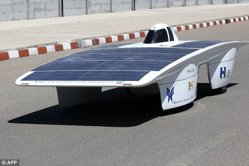

Asking about high-volume production costs of regular car chassis probably is not a good comparison to custom chassis design and fabrication in very low volume. You could look at the costs of custom race car chassis design and fabrication for a better comparison, maybe.
Also, have you looked at the light-weight chassis designs and fabrication that go into the solar car challenges? That is probably a lot closer to what you are working on...
http://funds.gfmcdn.com/8601175_1453830842.7134.jpg

Nope, unfortunately :(. We're going to design a car that's very similar to the normal ones actually I can say it will be a "real" car. The race inspectors are going to examine the car in terms of security as well, if they don't find it reliable we'll be disqualificated. So, almost everything that exist in regular car chassis should exists in our car (chassis legs, roll bars etc.)
Since it's an efficiency challenge, I thought, even though it's expensive, if the performance/cost is high, it worths to design it with carbon fiber.

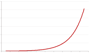

But to win your competition, you don't need the world's most efficient car. You need one only slightly better than the 2nd place competitor. That is challenging.
Wow! Actually I didn't expect that much ($100K). That would be impossible for us to afford this even though we're in search of sponsorship. But I agree with you, I imagine that the cost will increase with the efficiency desire. Since the chassis is the critical part for car in terms of weight, I'm responsible for it. I should keep it light and safe. Probably, Aluminum (or maybe steel) is the best choice.

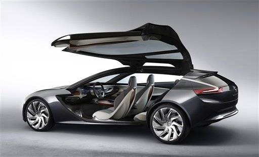

berkeman said:
Have you looked at current-day concept cars for ideas? Like the concept cars shown at the major auto shows...
https://3c1703fe8d.site.internapcdn.net/newman/gfx/news/hires/2013/8-hybridsconce.jpg
Yes, I've still looking at for some reference. I have a concern about how to model my sketches because even though I reach a final design on paper I have to model it so that it can be manufactured with metal or plastic sheets. How can I model that curves on the body?
