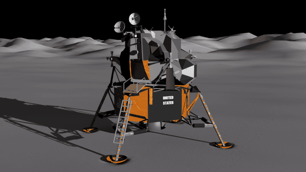

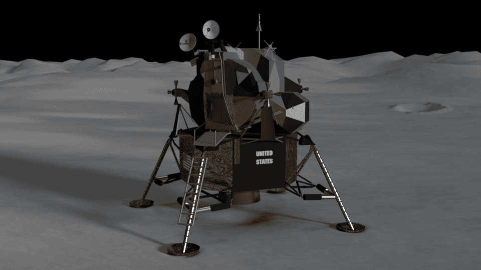

Here is a render done of the LEM on my old computer using Blender 2.78. This was done using the default Blender render engine.
3D render of a lunar lander model with gold foil and black panels on a grey, cratered Moon surface, with the words UNITED STATES on its side and a dark, star-free sky behind.
and this is it done using the "cycles" render engine. on the same machine.
Computer-rendered 3D model of a lunar lander on a grey, cratered moon surface under a black sky, with a visible 'UNITED STATES' label on its side and a ladder on one leg.
Better, but the rendering time went way up, so while this could still use improvement, It wasn't something I was too enthusiastic to go back and adjust.
3D render of a lunar lander model with gold foil legs and a ladder on a grey, cratered moon surface, with rocks and a black sky.

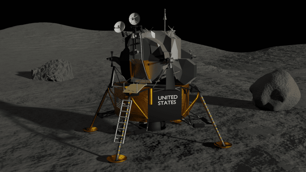

But with the new computer, I was able to modify the entire scene to this and with a full render time of only 10 min.
One note is that I changed the Moon's "landscape". With the old one, there where some subdivision issues that caused noticeable flaws in the new texturing/displacement I wanted to apply to it.

Fascinating change of shadow definitions in the three renditions.
The first image shows sharp delineations of the LEM's shadow on the lunar surface reminiscent of actual photographs. In the second image the shadows appear fuzzy, the lunar surface more 'snow' like, as if there was a brief dust cloud obscuring sunlight. The final rendition combines these effects with more perceived depth and a quite realistic surface beneath the LEM.
The boulders add historical as well as artistic, interest. Seem to remember Neil Armstrong manually redirecting the LEM to avoid boulders at the preferred landing site.
With the first render, the Render engine did not take into consideration the "size" of the light source.
With the second one, it did, leading to "softer" shadowing, but I used the "default" size for the "Sun" which lead to too much softening.
I tried to strike a balance in the third, by reducing the angular size of the Sun. Lighting is always a huge factor with renders, and sometimes it comes down to weighing realism against art.

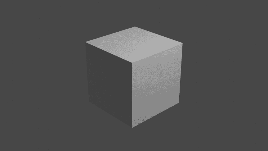

To explain what this does, we'll start with a simple cube
Plain grey 3D rendered cube viewed from above at an angle, against a dark grey background, with no visible subdivision or cloth deformation.
Though you can't see it here, this one has it sides divided up into 20x20 arrays of "faces". You need to subdivide the object up like this in order to give the cloth modifier something to work with in terms of deforming the cube. I also have already applied the cloth modifier, but again, you don't see this, as the cube has nothing to interact with.
If I were to add a collision plane below the cube, and then let the animation run a bit, the cube would collaspe onto the plane as if it were an empty cube shaped bag made of cloth.

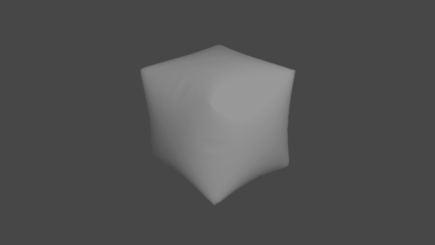

But the new option allows you to give the "bag" an internal "pressure", as if it were pumped full of air, and you can vary the value of this pressure.
So, if I take our cloth cube, and raise the pressure value up, you can get this:
Render of a soft grey cube with bulging, rounded faces against a dark grey background, as produced by a cloth simulation with internal pressure.
The cube bulges against the internal pressure (there are ways to make this better, such as starting with a cube that has rounded edges and corners ( even if just slightly), but this is just a simple example.
If I were to allow this object to fall onto the plane, it would give a bit, and maybe partially collapse (depending on the pressure value).

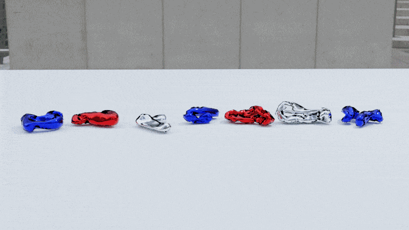

The first thing that occurred to me was suggested by the fact that the pressure setting can be controlled within an animation, which inspired me to try this:
Seven crumpled foil pieces in a row on a white surface, alternating blue, red and silver, in front of a grey wall.
Surprisingly, it didn't take a lot of time to get something that looked halfway decent.
The "balloon letters" were made by starting with a text object. Extruding it to make it 3 dimensional, then adding a rounded bevel to remove straight edges and corners.
Convert the text object into a mesh object (the cube we used earlier was also a mesh object). Apply a re-mesh modifier ( This more or less rearranges how the object's faces are arranged. This is important, because the assigned faces created in the text to mesh conversion would give really odd creases and folds in our "cloth". )
Create some "pin points". These are parts of the mesh that will remain fixed, and non-moving in the animation and act as "anchors" for our letters.
Assign the cloth modifier, with "pinning" enabled and your selected points assigned as pins.
Put a collision plane under the mesh.
Now, on to animating:
Make sure pressure is set to 0 in the cloth settings.
Let the animation run for a number of frames, to allow the cloth letters to settle down onto the plane.
Stop the animation. With pressure still at 0, you assign a "key frame" to the pressure value. ( this assures that the pressure value remains 0 up until this point. Move ahead in the animation by the amount of time over which you want the letters to inflate. Turn up the pressure value (I used 180) And set a new key frame. (between the last key frame and this one, the pressure value will ramp up from 0 to 180, 'inflating' the letters. )
Now, we need one more thing. Left like this, the letters will inflate, but they won't fully stand up. So I added a "wind" force field. This, as the name suggests, simulates a blowing wind. In this case, I orient it so that the wind blows upward. You set key frames up for it so that you have zero wind while our letters settle to the plane, and the the wind picks up when the letters inflate. The upward acting "wind" makes the letters stand upright.
Choosing the right pressure and wind values is by trial and error. Pick a setting, see how the animation behaves, adjust the value, see how it changes, ...
Now we just render the animation by selecting to only render those frames from just before inflation starts to somewhat after full inflation.
I did give the letters a metallic, Mylar like material, So I used a HDRI as the background to give them something varied to reflect.

Umm... Instead of collapsing, shouldn't that cube approximate a sphere as the internal pressure increases? Or was that external pressure that increase?
OK, with that nit picked, NEATO!
It is bulging at the sides. The pull in effect is due to the model trying to hold to a constant surface area. Imagine a line going all the way around the cube at the midpoint. If you try to reshape it as as circle without changing its perimeter, the corners will be drawn in towards the center.

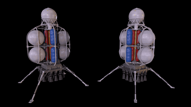

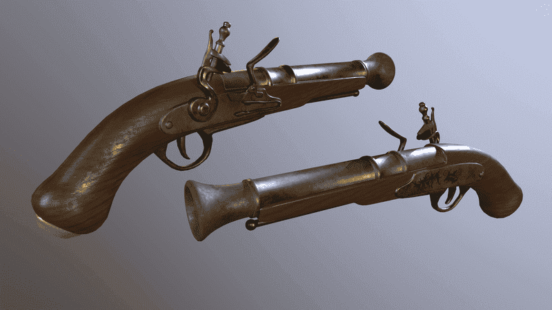

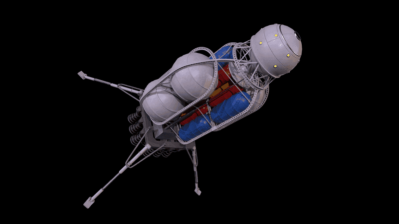

Just an example of what you can achieve with realtime rendering nowadays. With physically based materials and realtime raytracing, you can achieve some spectacular results.
  • Two rendered flintlock pistols on a grey gradient background: a larger one angled upward at top left, and a smaller one with a flared muzzle lower right, both with brass fittings and wood-grain stocks.
  • Two rendered X-15 style rocket-powered research aircraft with swept wings and red accents, shown in flight against a black background, one larger in the foreground and one smaller at left.
  • Rendered 3D model of a spacecraft on a black background, with white spherical tanks, a truss frame, red and blue panels, landing legs and yellow lights.
  • Two side-by-side 3D renders of a lunar lander-style spacecraft with a spherical-capped top, four large white spherical tanks in a lattice frame, blue and red internal components, a cluster of engine nozzles and four splayed landing legs, on a black background.

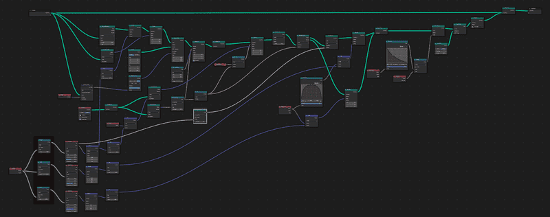

Now we add a second scene (There is a place to do this, and it also allows you to toggle back and forth between scenes.) The second scene only contains a camera and the HDRI background. (And you can just copy and paste these from the first scene.)
Now we open the compositor. It should already have a render input node assigned to the first scene. Add a second render input, and assign it to the second scene you created.
Each of these nodes have outputs on them. The second scene will have an image output, and a couple of others, which we don't need. The first scene has an additional output labeled shadow catcher, and this is how you access the shadow catcher pass.
Create a "mix" node, and set the type to multiply. Take the image output of the 2nd scene and the shadow catcher output of the first scene and feed them into the two image inputs of the mix node.
This takes the shadow pass image and uses it to control the darkness of the HDRI image. Everywhere the shadow pass is white, you just see the background unaltered. Everywhere is is not white darkens the background by an amount determined by how far from white it is.
Create a new mix node. by default it is set to mix, and that's what we want. Take the image output and feed it to one of the image inputs of the mix node. Take the image output of the first mix node and feed it into the other image input.
Take the output from the first scene labeled "alpha" and feed it to the factor input of the mix node. Alpha is a measure of transparency, so doing this tells the combined image, "Everywhere there is transparency in the first scene's image, put the background image, and everywhere it isn't, put the first scene's image.
Take the image output from this mix node and feed it to the output node.
Now you just render the scene.

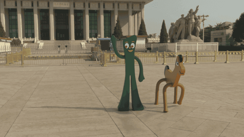

Here's an example, using models of Gumby and Pokey that I had previously made, and an HDRI of Zhengyang gate (I used it because the lighting gives a good shadow, and the ground is a nice and flat.)
Gumby, a green clay figure, and Pokey, his orange horse companion, standing on a paved plaza in front of a large columned building and a statue group.
Not only does this allow for a faster and easier method for creating this effect, but is so much easier to make changes. Before, if I wanted to move the models in the scene, change the camera angle, change the orientation of the HDRI, or change the HDRI entirely, I would have made the changes, rendered new shadow mask images and do the necessary alterations to them, put them into the compositor set up and re-render the image. Now I can just make the changes, and directly render the new result.

This is a really neat trick I just learned, and really not that labor intensive.
You start with a bezier curve object. You then edit it with the "draw" tool, by using the mouse to draw on the screen the path you want your curve to follow.
You don't have to be perfect, as you can then use control points of the curve to make adjustments.
Once you get it looking like you want, convert it to a mesh. (This has to be done in order to apply any of the following modifiers)
The first modifier is the "cloth" modifier. It basically makes objects behave as if they are made of cloth when animated. In this case, our curve will act like a string.
Now, we attack a "hook" to one end on the string. This is basically an object that this end of the string remains attached to and follows, pulling the rest of the string with it. Since we don't need (or want) this object to be visible, we use an "empty object".
Speaking of being visible, if we tried to do a render at this point, we wouldn't see anything. This is because our "string" is one dimensional. To fix this, we add a "skin" modifier, which gives it some thickness, which we can adjust to our needs. We can also now assign a material to it.
If we render now, we see our string following the curve we traced out earlier. If we run the animation, the string will droop, hanging and swinging from the stationary hook.
For this particular effect, we don't want this, instead, we want it to hold its shape until the hook moves. We do this by turning "gravity" off in the settings.
So for example, assume your string traces out a word in cursive. It will hold this shape until the Hook starts to move, then the word will "unravel" starting at one end, working its way down the word until the whole string is moving.
This in of itself, is a pretty neat effect, but we can improve on it even more. We can apply the "build" modifier. By setting a start frame, and the number of frames to apply the effect. The animation will build the string, segment by segment over that number of frames. And it does it in the same order as you orginally traced the curve with your mouse. You can animate the word being written down before it gets pulled off screen.
Okay, so that's the basic effect (and while what I wrote above does seem to be a lot, it's easier to do than explain).

After much procrastination, I've finally decided to dip my toes into VFX ( Video effects) using Blender.
Up to now, I've settled with doing animations relying on static backgrounds for the scenes. And even though HDRIs allow for panning and tilting of the camera, there are limitations. The background scene itself is a still, and you can't move the camera from its position.
Putting a 3-D model into a video, particularly one with a moving camera is a challenge.
Luckily, Blender has a method of making a lot of the hard work less daunting.
It uses motion tracking, And here's the gist:
You start with the video you want to use. One nice thing is that it doesn't have to taken with special equipment and can just be one you've taken with your cell phone. You load the video into Blender. Go to frame 1 of the video, and place markers at different point of the image ( for this to work best these markers should be areas of high contrast). You need at least 8. Run the tracking tool. The video will run, the computer will try to Place markers on each frame, tracking the points you chose. ( this doesn't always go smoothly the first time around, but there are ways to fix things as you go along.
Once the tracking is done, you do a camera solve. The program will create a basic blender scene with a camera, one that move in the scene just like the camera you took the video with did.
There are some adjustments that allow you to align this scene with the video, and once that's done, you can put any 3-D model in the scene you want, effectively placing it into the video.
After a couple of false starts, I got a what I think is not too bad a result. Since this was just a test, I decided to just put some black marks on a paper to make tracking easier. The ship is a CGI 3-D model I had made previously.
I've still have some work to do, as the motion tracking between model and video is not perfect ( the fact that the ship is moving in the video helps hide this.), but just this little success has given me some ideas for future projects.
I came across another tutorial for an effect in Blender. It is quite neat and involves "geometry nodes", a feature added to Blender just a few versions ago, and has been growing by leaps and bounds since.
It differs from the normal means of modeling in that it uses a "node tree" It has a number of useful aspects: One is that it allows you to do some things that would be extremely difficult or impossible to do otherwise.
Another is that it is "non-destructive". What this means is that you can undo or change something at any time or at any point of the modeling process, without having to undo everything you've done to the model since.
It's like if you build a house, and after you start framing it, you realize that the foundation is laid wrong. So you have to tear everything down, make the changes to the foundation and start framing again. With Geometry nodes, you can go to the node that controls the parameters of the "foundation", change them, and the framing you've already built will adjust to the new foundation.
The effect in question creates an "electric arc" that jumps to one object to another. You can set the maximum distance over which arc will jump. How many arcs will be produced at a time, etc.
Here's the video of what I did with it for a test. A link to the tutorial in included in the description for anyone interested. I'll also add an image of the entire node tree, but because of its size and complexity, the names of the nodes used and the settings aren't readable.
The node tree for the effect:
Full node tree in Blender's Geometry Nodes editor, with green and white links for geometry and blue links for values, spanning many small nodes too tiny to read.

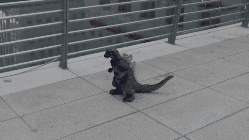

I found a new toy that's going to be interesting to play with.
AI and cloud computing has come to Blender.
You can now download an app for your phone, use it to snap a number of pictures at different angles of a object, upload them and after a few minutes get back a 3D model of the object, complete with textures.
( you get an an email with a link from which you download the model)
For example:
Toy figure of Godzilla standing on a grey paved walkway in front of a metal railing, with a glass wall behind it.
This is a rendering of a resultant model of a scan of a plastic Godzilla figure I had. The background is a HDRI.
Now you might be thinking that you could do something like this in Photoshop, so what's the big deal?
The difference is that this is a 3D mesh model, to which you can do whatever you could do to any other mesh. Such as making an armature rig, binding the mesh, and animating the armature to do something like this:
Photo of a small purple-blue plastic Godzilla toy figure standing on a grey paved surface, with a background of a railing and blurred greenery.
Giving life to a rigid plastic figure.
I used the free version of the app, and it took just a couple of attempts to get a usable set of photos (proper soft lighting with no harsh shadows is the key).
The higher end paid version has some extra bells and whistles. Such a a higher limit for the number of photos you can upload for any object, an option for using a manual camera settings, and an unlimited number of models you can export (The free version limits you to 3 a week)
