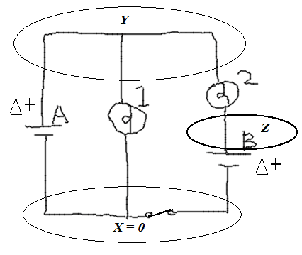

Here is a diagram of the circuit I am analyzing:
http://www.sixtheorem.com/images/1.png
I observe that bulb 2 does not light when the switch is closed. Could someone please explain what is happening here?
And, what happens if I reverse the direction of battery B?

The sketch shows the voltage at three nodes X, Y, and Z. The voltage on a node is uniform since lines represent perfect conductors in a circuit sketch.
Ohm's Law applies on the lit bulb and the unlit bulb:
V = IR
where V is the voltage difference across the two terminals and resistance R is fairly small for a conventional bulb. The bulb needs plenty of current I to light up, a small current flow will pass through but produce no visible light. Too much current will burn up the fillament.
If you reverse battery B (in the sketch) draw a new set of nodes and find the voltage on each bulb to answer your own questions.

If A and B are exactly equal, there is no voltage across lamp B. If they are unequal, there is a voltage across lamp B. (Assuming that the switch is closed.)
Lamp 1 has nothing to do with the question you asked. The behavior of lamp 2 is the same whether lamp 1 exists or not.

The image that SystemTheory posted is getting at the right idea...
Basically, the whole bottom section of wire has to be at the same electrical potential. (Since it takes no energy for current to flow through an ideal wire, there can be no change in potential when moving from one part of the circuit to another part that is connected by only wires) Let's call that potential 0 - it's the part labeled X in SystemTheory's diagram.
The purpose of a battery is to fix the potential difference between its two ends. So, again with reference to SystemTheory's diagram, the top section of wire will be at a fixed potential Z because it is separated from the bottom section by a battery, namely battery A. If the voltage of battery A is 9 volts, then Z - X = 9 volts.
The same reasoning applies to the section labeled Y, between the bulb and battery B. If the voltage of battery B is 9 volts, then Y - X = 9 volts.
Now, can you see, if batteries A and B have the same voltage, what is Z - Y? That is the voltage across the bulb, and a bulb that has zero (or nearly zero) voltage across it will not light up.

The standard procedure is to travel mentally around a closed loop, calling voltage rises positive terms and calling voltage drops negative terms, and add the terms. You will find the two batteries pointing in opposite directions, so that a combined voltage of (+A)+(-B) is applied across the lamp. That's A-B, which is zero (if A=B).
Same thing with a typical flashlight that takes two 1.5 volt batteries, to apply 1.5 + 1.5 = 3 V across the bulb. If you put one of the bulbs in backwards, the combination will become 1.5 - 1.5 = 0 V.
