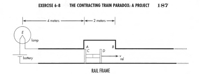

I will not describe the problem here without the copyright owner's permission. I, like the OP in the original thread, am keen to see if anyone else who has this text has solved the problem, since no solution is offered in the text.
My solution is to determine the spacetime interval between the power being disrupted to the bulb and the power being restored to the bulb in each reference frame. If these are the same then there is no paradox and special relativity holds.
NOTE: I mistakenly used 2 metres as the distance between the lamp and the start of gap instead of 4 meters in the rail frame and 1 meter instead of 2 in the slider frame. This does not affect the spacetime interval, just some of the event coordinates.

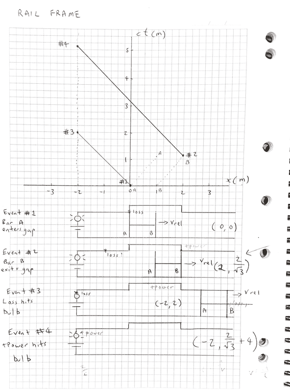

Event coordinates were determined used a spacetime diagrams (attached) drawn to scale and plotting the various world lines.
RAIL FRAME Event Coordinates
Working out the event coordinates in the rail frame is pretty easy. First plot the world lines of bar A and B on the slider as it traverses the gap in the top rail. The power lost world line starts as soon as the slider enters the gap and the power on world line starts when bar B reaches the end of the gap in the top rail. From there these world lines travel toward the left as light-like signals until they intersect with spatial line x=-2, where the bulb is. These intersections are easy enough to see on the spacetime diagram.
Event #1: Bar A enters gap
##(0,0)##
Event #2: Bar B exits gap
Time to travel 1 metre when ##\gamma =2~is~\frac {2} {\sqrt{3}} m##
##(2,\frac {2} {\sqrt{3}} )##
Event #3: Power loss hits bulb
##(-2,2)##
Event #4: Power restored to bulb
##(-2,\frac {2}{\sqrt{3}}+4)##
So we are interested in the spacetime interval between Event #3 and Event #4.
This interval, as we know is given by ##interval^2 = time^2 - space^2## which is
##interval^2 = (\frac {2} {\sqrt{3}}+4 - 2)^2 - ( -2 - -2)##
##interval^2 = (\frac {2}{\sqrt{3}}+2)^2 - 0##
##interval = \frac {2} {\sqrt{3}}+2## m

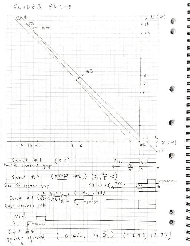

SLIDER FRAME Event Coordinates
Things get a little more involved in the slider frame since both the rail and the power off and on signals travel to the left relative to the at rest slider. I had to derive the linear equations for the power off and power on world lines, then determine the intersections with the bulb world line in order to arrive at the event coordinates #3 and #4.
Linear equations
Bulb worldline
##ct=-\frac{2}{\sqrt{3}}(x+1)~~~##[1]
Power off worldline
##ct=-x~~~##[2]
Power on worldline
##ct=-x-\frac{2}{\sqrt{3}}+2~~~## [3]
Find intersection of line [1] and [2] to derive Event #3 coordinates
##-x = - \frac {2}{\sqrt{3}}(x+1)##
## x= \frac {2}{\sqrt{3}-2}##
## ct=\frac {-2}{\sqrt{3}-2}##
Find intersection of line [1] and [3] to derive Event #4 coordinates
##-x+\frac {\sqrt{3}} {2} = \frac {-2} {\sqrt{3}}(x+1)##
##x = -6 - 4\sqrt{3}##
##ct = 8 + \frac {10} {\sqrt{3}}##
##(0,0)##
Event #2: Bar B exits gap ( BEFORE Event #1! )
##(2,\frac {\sqrt{3}} {2})##
##(\frac {2} {\sqrt{3}-2},\frac {-2}{\sqrt{3}-2})##
##(-6-4 \sqrt{3},8+\frac {10}{\sqrt{3}})##
Now at last we can determine the spacetime interval between Event #3 and Event #4.
##interval^2 = (8+\frac{10}{\sqrt{3}}+\frac {2}{\sqrt{3}-2})^2 - (-6 -4\sqrt{3} - \frac {2} {\sqrt{3}-2})^2##
##interval^2 = (4+\frac{4}{\sqrt{3}})^2 - (-2(1+\sqrt{3}))^2##
##interval^2 = \frac{32}{3}(2+\sqrt{3}) - 8(2+\sqrt{3})##
##interval^2 = \frac{8}{3}(2+\sqrt{3})##
##interval = \frac{2}{\sqrt{3}}+2## m

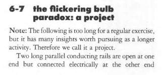

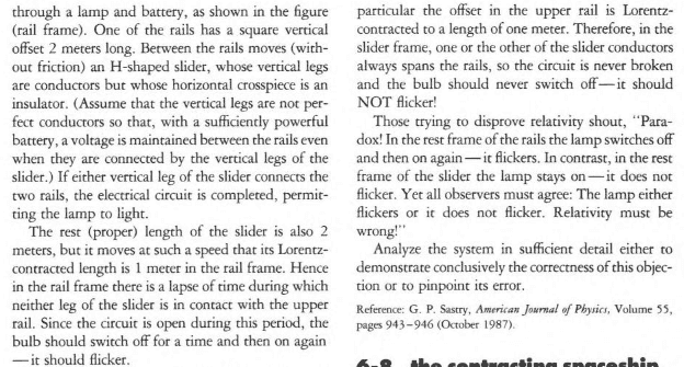

Taylor and Wheeler recently made their book free to download: http://www.eftaylor.com/spacetimephysics/.
Edit: The example is near the end of chapter 6.
Edit 2: The book was released under a Creative Commons license that specifically permits copying and remixing as long as it is properly attributed.

A couple of comments.
First, you derived the coordinates of the events in the slider frame from physical reasoning in that frame. You can sanity check it by Lorentz transforming the events in the rail frame. For example, event #3 is at ##(x,t)=(-2,2)##, which transforms to the slider frame as $$\begin{eqnarray*}
(x',t')&=&\left(2(-2-\frac {\sqrt{3}}22),2(2+\frac {\sqrt{3}}22)\right)\\
&=&(-4-2\sqrt{3},4+2\sqrt{3})
\end{eqnarray*}$$Checking that this is the same as your expression and checking event 4 are left as exercises for the reader.
Second, you seem to have assumed that the signal speed in the wires is ##c##. It probably isn't, so you should probably consider whether a slower signal speed makes any difference (unless the exercise says to assume that somewhere and I've missed it). No maths needed, but a line or two of reasoning why it doesn't matter.
Finally, I would say that to truly show that there is no paradox you would have to show that the current via the right-hand bar doesn't reach the left-hand end of the offset until after the left-hand bar has disconnected. Incidentally, you've mislabelled the bars as A and B. In the book, A and B are points on the rails, and the bars are labelled C and D.

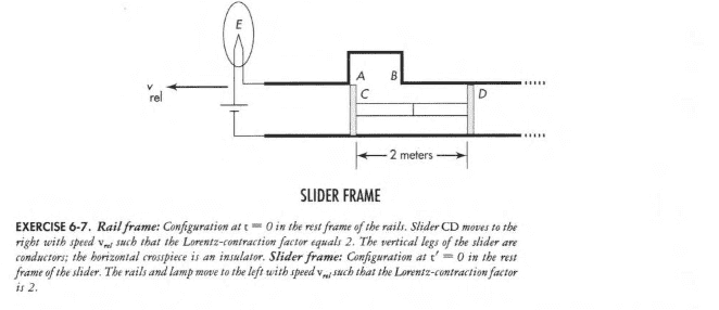

Thanks Ibix,
For the lazy I have attached some screenshots.
Steve

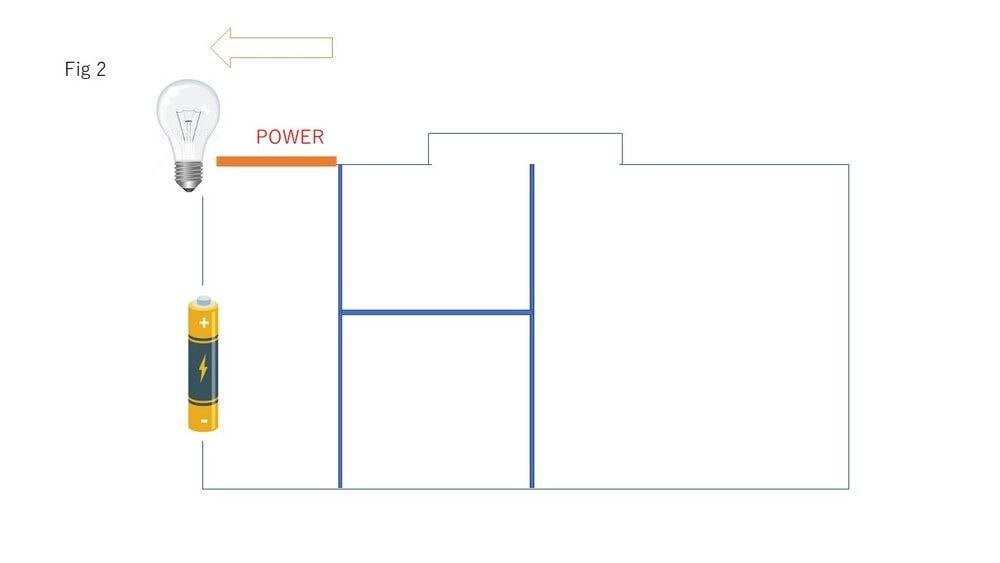

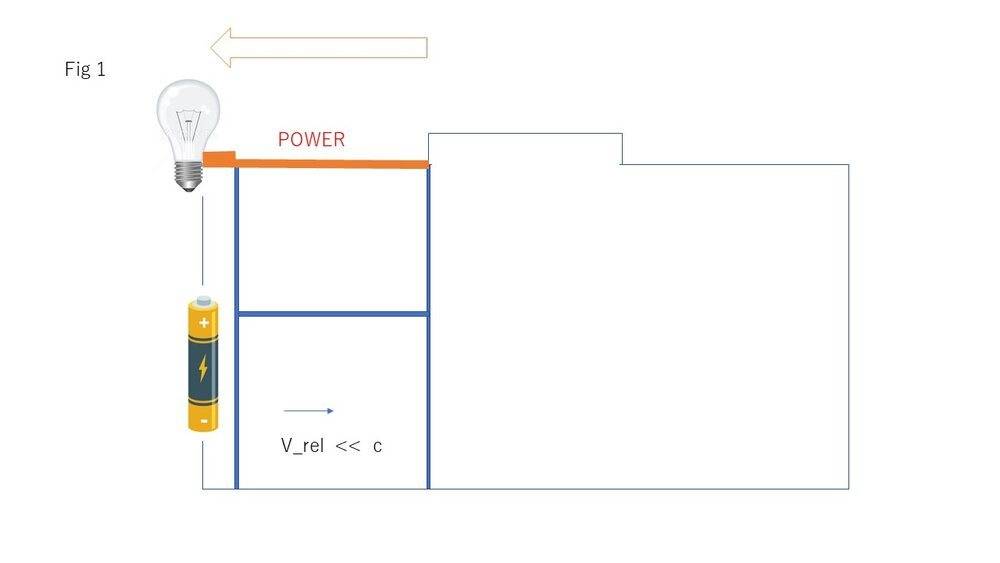

I am very much interested in this "paradox". Thank you @astrodummy.
Say the relative speed v_rel << c, small compared with c, we find the loss of contact on left edge and gain of contact on right edge of Slider are simultaneous events both in Rail frame and in Slider frame because we do not have to be sensitive on the difference of simultaneity of frames for such a low speed.
In this case Light bulb flickers. Signal : loss of contact and signal : gain of contact take place simultaneously but left edge is nearer to light bulb than right edge by 2 meter=l. Time difference for signals to reach light bulb is ##\frac{l}{c}=7.77## nano second. Light bulb is turned off during 7.77 nano second.
So I assume light bulb flickers in both the frames for original ##v_{rel}=\frac{\sqrt{3}}{2}c## case. It is obvious for Rail frame. In Slider frame also I assume loss of contact signal arrives to light bulb earlier than gain of contact signal though gain of contact takes place earlier than loss of contact in Slider frame, considering that light bulb is evacuating with speed ##v_{rel}=\frac{\sqrt{3}}{2}c## from light speed c signals. Gain of contact signal arrives at right edge rail in the middle way to light bulb, after loss of contact signal has departed from there. Your opinion is appreciated.
EDIT miscalculation False 7.77 True 6.67 nano second. Thanks @astrodummy #12.
If v_rel << c then ##\gamma## will be 1. So, no length contraction in either reference frame. And since AB = CD the bars will always be in contact with the rails, so the power will never be lost to the bulb. No flicker at all!
As Ibix correctly pointed out the quickest way to determine the event coordinates in the slider frame is to do a lorentz transformation on the rail frame coordinates ##(-2,2)## and ##(-2, \frac{2}{\sqrt{3}}+4)## which yeilds ##(-4-2\sqrt{3},4+2\sqrt{3})## and ##(-6-4\sqrt{3},8+\frac{10}{\sqrt{3}}) ##.
The spacetime interval between the bulb going off and back on again is ##\frac{2}{\sqrt{3}}+2## metres in both frames of reference.

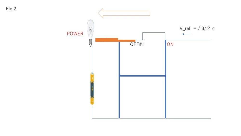

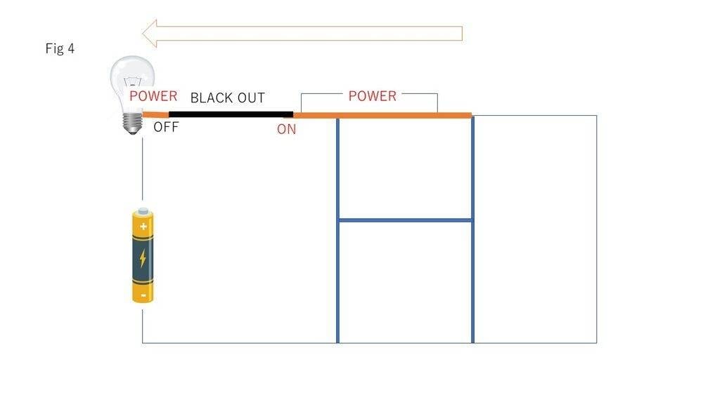

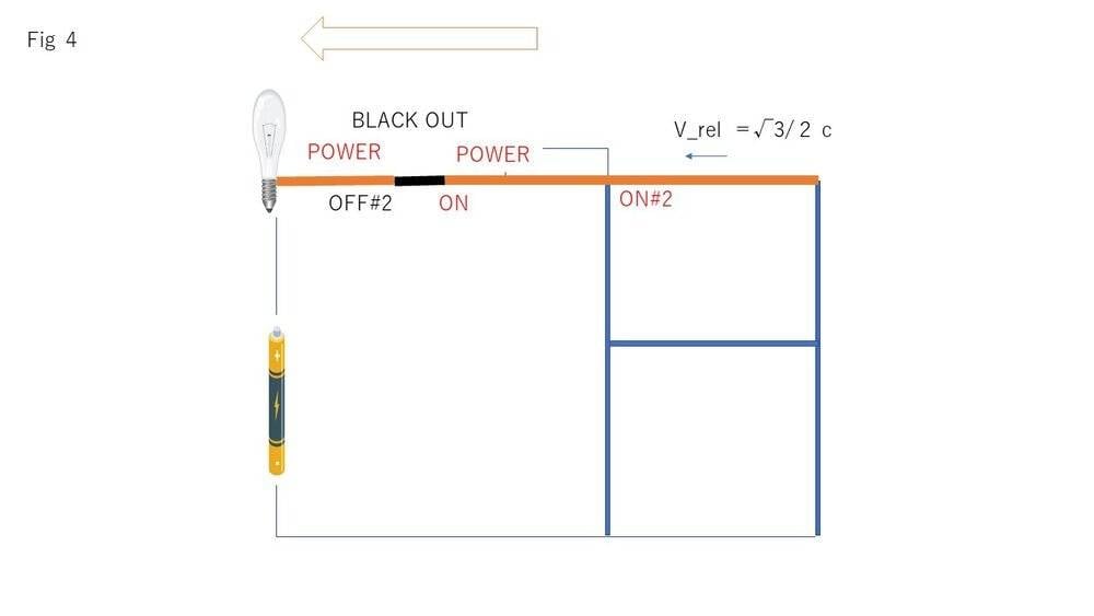

I say flicker, you say no. Please have a look at attached 4 sketches on time evolution for the post #9, v_rel << c case to explain flicker. Power on/off signal has light speed.
D'oh! Of course. That 2m section of the rail is "dead" the instant Bar D touches point B. So that 2 meters of 'no power' will get to bulb in due course. So coordinates of Event #3 'power loss reaches bulb' is ##(-4,4)## and coordinates of Event #4 'power restore reached bulb' is ##(-4,6)##. So the spacetime difference is 2 m as you would expect or 6.67 nanoseconds. And since ##\gamma## = 1 the slider frame behaves in the identical fashion.
I draw similar time evolution 4 rough sketches in Silider frame for ##v_{rel}=\frac{\sqrt{3}}{2}c## to explain flicker as attached. I should appreciate if you could provide certificate by calculation.
Your 'time evolution' diagrams have a problem. You cannot claim that AB is in 'black out' before bar D gets to B without also acknowledging that the bottom rail between C and D ( the distance between the vertical bars on the slider ) is ALSO in 'black out'. Since there can be no current in either the instant before D makes contact with B. So the 'dead time' should be 4 m ( length of slider plus length of the gap ) perhaps?
Actually now that I think about it that cannot be true either. Both the top and bottom rails are always 'live' since they are both connected to the battery at all times. Instantaneously changing the connection from bar A to bar B will not interrupt the current flow when vrel << c. There will be no flicker.
