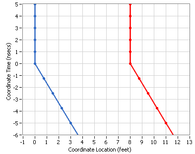

This is the first question that's on my mind:
analyst5 said:
And btw, it can be concluded that distance plays a big role in the judgement of simultaneity. For moving observers, the greater distance in space is from an event, the distant the event is in time, right?
And the second would be a combination of length contraction and composition of different temporal segments of the object. Let me explain.
What if the worldtube (the object) undergoes acceleration, would the observer still intersect it and have the object that is composed of different temporal segments in its present frame? Would he 'perceive' the object in a state which some of its parts undergo change of speed before others?
If an object undergoes acceleration in which every part accelerates at the same time in one frame then in other frames the acceleration will be such that different parts accelerate at different times.

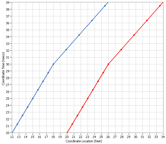

But did you understand that accelerating an object in this manner can result in it being stretched to a new length?
Here is a diagram for a ten-foot long object (like your table) having every part accelerated simultaneously in its own initial rest frame:
Now if we use the Lorentz transform to see what it looks like in its final rest frame, we get:
Note that the table is now 12.5 feet long.

So acceleration always results in an increase in proper length? Interesting, I didn't know about this.
Why those changes aren't noticeable on our scale?And what about decceleration?
No, it doesn't necessarily result in an increase in proper length. That happened because we accelerated all the parts of the table simultaneously in its initial rest frame. If we accelerate all the parts of the table simultaneously in its final rest frame we go from this:

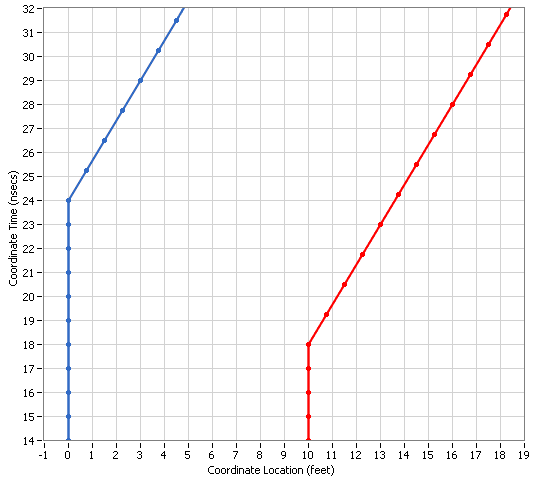

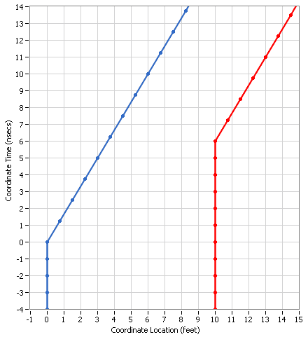

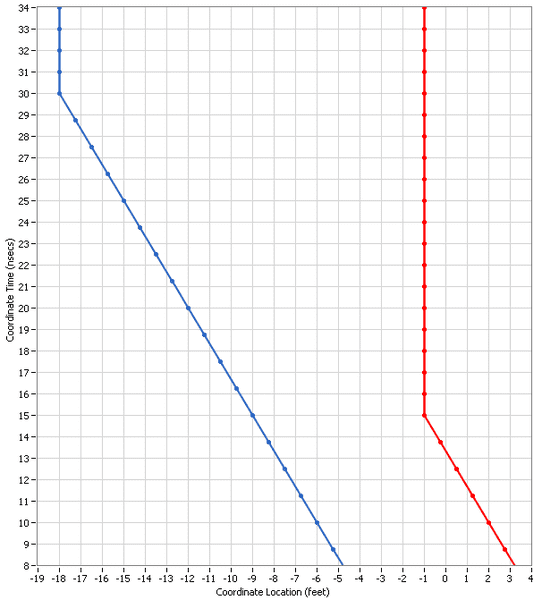

Just for fun, I decided to try some more frames with simultaneous accelerations. The next one I tried was a frame moving at -0.6 relative to the initial rest frame of the 10-foot long table. Here's the spacetime diagram for that IRF:
And here is the diagram for the initial rest frame of the 10-foot long table:
And finally for the final rest frame of the table:
Now we see that the table has been stretched to 17 feet.
I did some additional experimenting and discovered that the maximum stretching is double the initial length of the object and the maximum compression is one-half the initial length of the object. The maximum stretching occurs with simultaneous acceleration in a frame approaching -c with respect to the initial rest frame and the maximum compression occurs with simultaneous acceleration in a frame approaching c with respect to the initial rest frame.
Keep in mind that this stretching and compression has nothing to do with Length Contraction which is a frame dependent effect and not measurable. This stretching and compression is not frame dependent and is measurable (if we could actually perform the exercise).
