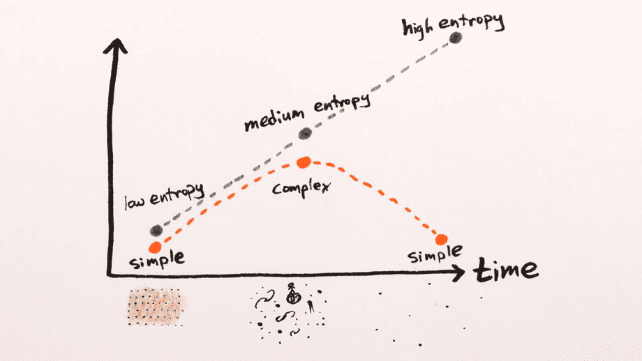

Much before the entropy death there will be complexity "death", or more precisely the point at which complexity will start to decrease. Consider a self-organizing system such as life in general or human civilization in particular. Such systems typically have two phases of evolution. In the first phase, both entropy and complexity grow. In the second phase, entropy still grows but complexity decreases. The first phase is the phase in which life and civilization show progress over time. In the second phase the progress is replaced with regress. We on Earth are still in the progress phase (the complexity still grows), but it might turn into a regress in a not so far future.

Complexity and entropy are not unrelated. As the graph shows, maximal complexity happens at some medium entropy. See also the appendix in http://de.arxiv.org/abs/1703.08341
