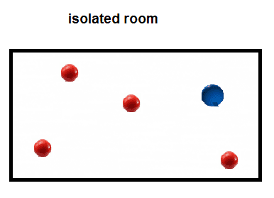

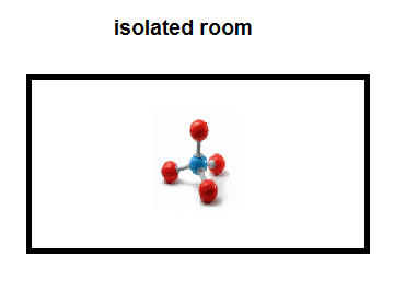

According to below site:
http://hyperphysics.phy-astr.gsu.edu/hbase/Therm/entrop.html
Concept of entropy is that nature tends from order to disorder in isolated systems.
Now you said me which one is more disorder?
a) a isolated vacuum room with a methane molecules (this figure)
Ball-and-stick model of a methane molecule: a blue central carbon atom bonded to four red hydrogen atoms in a tetrahedral arrangement, shown inside a black-bordered box.
b) a isolated vacuum room with 5 freely atoms? (this figure)
Diagram of an isolated room drawn as a black-bordered rectangle containing four red spheres and one blue sphere scattered at separate positions, labelled isolated room above.
Therefore, I think methane tends to break it's bond but it couldn't because first law is preceded to The second law.
Your bound molecule already has the maximal disorder for its energy. Done. Nothing will happen.
I couldn't understand how you say methane has more entropy than it's components.
In this formula 2H2+C-->CH4
We have 3 mole of reactions and mole of production. so obviously methane has less entropy than 2 hydrogen molecules and 1 carbon and tends to break it's bond.
If temperature be enough the breaking will happen more likely. but system is isolated and no changing in temperature could occur.
A single molecule doesn't have a temperature. It is just flying around forever without doing anything else.
You can assign temperature even to a single methane molecule, but this means that you don't have full information about the state of the molecule. I.e. it could be that it is already dissociated at the very beginning.
You can have a methane molecule in a room with walls of a given temperature. Then the molecule will be in thermal equilibrium after a short time and you can assign it a temperature. If you now replace the walls with adiabatic ones, the temperature of the particle won't change. This kind of experiments are standard for all kinds of particles inside some particle traps. So the answer to the OPs question is: By assigning a temperature to the molecule, you already lack information on whether the molecule is intact or dissociated from the very beginning.
All that is conserved is that there is one carbon and 4 hydrogen atoms. Whether they are bound or not is never certain at finite temperature.
