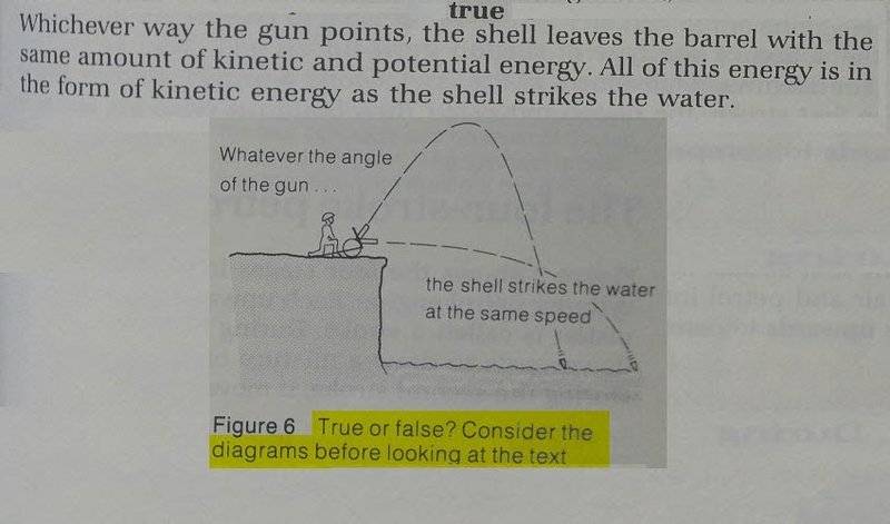

Please have a look on the attachment. Do you also agree that the shell strikes the water at the same speed?
It seems false to me.
The vertical and horizontal motion is independent of each other. When the shell is fired horizontally, it starts descending toward the ground from less height compared to the other case. It's kinetic energy is used to push the shell horizontally against air resistance.
On the other hand, when the shell is fired at an angle, it's kinetic energy has two components. One component pushes it forward horizontally and the other component pushes it vertically against the gravitational force . In this case the shell descends toward the ground from greater height and hence more kinetic energy at the moment when it strikes water. Thank you.
Yes. (Forget about air resistance.)
So? The total energy it has is the same regardless of its firing direction. That's what will determine the speed when it hits the ground.
If shot at an upward angle, when it falls back to the original height it will have the same speed that it started with.

PainterGuy said:
Let me try. It looks like that I was interpreting it wrongly.
Yep. You were.
Forget the complicated stuff about forces and directions; an argument involving Energy is the clincher. The Energy when it hits the water is the same, whatever path it takes and it's equal to the Kinetic Energy from the gun and the Gravitational Potential Energy at the launch height. All that energy turns up as Kinetic Energy of the shell entering the water. (Independent of launch angle).
If you want to, you can go through the sums, going through your alternative route, but you can't hope to get a different answer. And you have to actually do the complete sums - not the half calculations you did in your post.
Energy is your friend in all calculations like this.

PainterGuy said:
Case 2: When it is fired at an angle, its energy consists of kinetic energy which will have two component - one pushing it vertically upward (5 J) and the other pushing it horizontally (5 J).
Velocity has components; energy does not. But I understand what you mean: You can break the velocity into vertical and horizontal components and calculate the KE associated with each component to get the total.
PainterGuy said:
After reaching a certain height, say, 5 m above the surface where gun is placed, all of the component of its kinetic energy which was pushing it upward is converted into potential energy, and at that moment its potential energy would be 10 J.
Here's your error. If the vertical component of velocity only accounts for half the total KE then the highest it can go would be where its potential energy would be 5 J. So the total energy at any point is always be 10 J.
Quandry said:
So the speed that it 'hits the water's your examples will always be different.
Not so. (Keep to the simpler case and ignore air resistance.) Whether you fire the bullet straight down into the water or straight up into the air, when it hits the water it will have the same speed.

Quandry said:
Absolutely not the case. A projectile fired vertically will loose its initial velocity and start to fall. Assuming that it takes 10 seconds to do so, it will have a velocity of 980 fps when it hit the water. If fired directly at the water at a typical velocity of 2500 fps it will hit the water at 2500 fps.
If the speed at which the shell leaves the barrel is 2500 fps then if fired straight up it will reach a height such that it takes 2500/32 seconds to fall back down, and will be moving downwards with a speed of 2500 fps, just as if it had been fired straight down in the first place.
Your argument would only hold if Energy were not Conserved. It is conserved so you just have to be wrong - without any calculations needed. You need to find out what's actually wrong about your argument, rather than try to prove that it's right. Do the complete calculation and, as other posts have shown, the speeds will be the same.
