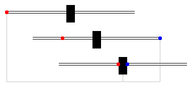

Suppose, instead of a beam flexing due to imparted momentum, the lightning strikes enter the ends of a fiber optic cable, at the center of which are two detectors very close together, or equidistant from the ends and staggered a smidge. Do both detectors click at the same time in all frames, which seems to contradict light-speed invariance? Or do moving observers see the detectors clicking at different times?

Ibix said:
in a moving frame, the light does not travel the same distance along each optical fiber, since the "middle" is moving forwards.
I don't get this. Are the relative distances from the detectors to the ends of the cable frame-dependent?
No. But the cable is moving, so the midpoint is running away from one flash and running to meet the other. So where the flashes meet (in the moving frame) ends up being further from where one flash entered the cable than the other, despite both halves of the cable being the same length.
You can see this in Newtonian physics. Imagine you have a 2m long channel. You simultaneously insert two marbles from each end, rolling at 1m/s. They collide in the middle 1s later.
Now imagine that you walk past the apparatus at 1m/s. One of the marbles is stationary in your frame, and the other is doing 2m/s. They still collide in the middle of the channel 1s later, but one marble didn't move and the other came all the way to it.
The effect is qualitatively similar in relativity. It's just made more complicated by the less trivial velocity addition rule and the relativity of simultaneity.
But we're talking about light. I assume we won't observe the light from the two flashes as having different speeds, as we do with the marbles.
How can we then meaningfully say one cable isn't longer than the other in our moving frame? Assuming, that is, that the flashes still meet at the detectors — which I assume is a necessary condition for the detectors to click together.
What assumption am I getting wrong?
Light travels at ~ 0.66c through a fiber optic cable. The speed of light is only invariant in a vacuum.
Light traveling through the fiber optic cable would be subject to the relativistic addition of velocities.
So for example, if the fiber optic cable is moving left to right at 0.5c relative to some observer, he would measure the light leaving the left end of the cable as moving at (0.5c+0.66c)?(1+ 0.5c(0.66c)?c^2) = ~0.87c to the right relative to himself and ~0.37 c to the right relative to the cable.
Light leaving the right end would be measured as moving at ~0.24c to the left relative to himself and ~0.74c to the left relative to the cable.
If the strikes were simultaneous in the fiber frame, then, in this external observer frame, the lightning strikes the left end first and then the right end. The light traveling along the cable takes longer according to him to reach the center of the cable if it starts at the left end then it does if it starts at the right end. This difference in travel time will exactly cancel out the head start the light starting to the left had, and the pulses reach the center of the cable according to our external observer just like it does in the cable frame.
My mistake. Let's take that out. Mirrors rather than the ends of cables. Nothing else changes. I'm still missing something.
This might be confusing to the OP as it is stated. The point is that "where the flashes entered the cable" is frame-dependent. In the cable's rest frame, the points "where the flashes entered the cable" are at rest relative to the cable. In the moving frame, those points are moving relative to the cable.
Making this concrete is one reason why it helps to include the embankment in the classic Einstein train thought experiment. If you think of the cable as like the train in that experiment, and the points "where the flashes entered the cable" in the frame in which the cable is moving as being points on the embankment, corresponding to the points where the lightning strikes hit the embankment in Einstein's version, it's easier to see how the point where the flashes meet, in the frame in which the cable is moving, is not equidistant from the points where the flashes entered the cable.
See my response to @Ibix just above.
