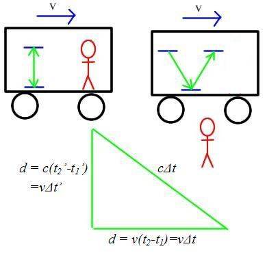

Why , on train example, the outside opserver see that the pulse travels from bottom to the top in same duration time (delta t) of traveling from top the bottom.
Train example figure:

powermind said:
But when we apply time dilation T=t/sqrt(1-v2/c2) that exectaion is wrong.
You have to allow for relativity of simultaneity and length contraction as well as time dilation.

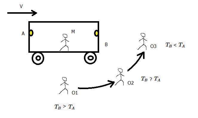

Anyway, please see this figure:
There is a possilbe location outside the car so that the observer in this location will find that ##T_B## equals ##T_A##!
another point, you said:
However, the time it takes for the light pulse emitted at the back of the car to travel to the front, according to the outside observer, is ##T_D##−##T_A##, which will be *larger* than γt , because ##T_A##<##T_B##. And the time it takes for the light pulse emitted at the front of the car to travel to the back, according to the outside observer, is ##T_C##−##T_B##, which will be *smaller* than γt , because ##T_B##>##T_A##. So to get the correct time intervals according to the outside observer, you have to take into account relativity of simultaneity as well as time dilation
On the contrary for observer O3, ##T_D##−##T_A## will be smaller than γt and ##T_C##−##T_B## will be larger than γt!
I think this is not true because the distance between A and D should be greater than the distance between B and C!
Regards,
powermind said:
I do not understand well! Is the delay because of the distance between O and the light sources or because of the car moving?
The relativistic effects (length contraction, time dilation, relativity of simultaneity) depend only on the relative speed of the various observers.
The delay between when a light signal leaves the source and when it reaches an observer depends only on the distance between the point of emission and the point of detection. The relative speed of the source and the observer makes no difference (except that if the observer is moving it may be harder to see exactly where the point of detection will be). However, that distance will be affected by length contraction, so different observers moving at different speeds relative to one another will find that the distance, and hence the time that the light takes to cross that distance, are different.
You can find locations outside the car where the light from A and B reaches the observer at the same time. However, if the observer is moving relative to the car, the distance covered by the two flashes will be different, and the observer will therefore conclude that the two flashes left their sources at different times. You will not be able to find any position at which both flashes will reach an observer at rest outside the moving car at the same time AND have covered the same distance AND were simultaneous according to the observer in the car.
I've said it before, and I'll say it again: you have to allow for the relativity of simultaneity and length contraction, not just time dilation, to make it all come out right.
No, there isn't, because ##T_A## and ##T_B## have nothing to do with when the outside observer *sees* the light beams from the front and rear of the car; they are the times that the outside observer assigns to the light beams being *emitted* at one end of the car (or *received* at the other end of the car if we include ##T_C## and ##T_D##). The relationships between those times are as I said in my previous post, regardless of where the outside observer is located. Please re-read my posts, carefully.
Yes, but note that that's not what ##T_A## and ##T_B## mean, or ##T_C## or ##T_D##. Those are the times assigned by the outside observer to the light beams being emitted or received at the front or rear of the car. They are unaffected by the outside observer's location.
I agree - that's (supposed to be) what the chain of ANDs in the next sentence is about.

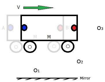

Hi again,
The discussion is going to be complicated for me. So, I would like to simplify it.
1. We will ignore the length change till I understand the concept.
2. We will focus on the time that the light switched on at.
See this example:
In the example, there are three outside observers O1, O2 and O3 who are not moving while the observer M is in the vehicle which is moving forward. There are two lights at back and front of the vehicle. The lights are switched on at the same time according to M.
- ##T_A1## is the reached time of the back light beam to O1’s eyes.
- ##T_B1## is the reached time of the front light beam to O1’s eyes.
- ##T_A2##, ##T_B2##, ##T_A3## and ##T_B3## for other observers O2 and O3 respectively.
The first questions are:
1. Do the outside observers share same clock? I think yes 
2. You said that O1 will find ##T_B1##>##T_A1##, and O3 will find ##T_B3##<##T_A3##:
a. What is the comparison between ##T_A1## and ##T_A3## and the comparison between ##T_B1## and ##T_B3##? Greater, smaller or equal?
b. If O3 sees the mirror located behind O1, he will see the back light first definitely like O1. This is a strange? Is not this?
c. ##T_B1##>##T_A1##! Is it because of the distance between the light source and the observer O1? If so, imagine another light located in the middle of the vehicle between back light and front light. Its distance could be shorter than the distance of the back light. Hence, O1 should see the middle light before the back light but you said the opposite!​
This is your idea of simplification? This is very complicated.
You cannot always ignore it. However, you can do things like specify the length of the car in the O frame.
For simplicity, let's use units of length such that the car is length 2 in the O frame and let's use units of time such that c=1. In that case in the O frame A switches on at t=-v and B switches on at t=v.
I wouldn't say that they share the same clock, I would say that their clocks are synchronized.
a. What is the comparison between ##T_A1## and ##T_A3## and the comparison between ##T_B1## and ##T_B3##? Greater, smaller or equal?​
##T_A1=-v+\sqrt{1+y_1}## and ##T_A3=1-v+x_3##, so the comparison depends on the exact values of ##y_1## and ##x_3## and v. Similarly with B.
If the mirror is located at y=d/2 then ##T_{AM}3=-v+\sqrt{1+d^2+2x_3+x_3^2}## and ##T_{BM}3=v+\sqrt{1+d^2-2x_3+x_3^2}##, so it is not true that O3 will definitely see the reflected back light first. Again, it depends on the exact values of d and ##x_3## and v.
In the O frame those distances are equal and the reason that ##T_B1##>##T_A1## is simply because A switched on before B.
DaleSpam, the main problem is why you assume that A is switched on before B according to O!
Is there a logical answer not bring us back to the last post?
Regards,
I didn't assume it. You specified:
So, if the car length is ##L_0## in the M frame then that means A switches on at ##t'=0## and ##x'=-L_0/2## and B switches on at ##t'=0## and ##x'=L_0/2##. If you Lorentz transform that to the O frame and choose units such that ##L_0=2\sqrt{1-v^2}## then you get the results I posted above.
It wasn't an assumption I made, it was a result derived from your specification that they were switched on at the same time according to M.

Take the distance between the point where A was when it was switched on and where O was when the light from A hit his eyes.
Take the distance between the point where B was when it was switched on and where O was when the light from B hit his eyes.
If those two distances are different and both light flashes reached O's eyes at the same time, then either the two flashes did not start at the same time according to O, or the two light signals traveled at different speeds. There's no other way for them to have covered different distances yet have arrived at the same time. There's enough empirical evidence to reject the "light traveled at different speeds", so we're left with the two light signals have started at different times.
You've also specified that the two flashes of light traveled the same distance to get to M's eyes, and both flashes arrived at his eyes at the same time. Thus, they were simultaneous according to M.

T = T1 - d1/c = T2 - d2/c = T3 - d3/c​
