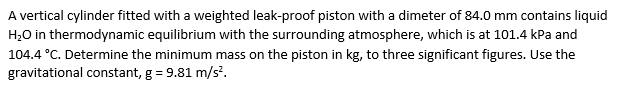

I keep getting this question wrong, and I am struggling to understand why this is.
F = p*A
Ap = π*r2
Denoting patm as atmospheric force, and p0 as pressure inside the cylinder.
Firstly, a force balance on the system. Force UP = Force DOWN.
p0*Ap = m*g + patm*Ap
patm = 101.4 kPa , and at 104.4°C p0 is equal to a pressure between 110 kPa (at 102.3°C) and 120 kPa (at 104.8°C).
By interpolation p0 is equal to 118.4 kPa.
Rearranging the force balance, m = ((p0-patm)*Ap)/g = ((118.4-101.4)*(π*(0.042)2)/9.81 = 0.00960 kg.
This seems like a VERY unrealistic situation considering this very small mass is creating 17 kN/m2 of force..
Any help would be appreciated.
I think I realized my mistake, I need to times my mass by 1000 due to using kN/m2 = kPa I should be finding mass with N/m2.
Edit still wrong...

The area of a circle is πD2/4, not πD2.
Chet
Sorry Chester, I changed the 84mm diameter into 0.042m radius when I put it into the formula.
It seems my working is correct, except the quiz I'm doing is playing up. Which is really confident battering :/

Sorry, my mistake. I rechecked your calculation, and it looks correct. But the requirement of 3 significant figures is an issue. If you interpolate in your pressure table, you get 118.4. But if I interpolate in my pressure table, I get 117.9; and if I interpolate in my temperature table, I get 118.0. (I did these interpolations using semi-log interpolation). So the pressure difference can be anywhere from 17 to 16.5.

As always, appreciate your help Chester. In the end it worked out to be correct!
