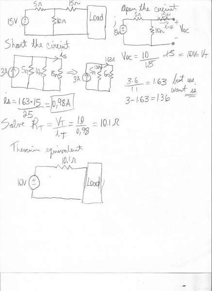

See Figure
See figure.
Did I do this right?
I just want to make sure I'm understanding things correctly.

No. You calculated the wrong value for I-thevenin (and thus for R-th as well). I'm not following what you're doing to find it, so I can't pinpoint the mistake. I will say though, from my own experience, current sources trick people up often. I'd stick with the voltage source and just write a 2 loop mesh analysis with I2 being Ith.
By the way, in a simple circuit like this one with no dependent sources, you can short all sources and just find the equivalent resistance between the two points in question to find Rth.

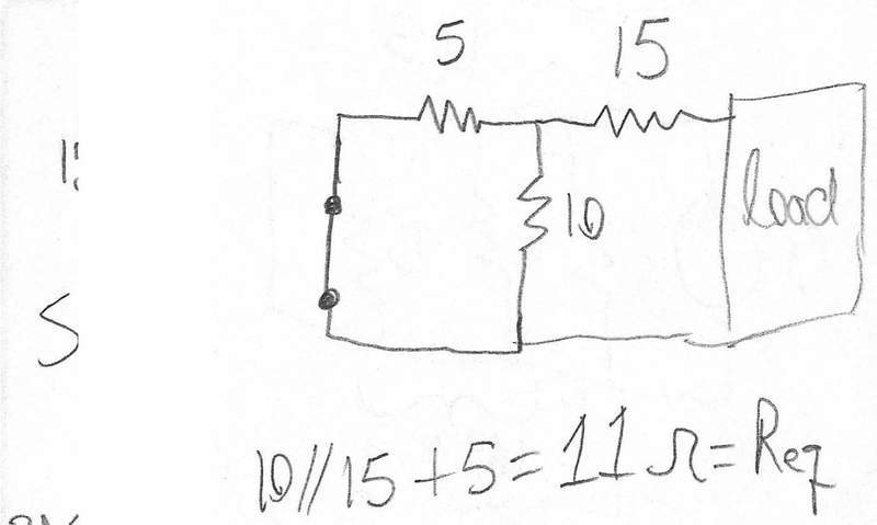

jegues said:
Is this what you mean?
Yes, except you're not calculating the equivalent resistance correctly. That 15 ohm resistor only has 1 node in common with the 10 ohm resistor, so there is no way you can say they are parallel. Any parallel components share two nodes with each other whereas any series components share 1 node with each other.
What am I doing wrong?
Sorry if your help seems somewhat "hopeless" but I am indeed trying to understand this.
EDIT: Doh, 5//10 + 15 = 18.3,
Now the only part I have left to learn is the mesh analysis. If you don't have time to explain, I'll try googling and see what I can come up with.
Thanks again!

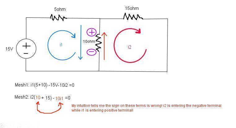

These seems to work flawlessly and is very easy to follow. However, the confusion that remains is the confusion within my intution. I've drawn a picture to show you where I've become confused.
I think you may have explained this in your post, but it's still not clear to me how the signs on the 10ohm resistors(I put it in red in the 2nd mesh analysis) are not interchanged.
Other than that everything makes sense!
Thanks in advance!

On the top of the resistor, we can do a KCL, which states that the sum of the current entering and leaving the node equals zero, i.e. we did not create or destroy current/charge. So we will say the current in that branch is going from top to bottom.
We have I1 entering it (going clockwise) and I2 leaving it (going clockwise), and since we defined the current as going from up to down, we have some unknown current I_down leaving it. So we can KCL these:
I_down + I2 = I1
again, this is current leaving = current coming in.
Solving for this I_down, we get I_down = I1 - I2.
So what is the current going up then? We just need to multiply I_down by (-1) to get I_up. I_up = -I_down = -(I1 - I2) = I2 - I1
So when you write the second loop, you redefine the direction of the current as going up the branch, and you are still, therefore, entering the + node of the resistor.
If you really wanted to, you could keep I_down and then write -Idown * R_shared for the second loop. But... this would be -I_down = I_up = -(I1 - I2) = I2 - I1 . It's the same thing!
When did we do this? Was this implicit when I labeled the polarities of my 10 ohm resistor?
This is where I always get confused between polarities and direction of current.
Resistors don't have polarities. Voltages have polarities and currents have directions. Your figure and equations look okay to me. With mesh analysis, you just pick the loop current directions (usually clockwise as you have used), and write out the KVL equations.
