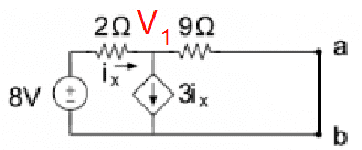

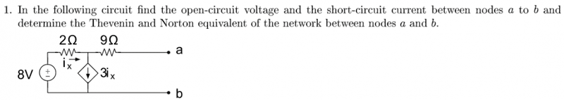

I am trying to find the Voc, but this circuit isn't making sense to me. So to start we can ignore the 9ohm resistor and that branch for now when Finding Voc so you are basically left with the square circuit on the left and I labeled my ground in the bottom right of that square. Now to find the Voc I have to find the voltage across the 3ix current source, but I am not sure how. How can I apply KVL or KCL to the loop if I don't know the resistance or voltage of the current source? And if you do KCL at the Top middle node then you get ix = 3ix which would give you 1=3 . Should I find I norton first and then I can find Rt which would just be 11ohms and then do V= InRt?
As you've noticed, if ab is open then only the one loop is involved, hence only one current.
For what possible value of ##i_x## can ##i_x = 3 i_x##? What potential at the central node will guarantee this value of current?

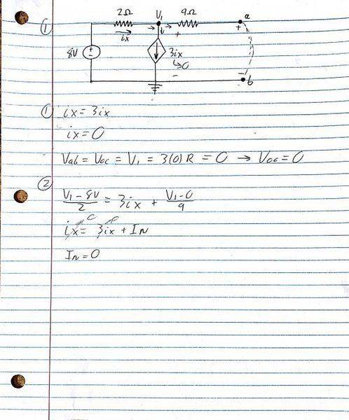

Ok so how could I show that exactly using some equations? Can I right Voc =V1 = 3(ix)R = 0. V1 is what I labeled my middle node.
Also, I am not sure how I could find my norton equivalent now. Since I have Vthevenin (0V) and Rthevenin (11ohms) can I just say Inorton = Vth/Rth = 0/11 = 0? This seems way to easy. I can get some node equations when I put a wire from a to b to find Isc but it looks like In would be 0 if you use KCL at the node. ix=3ix+In and if ix =0 then IN=0. I have never had a problem like this and it just doesn't seem right.

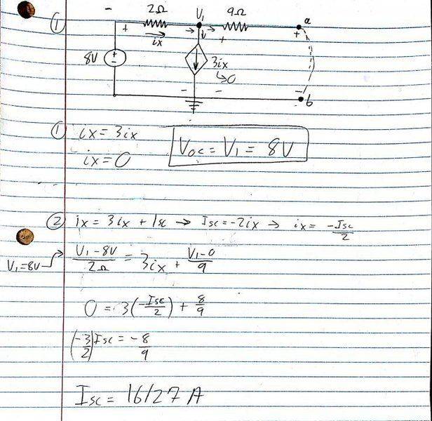

Would it not be 0? Can we use the KCL equation ix = 3ix + Isc and use the fact that ix=0 to show that In=0? Or is that not true once you put a wire from A to B. Here is what I came up with after shorting a-b. Is this correct?
No, Isc won't be zero. Once you short the output you have a new circuit, so your previous value of 8 V for V1 won't apply anymore. Analyse the new circuit from scratch. The node equation approach is convenient, but don't assume a value for V1. Instead, solve for it then obtain the short circuit current as the current through the 9 Ω resistor branch.
Hint: Identify the variable ##i_x## with the auxiliary equation ##i_x = \frac{8 - V1}{2}## in order to eliminate ##i_x## from the node equation.

Is my way from the picture wrong? Are you saying I should take the equation for ix ( the one you just wrote) and plug it into 3ix and then solve for V1? How will V1 help me find Isc?
When you write the node equation you have two unknowns: ##V1## and ##i_x##. The auxiliary equation allows you to eliminate ##i_x## and solve for ##V1##.
##I_{sc}## is the current through the 9 Ω resistor. What's the potential across it?
Alternatively you could use mesh analysis to solve for the current in the second loop. But you'll need to use a supermesh, and another auxiliary equation tying the mesh currents together with the controlled source.

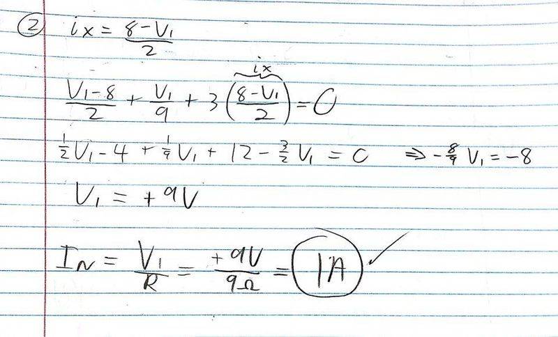

Ok so my equation would be (V1-8)/2 = 3ix + (V1-0)/9
and plugging the ix in I get a value for V1 of 144/17
Then I=V/R = (16/17)A
Check your node equation. You've got terms for currents flowing out of the node on both sides of the equation. If you're going to do it that way, one side or the other should describe a currents flowing into the node.
The best way to write a node equation consistently is to write a sum that equals zero. Choose either all currents flowing into the node or all currents flowing out. Then write all the terms on one side of the equation and set it equal to zero. So in this case if we assume that all currents are flowing out of the node:
$$\frac{V_1 -8}{2} + \frac{V_1}{9} + 3 \left(\frac{8 - V_1}{2} \right) = 0$$
