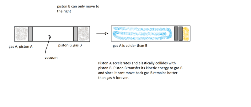

  • #31
Let's assume that TA=TB
Piston A will be pushed back into the vacuum.
Let's assume that the second piston (gas B) is held to prevent it from doing the same thing as piston A.
Now if piston A moves forward.
When piston A reaches piston B, the temperature of A has changed, so TA<TB, because gas A has expanded (it now occupies a larger volume).
So the pressure of piston B will prevent piston A from advancing and so piston B will not be pushed back, but on the contrary piston B will push piston A back on contact when piston B is released.

That is specified by the Clausius inequality. The entropy generated by a process in a closed system is positive or zero.

@aliinuur A statement of the 2nd law relevant in your case is this: https://en.wikipedia.org/wiki/Second_law_of_thermodynamics#Clausius_statement
Heat can never pass from a colder to a warmer body without some other change, connected therewith, occurring at the same time.
Here the crucial part is "without some other change ...". In your example there is also some other change involved, so your example does not violate the 2nd law as stated above.

Just to expand a bit: The other thing that changes is that the potential energy that's stored in the device due to the pressure difference between gas A and vacuum is used up when gas A is allowed to expand.
Actually it's not even clear that any heat is transferred between the gases in the process. The expansion of A and the compression of B could both be adiabatic.

I'd really like to see some more details from the OP.
For example, why is gas A loosing heat and where is there a transport of heat in this process?

heat of gas A goes to kinetic energy of the piston A, heat transfered via pistons, but there is no external work or something like that
  • #48
Gas A is not necessarily giving off any heat. If the expansion is adiabatic then Q = 0, for example. However the temperature decreases!
If the expansion is somewhere between adiabatic and isothermal then heat actually flows into gas A. Even so gas A would get colder.
If the expansion is isothermal then heat flows into gas A to balance the work done during expansion and the temperature is constant.
You could find an expansion where heat leaves the gas, but that would have to be steeper than an adiabatic curve in a PV-diagram.
Maybe this helps: For an ideal gas inner energy is proportional to temperature. So if the temperature of gas A drops this just means some of its inner energy has been used to do expansion work. It doesn't necessarily mean there was a flow of heat.
Concerning work that's put in: Some work was obviously needed to get the device into the state shown on the left.

I've tried to simplify the problem, hopefully retaining its essence, and do an analysis, but I ran into some difficulties. Maybe someone can tell me how to proceed.
If I have a closed cylinder as in the sketch but only 1 piston between gas A and gas B, so no vacuum, then I don't need to think about collisions between pistons.
Initially I have the following situation:
Gas A occupies 1/3 of the cylinder on the left, gas B occupies 2/3 on the right and they are separated by a piston. The number of moles (n) is the same for both and remains constant.
For the starting values of volume, pressure and temperature we have:
VB = 2 VA
PA = 2 PB
TA = TB = T
There is no heat transfer between a gas and anything else (piston, cylinder or the other gas).
The piston is extremely heavy so that expansion and compression will be quasi-static.
If I release the piston gas A will expand very slowly and gas B will be compressed. The sum of volumes is constant.
This process should stop when the pressures of gas A and B are the same.
Gas A will have cooled off and gas B will have heated up.
Here's my problem:
If I treat the expansion of A and the compression of B as reversible adiabatic, then the whole process will be reversible since nothing happens in the surroundings.
(I checked that analytically, just to be sure, and if I use expressions for reversible adiabatic processes ( P Vγ = constant, for example), I get ΔS = 0 for both gases (with some rounding errors).
