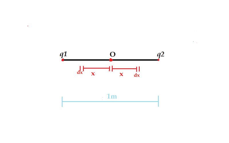

It should be ∫√2x/√(1−2x)dx=∫3 dt.
  • #32
Yes. So what is t then?
ehild
  • #33
ehild
LHS is 0.785398 and RHS is 3t
So I got t=0.2619sec but the answer is 0.74second.
Is the answer correct?
  • #34
I think your solution is correct.
ehild
  • #35
I am also getting ##\frac{\pi}{12} sec## as the answer .

  • #37
Yes, it can be. The electric field is also a central force, like gravity.
The two-body problem can be reduced by a single-body problem with the reduced mass method. The problem is equivalent if we consider a virtual body of reduced mass (μ=1/(1/m1 + 1/m2) about the centre of the force, where the distance from the centre is equal to the distance between the bodies in the original problem.
The straight line can be considered as a very elongated ellipse. At the limit, the focal point is at the opposite end of the distorted ellipse.
Kepler's third law states that the time period depends only on the average distance from the central body, on the semi-mayor axis.
You can determine what would be the period of a circular orbit with the radius as the semi-mayor axis.
ehild

  • #42

Yes.
Satvik Pandey said:
But what is the magnitude and direction of force which acts on the reduced mass.Is magnitude of force acting on reduced mass is equal to the force acting on any individual particle.
Yes. Note that the force is interaction between the real particles. The force the imaginary particle "feels" is equal to that force of interaction, but as if it was exerted by a centre of force in the origin.
Satvik Pandey said:
And if the direction of force on particle is towards the CM of system then the direction of force on reduced mass is towards the center of force.Am I right.
If the force of interaction acts along the line connecting the real particles, then it is also towards to or away from the CM of the two-body system.
The imaginary particle also feels central force, acting along the line connecting the particle and the centre (origin)
ehild
