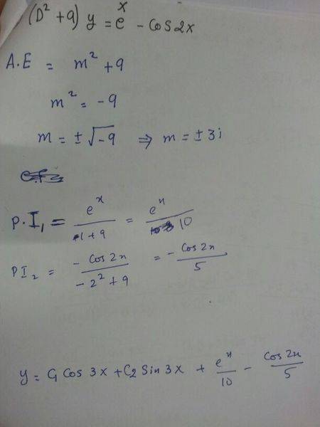

Hi
here is question with answer
please can help me from where we got
1 + 9
and
-2+9
help me please

What is \displaystyle \ \ \left(\text{D}^2+9\right)\left(Ae^x\right)\ ?
What is \displaystyle \ \ \left(\text{D}^2+9\right)\left(B\cos(2x)\right)\ ?
